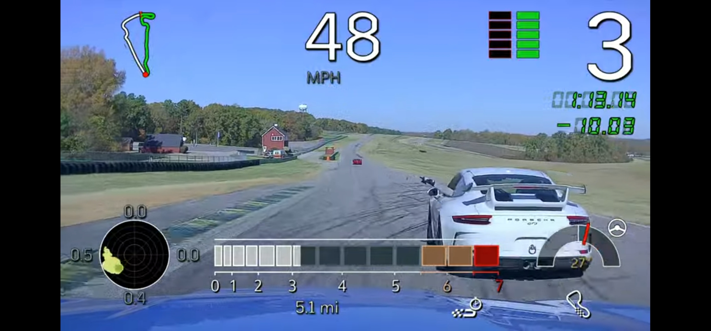

Here's a video of me keeping up with a 991 GT3. Granted, I had more track time at VIR which gave me an edge, but still pretty impressive for a 4100 lb sedan.
If it were 500 lbs lighter it would be a C7 Z06 :) The 5BW really is an incredible machine, but it isn't my primary track car. Lightning lap uses the Grand Course which really mutes the power advantage and also favors lighter more nimble cars.
