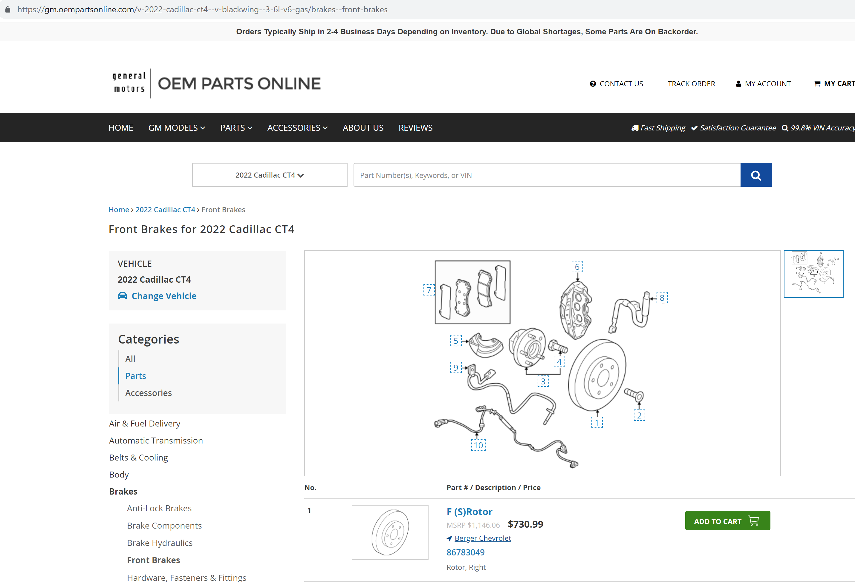

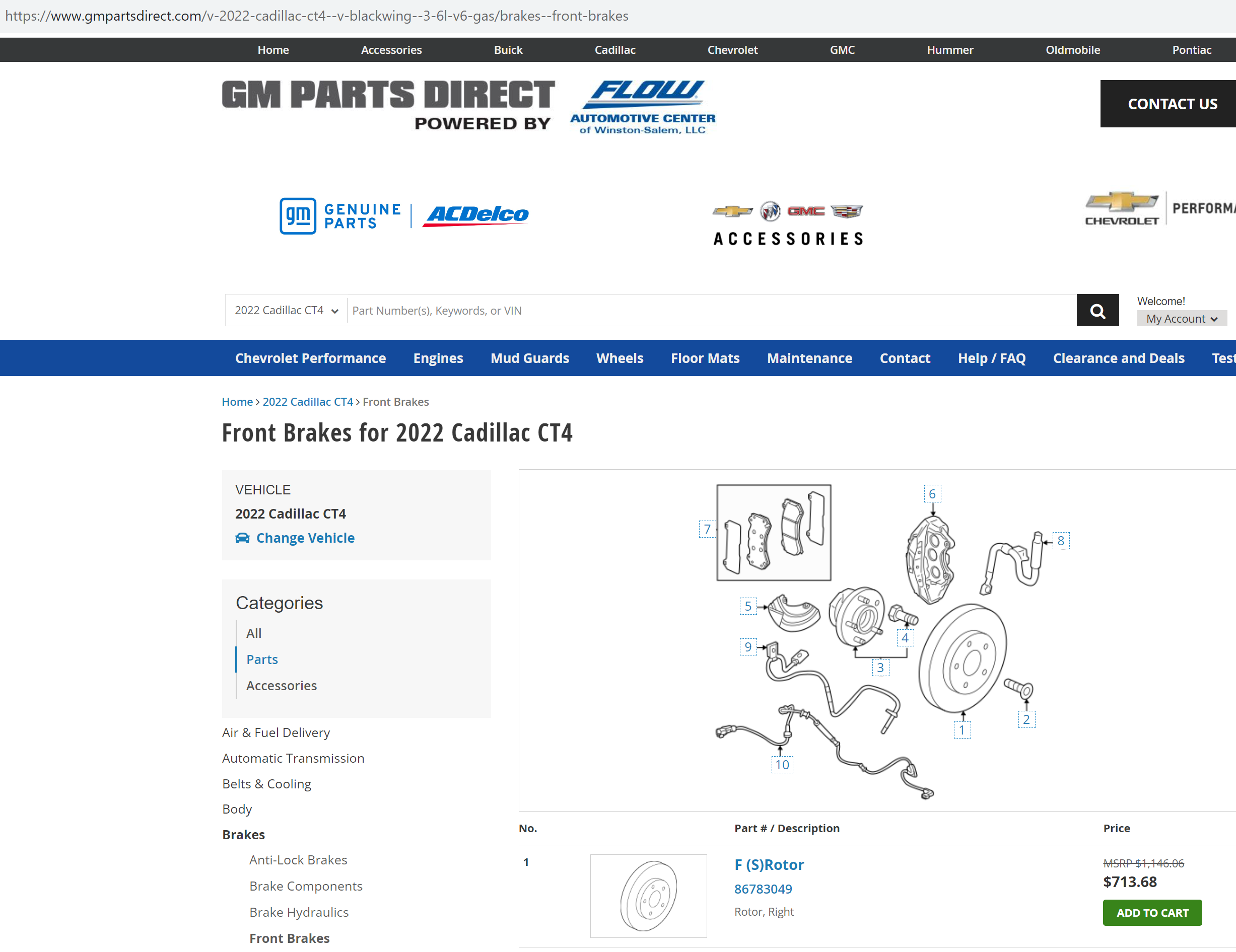

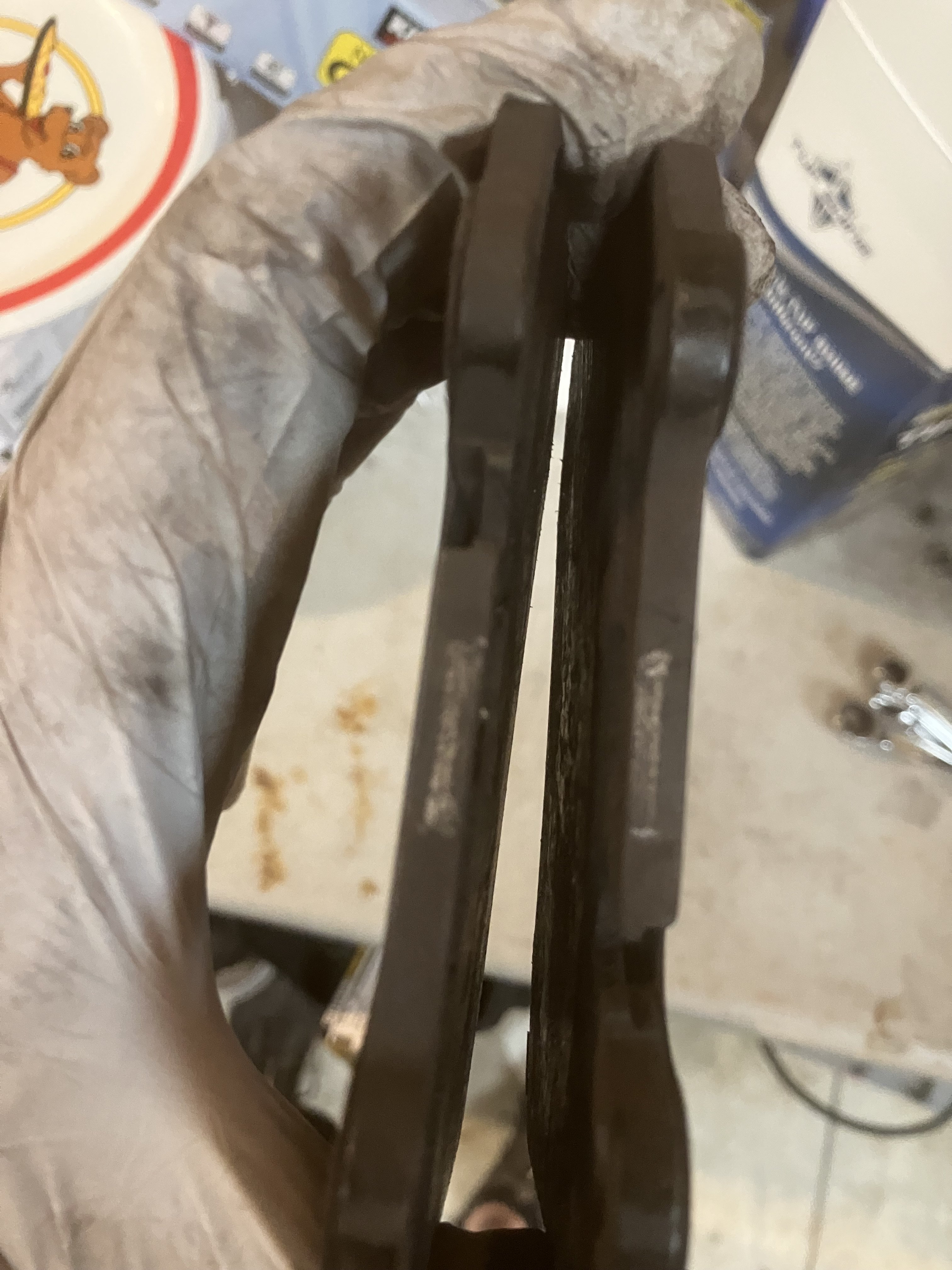

Even if I pay $100 in shipping that brings my parts cost down to $1775, reducing my total by over $900
Thoughts?
I think you are correct on the online parts cost. You can get Front rotors (Left and Right) with shipping for around $1500 and the front pad kit (Left, Right, and cables) for $350.
Then Sign up for Online Service Manual access and download the install instructions for Brake Pad and Rotor install procedures. Then get a local car repair shop to install instead of a GM Dealer. Out the door for all should be around $2100. That is about $1000 less than what you are getting quoted from a GM dealer.
I am going to double check regarding the front brake pad kit info with my local dealer. I think the kit provides both left and right side pads (4 pads total) plus the cables - #85528936
Rockauto did have the fronts in stock earlier in the summer at $500-600ea. Looks like they only have 1 side in stock right now, but still at the same price. Perhaps they'll have more in stock by the time you need them.
