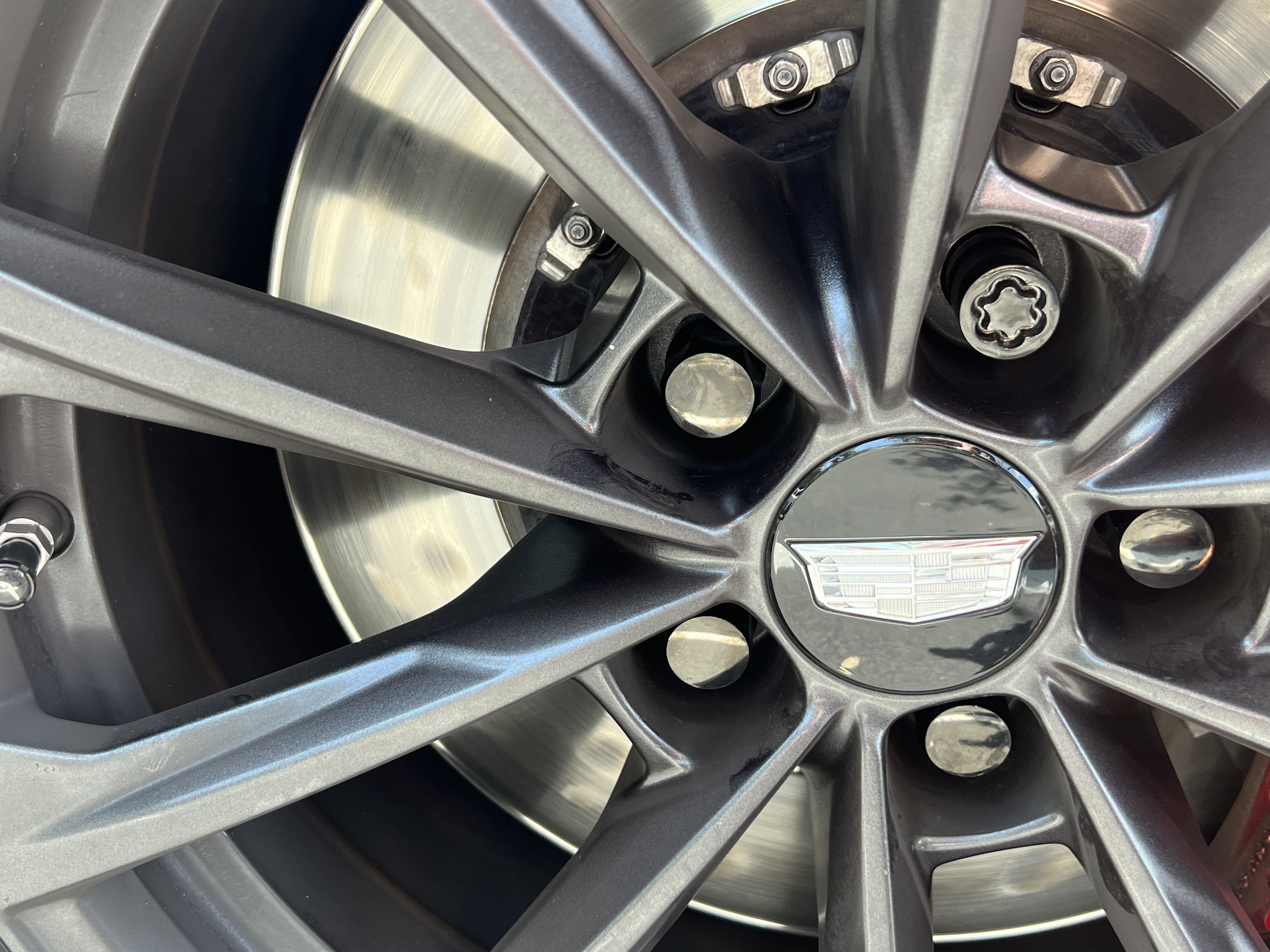

Can I get your opinions on my front rotors

Dealership says front pads and rotors need replacement to the tune of $3300……….

Those rotors look like they have some hotspots. Typically you should be able to have the rotors resurfaced at least once along with a new fresh set of pads and then they're done.

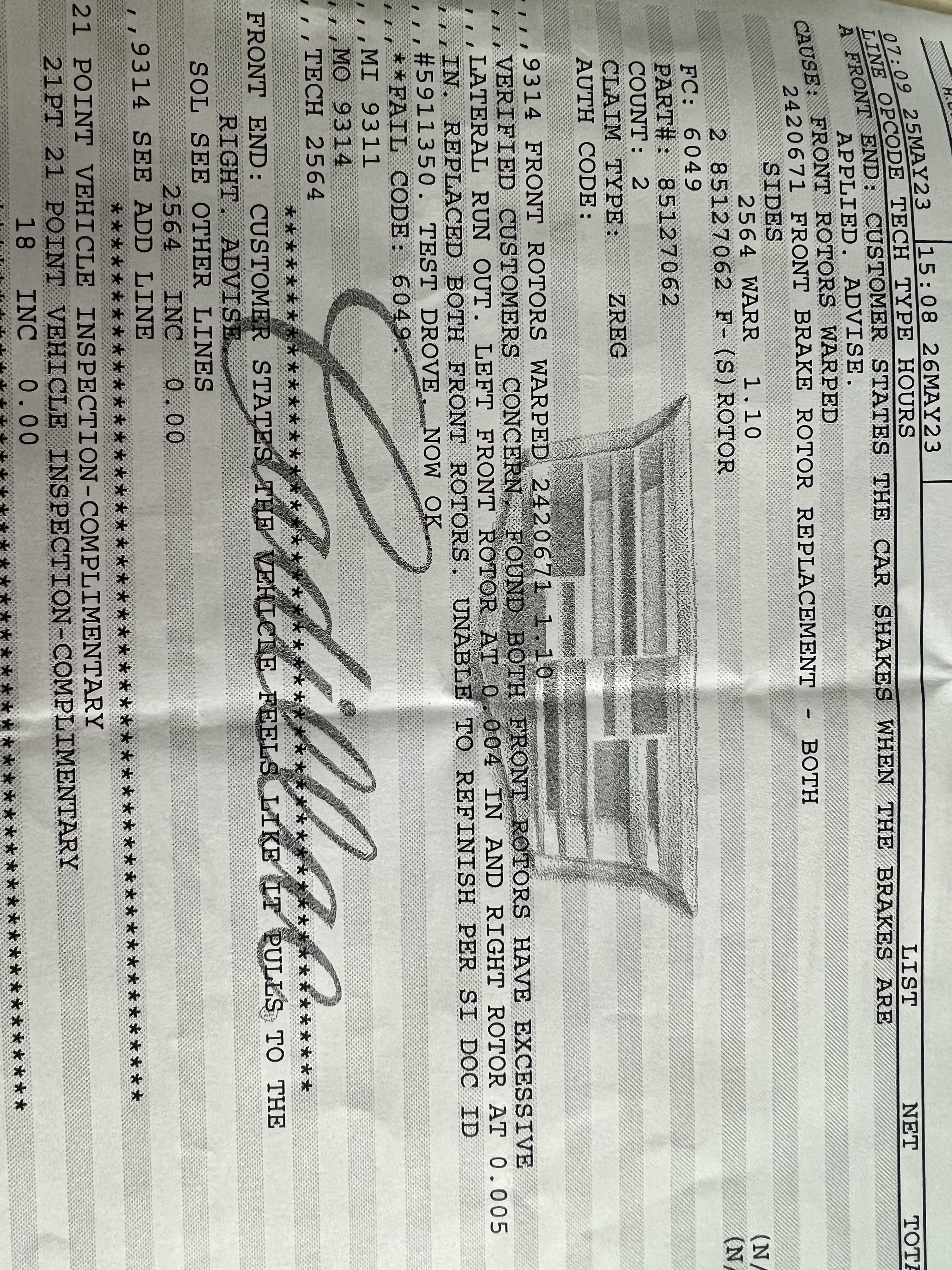

My 5bw was vibrating called dealer May 1 for appt with loaner car. Appt was May 26 they put new rotors & pads on. Mileage was 9k

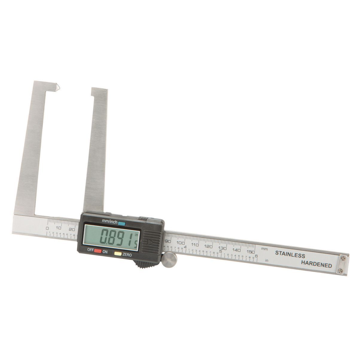

The rotor edge lip is normal, at least it is on German cars. The pad rides up against the lip. You have to measure rotor thickness with a micrometer with the hooks on the end to go around the lip. A few measurements should be taken around the rotor and typically the min and max thickness should be imprinted on the rotor hat.
If the pads have at least 5mm left it might be worth it to resurface the rotors and bed the existing pads in to get more miles out of them.
Those high spots on the rotors could just be excess pad material that built up which you could also just try bedding the pads in and seeing if that alleviates the issues, but I would only do that if there is a good amount of pad life left.

I went to the dealership for an oil change and asked them to check my brake pads because they are squealing (which appears to be somewhat normal for these cars). I’m not really having brake issues, which is a large reason I’m suspicious of their claims.
I had front rotors with pad deposits that looked like yours for a few weeks. Initially I was concerned but I wasn’t experiencing any significant pulsing or vibrations so I checked the pad and rotor thicknesses and took it to a trackday. Problem solved. As long as your rotors and pads are not too thin, try bedding procedure. Or better yet, go to the track. I’m wondering if wheel cleaner products have anything to do with this.

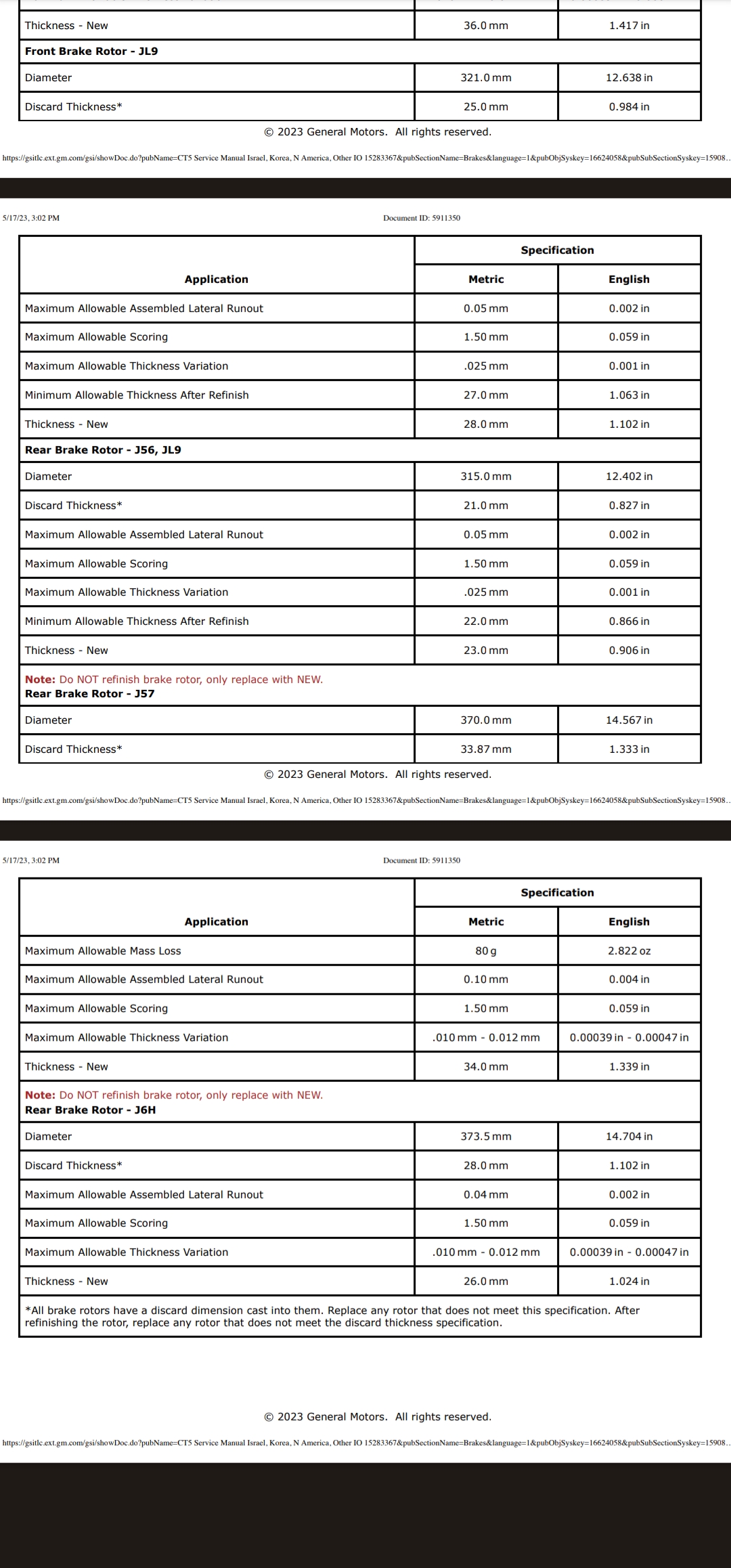

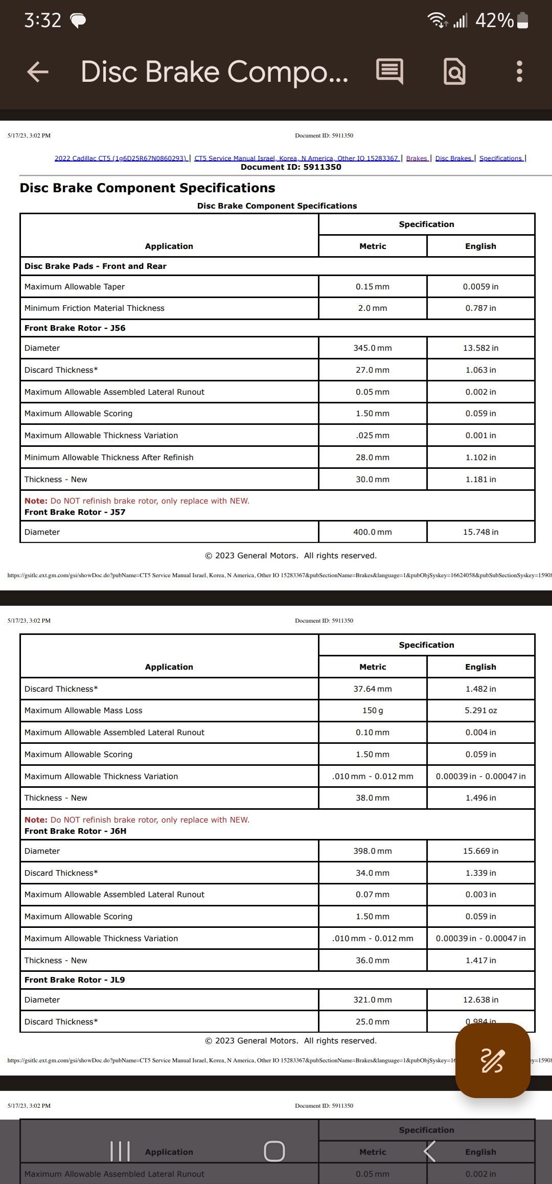

I recently participated in a Cadillac V-Club Tech talk. It is my recollection that Brembo stated that, "Cadillac Blackwing Metal Rotors should NOT be resurfaced, they must be replaced". I will hunt for that information.
If they expect us to not resurface otherwise perfectly good rotors that only have an uneven layer of pad deposit they could at least give us a ring only option rather than a whole rotor/hat assembly. I can’t wait until Girodisc or DBA gets a front rotor to market

FWIW I usually replace rotors or do a heavy bed in procedure in lieu of refinish/resurface. I suspect it recommends replacement because these braking systems are track capable. Resurfaced rotors put alot of heat on the steel face of the rotor and they are then more prone to symptoms associated with a warped rotor when tracked.
Mother of God your right, attached is the service manual disc brake specs
