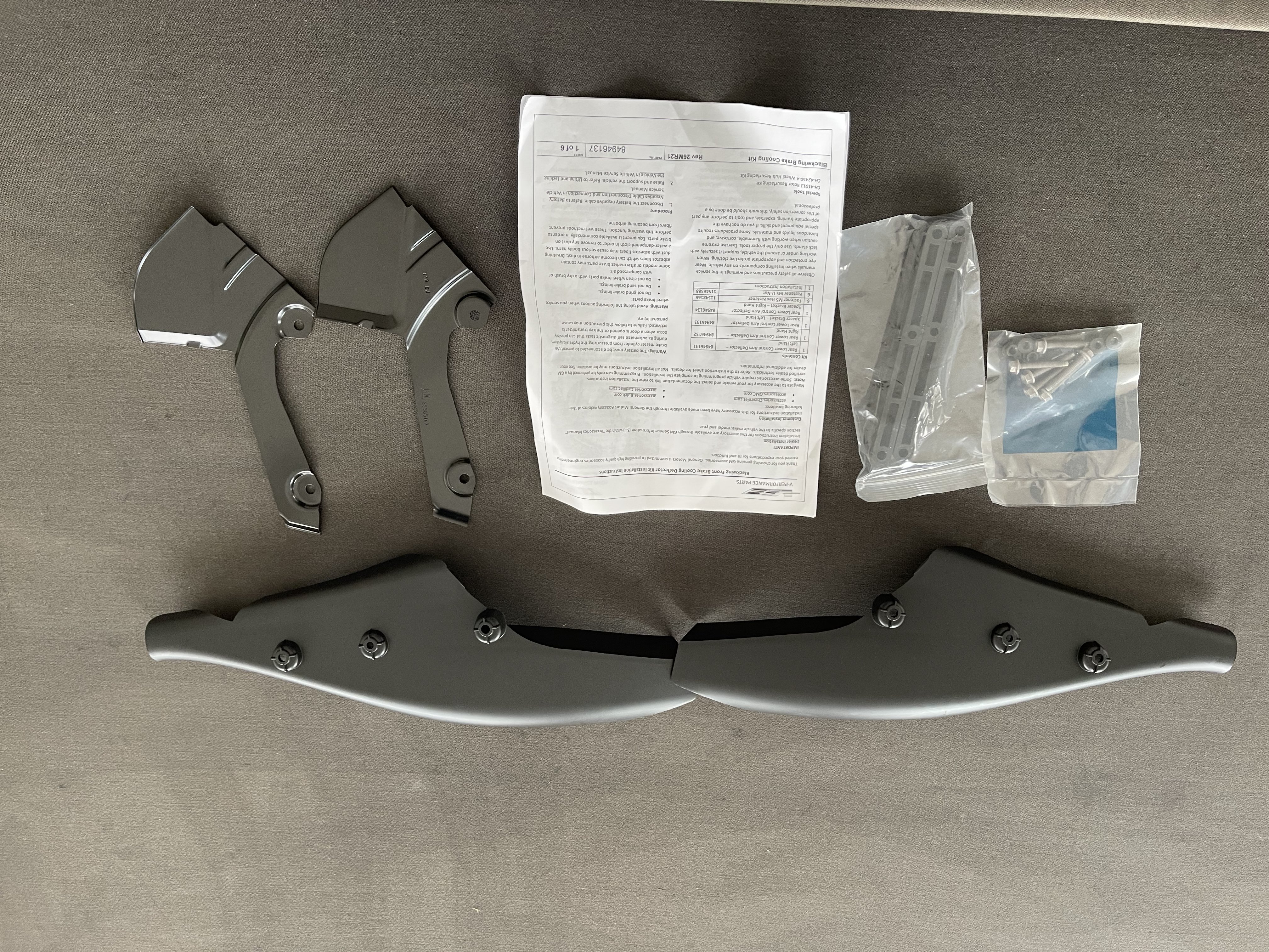

Here’s what I have. Are you telling me that this was supposed to have been installed during PDI and that I’m missing the kit for the rear?

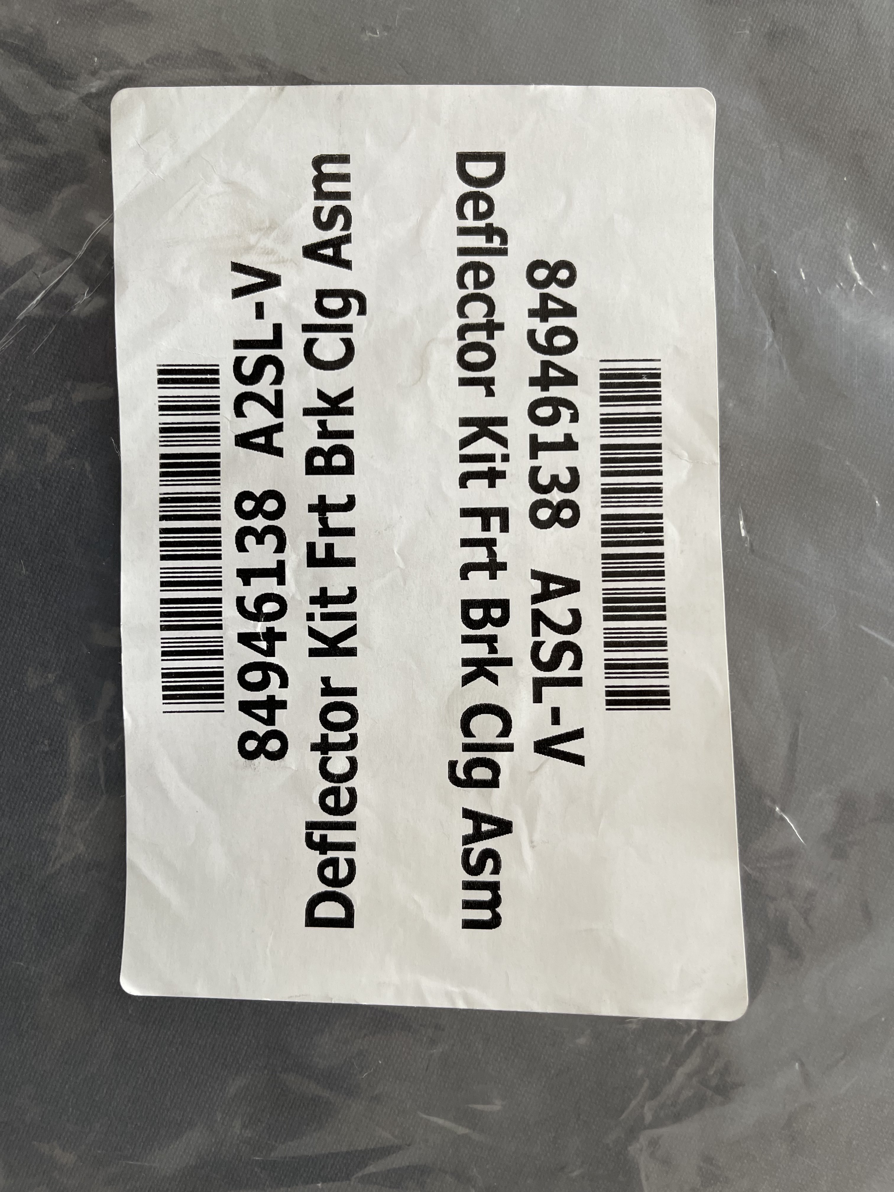

You're good. Same parts were in my trunk when I picked it up today, but mine were in a bag labeled "DEFLECTOR KIT-FRT". I think they just grabbed a random bag to throw the stuff in.
What you have is the replacement shields for the front and the deflectors for the rear control arms, with the two spacers, bolts, and nuts. All are only needed for track use.

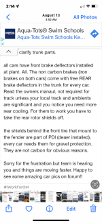

This is labeled wrong Should only read rear not front and rear as the fronts are put on at factory Yes?
No, for CT4 (don't know about CT5).
The "Care Package" includes parts for both Front & Rear.
Yes, the Front Ducts are factory installed, but new smaller Front Backing Plates are provided, to get more air to Front Rotors. (replaces original large Front Backing Plates)
Rear Deflectors are also provided, but their use requires complete removal of original Rear Backing Plates.
Hence, both are for Track Use only.
