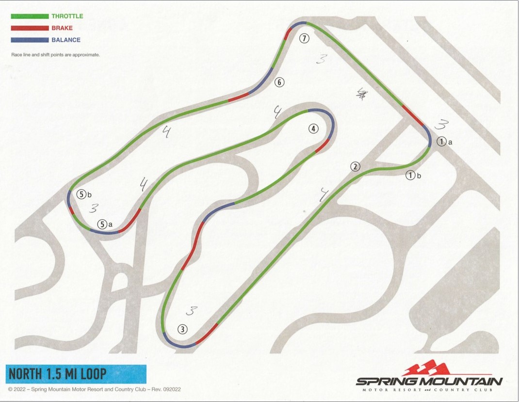

They'll have a course map showing where the braking should happen and what gears to use. The hand numbering on my attachment is gears for manual. They also put on the presentation board the gears for auto which use more gears. As others said, you're usually only using 3rd and 4th for manual, and you aren't shifting frequently. For my course, they specifically said not to use 2nd.
They have cones marking the start of the braking for each turn. For me, not having been on a track before either, was a gut check keeping the throttle floored all the way to the braking cone. Going into turn 3 is over 100 mph, and it's almost a 180. I don't think I ever got all the way to the cone before letting up, but I did get at least to 105 mph or so. The car really hooks and holds in those turns though, and I pulled over 1.1 G's I think on my best turn. Trust the car and your instructor. He/she is coaching you all the way.
