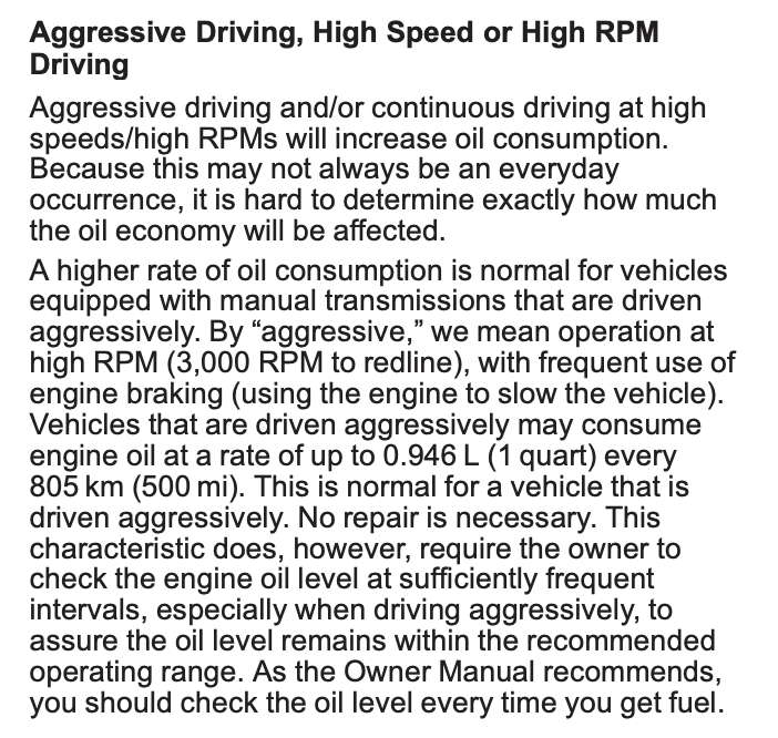

Hey, for those that change their own oil I am curious if you noticed any oil consumption between oil changes? I did my first oil change at 1,000 miles and then another at 2,500 miles, or 50% on the oil meter. I just did another change at 4500 miles, 40% on the oil meter and I noticed I was about a quart or so low. I saw a TSB that discusses what is considered normal or not. Just curious what others have experienced. See the TSB link and a snippet on aggressive driving. I have a M6 and keep rev match on but I don't track the car at all.

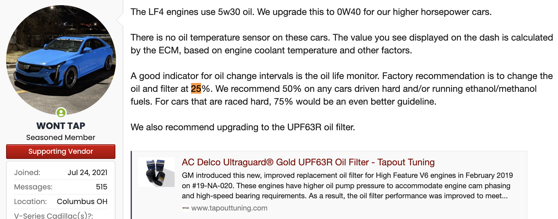

Furthermore, if you research these LF4 V6 engines, it is recommended to change the oil a little sooner than waiting for 25% on the oil monitor. Nice guidance here from @WONT TAP

My main concern was oil consumption. Losing a quart over 2000 miles and 9 months may not be too bad based on that TSB I linked and considering I don't drive much, shorter trips, manual transmission with rev match and I don't baby it. Maybe it is excessive because the engine is still breaking in? The TSB says to wait until the engine has at least 4000 miles before measuring oil consumption anyway. I will start tracking it at each fuel fill up and see if I notice anything.
