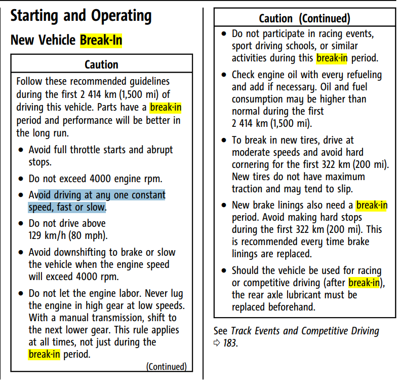

PSA on your PSA...people get confused with the 500 mile tach redline change thinking that is the break-in period, when it is actually 1500 miles as stated in the owners manual.
Yup, 500 for the engine and other things. Then 1500 for the diff from what I’ve read for years. Pretty much the same to similar on most GM performance cars IIRC.
You don’t have to be as cautious with the RPM limit after 500, they just don’t want you racing or doing events until 1500 and differential fluid change before hand.
Nope. See, you missed it. 1500 includes the engine. I see no mention of 500 miles.
I don't think he missed it, I think he is just saying in his opinion it's not as necessary to adhere to the 4k RPM limit after 500 miles, as long as you aren't bring it to the track and bouncing off rev limiter. I plan after 500 miles to do a full RPM pull every once in a while, if the engine is completely warmed up.
What the last post said. I know it’s different engines than the LT4/LT6, but everything I’ve read and GM people I’ve talked to is 500 for engine, then 1500 no race etc for diff and or transmission sometimes.
I know break in threads turn into oil threads and everyone has an opinion. This is the best info I’ve gotten for years and followed it and never had a problem. My opinion is engines usually fail because of bad parts/manufacturing error. In the end, I doubt it matters how you break it in or if one does the break in oil change or not. Now the diff is a different story, again my opinion.
Any way, it certainly won’t hurt anything except your patience to drive it under 4K for 1500 miles. I actually followed that pretty close and changed the oil/filter and diff fluid in case I wanted to do an event, I’d be ready.
I guess I don't get it. It is right in print above. The first box says do not exceed 4000 RPM for the first 1500 miles. ;shrug IDK how that is open to interpretation/opinion. Of course, everyone is free to do what they want.
