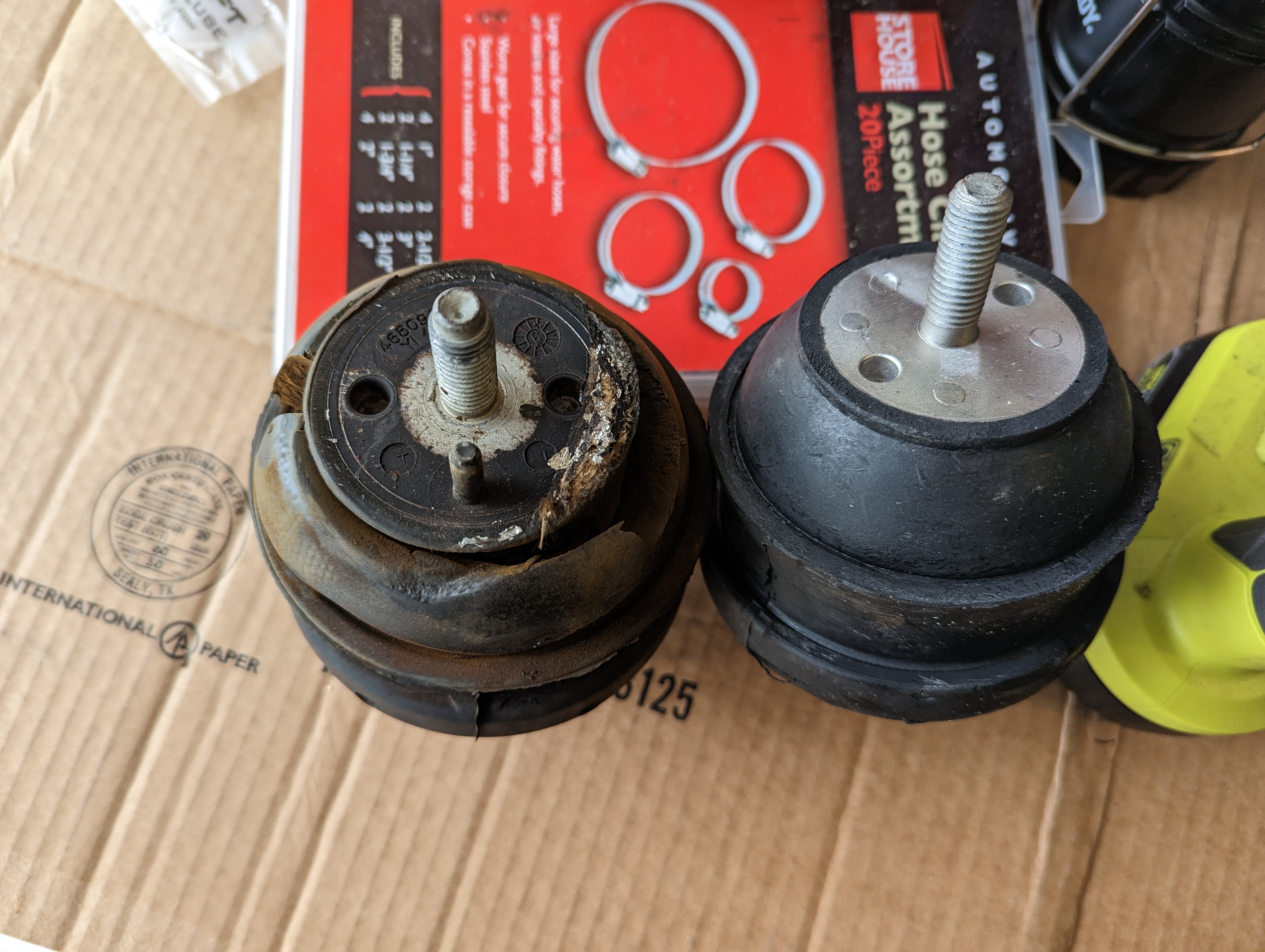

I've packed up my tools for the day but the car is still sitting in the driveway on jacks. I've got the old motor mounts out, but darn it I can't get the new ones back in.
I've got the new mounts bolted on to the top bracket and on the car but simply can't fit the bottom bracket in. No matter what way I turn or pry, they just don't fit.

I just got this car and am trying to take care of it. These mounts REALLY needed to be replaced. They were completely shot.
