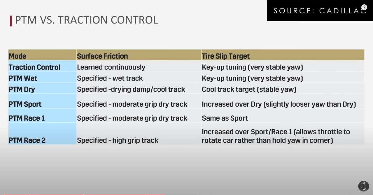

It appears that in Race 1 or Race 2, there is no stability control or traction control. The only difference between the two is "engine power" but I'm seriously doubting that they actually limit engine power, but instead they have changed the mapping (sensitivity) of the throttle. Is my assumption correct?

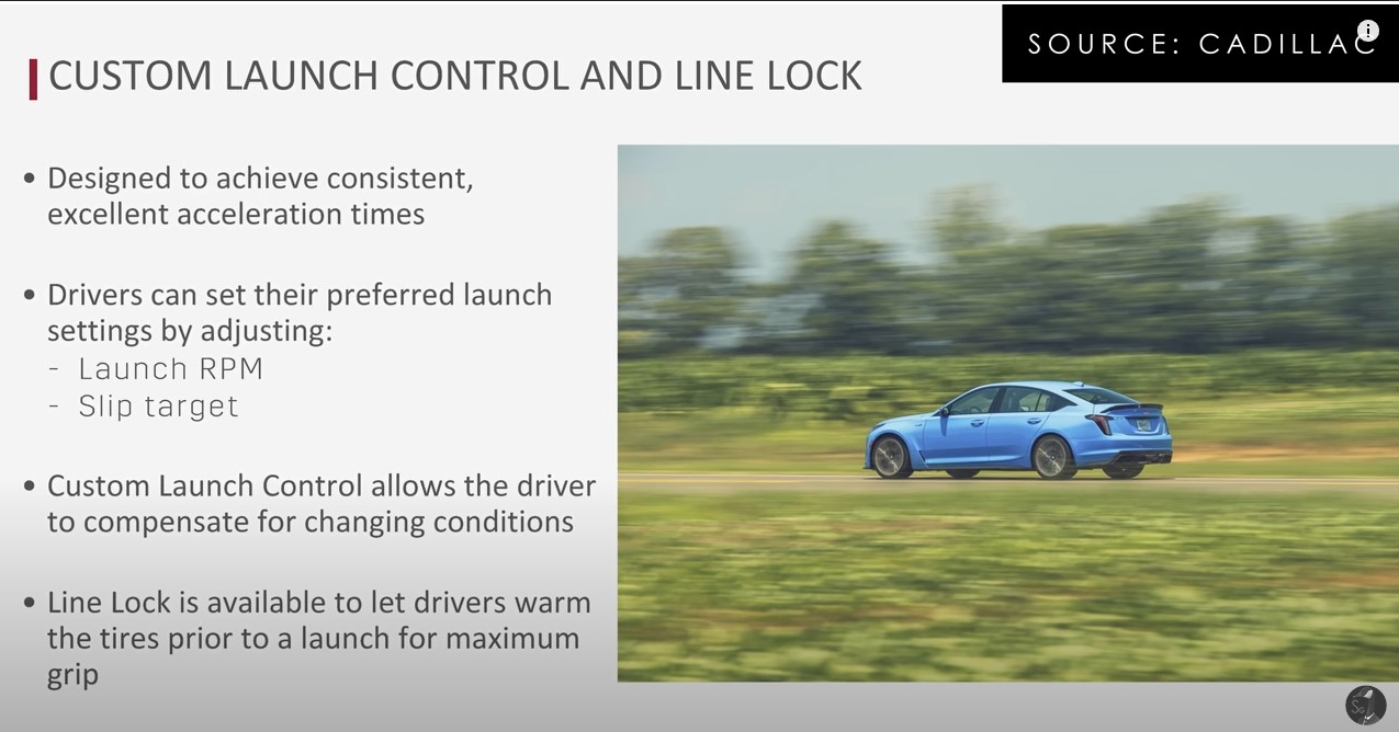

There is no launch control for the manual. On the 0-60 runs they just had us floor it in neutral and drop the clutch. Revs are limited to a set number. My notes show that traction control is still on for both, less on R2. Stability control is off for both. I wrote active handling is off for both. Those were my notes from the class and I think they are correct. I also copied these slides from a web presentation:
I think for the custom launch control you can set the launch rpm for MT, but the slip target does not apply. No line lock either.

Launch control for the manual is in PTM Sport. Once you have that engaged you can set up other launch parameters. Put the car in PTM Sport and start digging in to the V Performance menu. Or read the V Performance addendum manual.
Yes Line Lock works in the manuals
Yes you can adjust the slip target in the manuals, from 5% to 15%

The only difference between PTM Race 1 and Race 2 is in how much intervention you get to prevent wheel spin under acceleration. When there is sufficient traction, both provide the full power of the engine. In practice, I doubt any of us will notice the difference even on a track. In either mode you will have no yaw control to prevent a spin and the PTM is really designed only to limit wheel spin at full throttle.
Launch control is an available in any PTM setting including dry. You can also do this in any drive mode just by toggling the PTM selector (you don't have to be in sport or track drive mode). What I like to do is set my V mode's PTM setting to something, usually just dry or sport. Then when I engage V mode if I hit the button twice (you'll be prompted on the screen) it'll put the car into my V mode PTM setting and thereby enable launch control. Usually you hit the V button for more aggressive driving so it's convienent to have a PTM setting enabled there.
Custom launch control (where you dictate the rpm setpoint) can only be adjusted in track mode.
