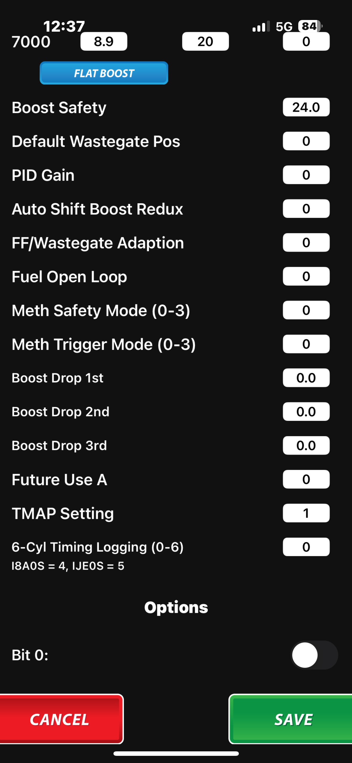

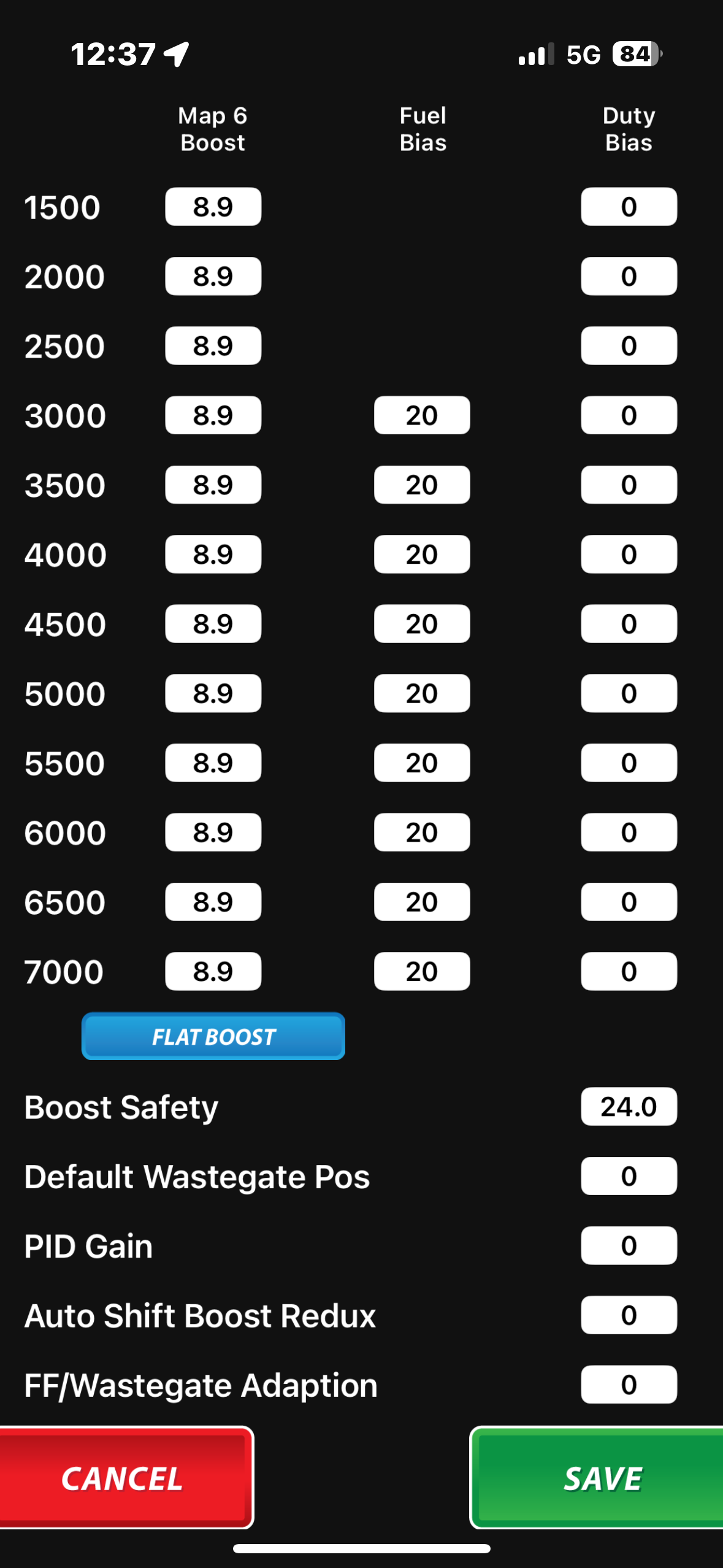

Anyone care to see if your jb4 settings look like this? I got the tuner used and want to be sure it’s set up properly.
I wouldn't run 8.9 psi of boost with 20 fuel bias. You're asking for lean AFRs, pulled timing, and misfiring.
You'll have to be running 100+ octane for something like that. If you're running 93 octane set the target no higher than 5psi or just run map 2 and get some logs. You can adjust your Fuel Bias by 5 pts up if you need more fuel.
Burger told me to change fuel bias to 20. It was set to 0. Does anyone have the stock settings? I got this used and just want to run stock map 2
You can run Map 2 as is, since the Map 6 Boost column is only used when running Map 6.
Yeah but the settings on that page carries over to stock maps. It was set to 0 and he told me to change all to 20. The logs showed the change on map2
I just want those settings back to how the jb4 comes.
Only the Fuel Bias carries over, and you have it set to 20, which is correct.
