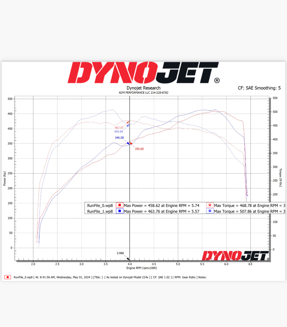

Well dyno session didn’t go all that great. They had a stored car in front of rollers so couldn’t use any fans. Should have walked but figured was only doing two pulls and car was already strapped down when I got to the back. Should have done map2 first but did map0 (stock). The fuel bias was not set correct so that may have contributed to whatever caused the power drop off.
A10 car with brisk plugs 12YS gapped to .026 / gigs throttle body / green filter.
