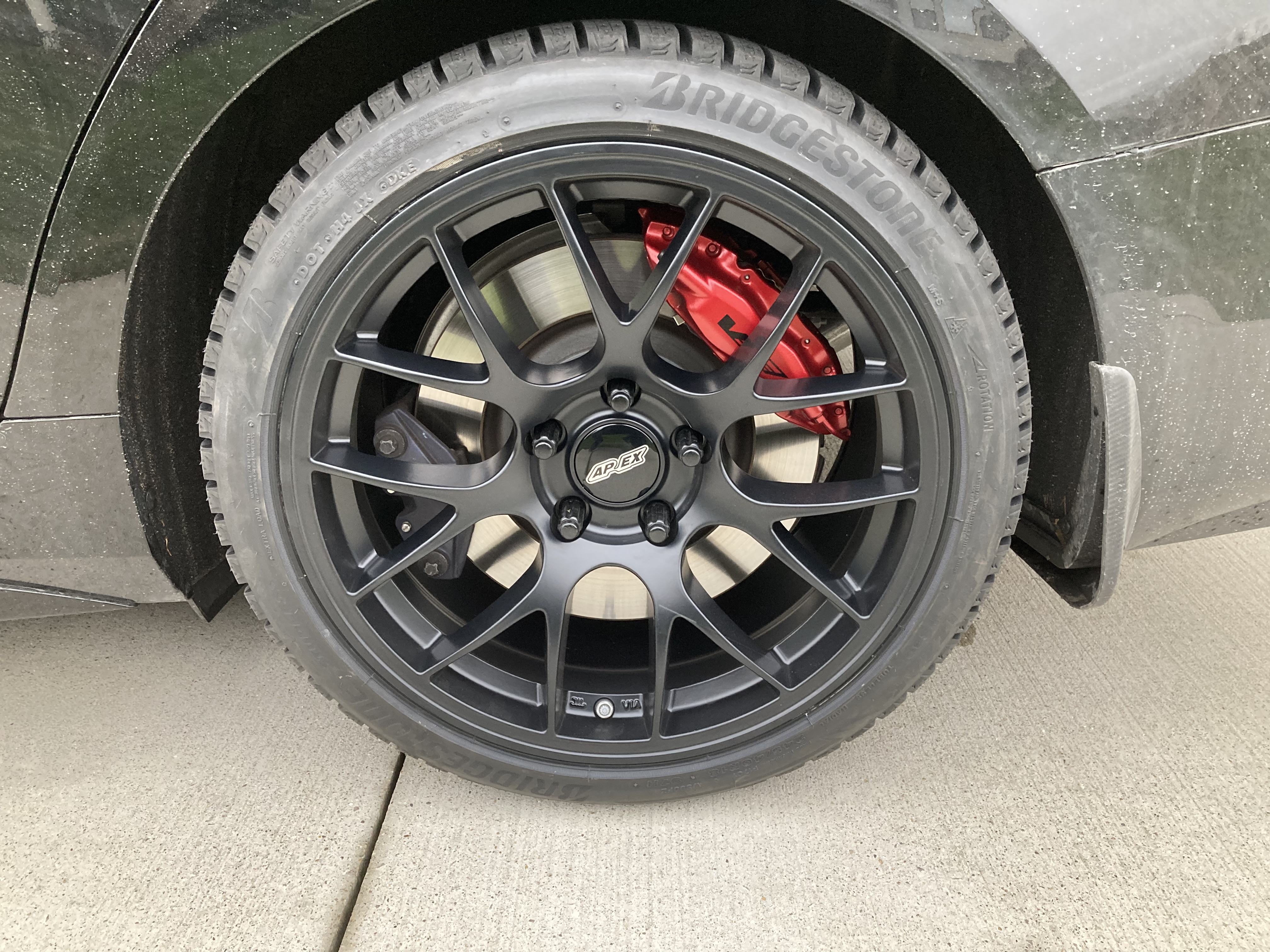

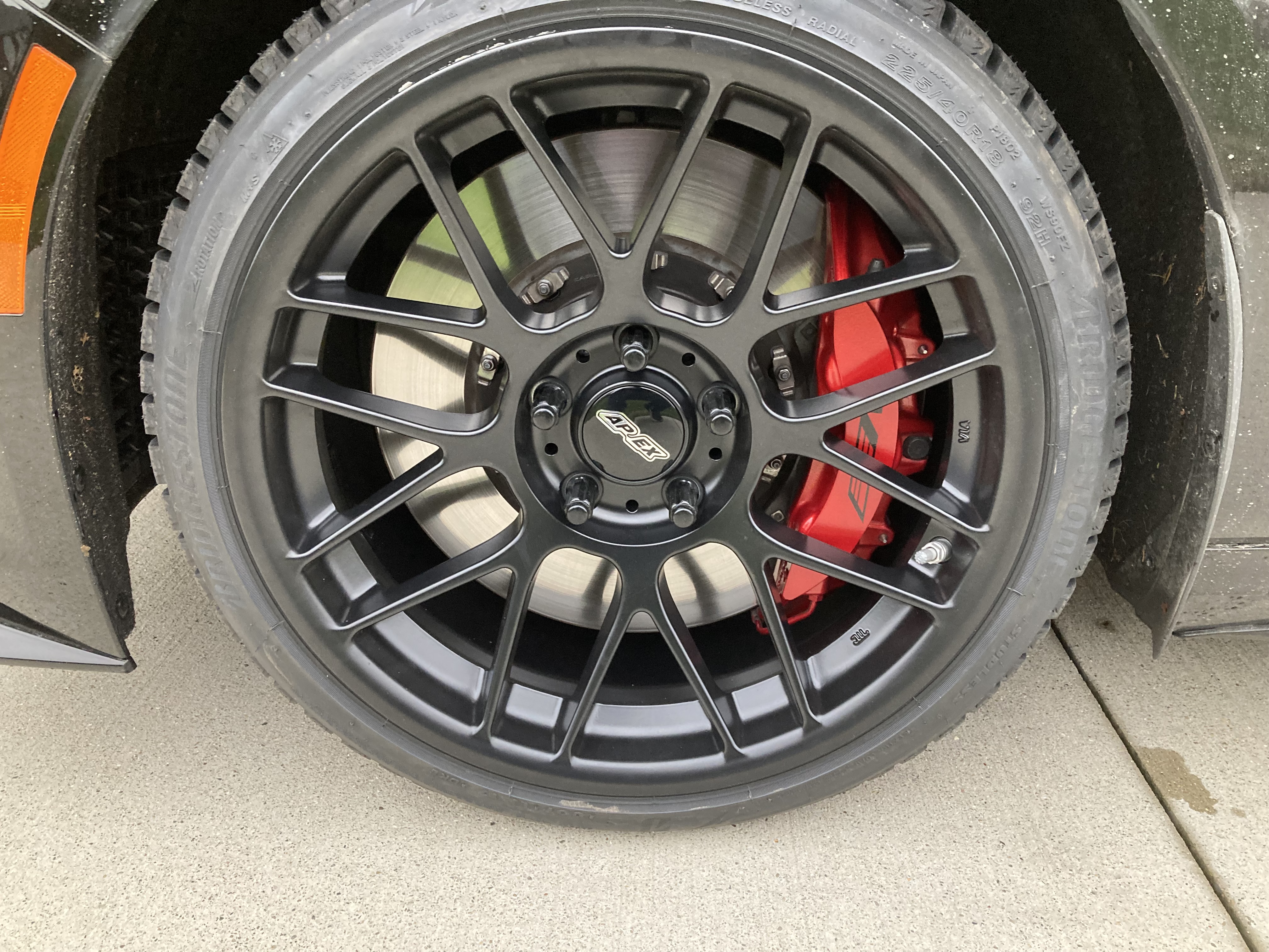

Apex wheels plus Blizzak for me and works great in Michigan! No spacers just need hub bore rings as they are BMW hub bore.
225 up front and 245 out back which is very close to factory height. I think 8 wide front and 8.5 rear.

When you say I think 8 wide, is it? What size and model APEX wheel? I was thinking of a tire size 255/35/18, wheel 18x9.5 35, or an 18x9 35 offset. Wouldn't the 40s be too tall?
Sorry looked and it’s 18x9 in front and 9.5 out back.
Rears are 43 offset EC7.
30 offset in the front Arc 8
Get the EC7 for all 4. Don’t try to make arc 8 work on all 4…
