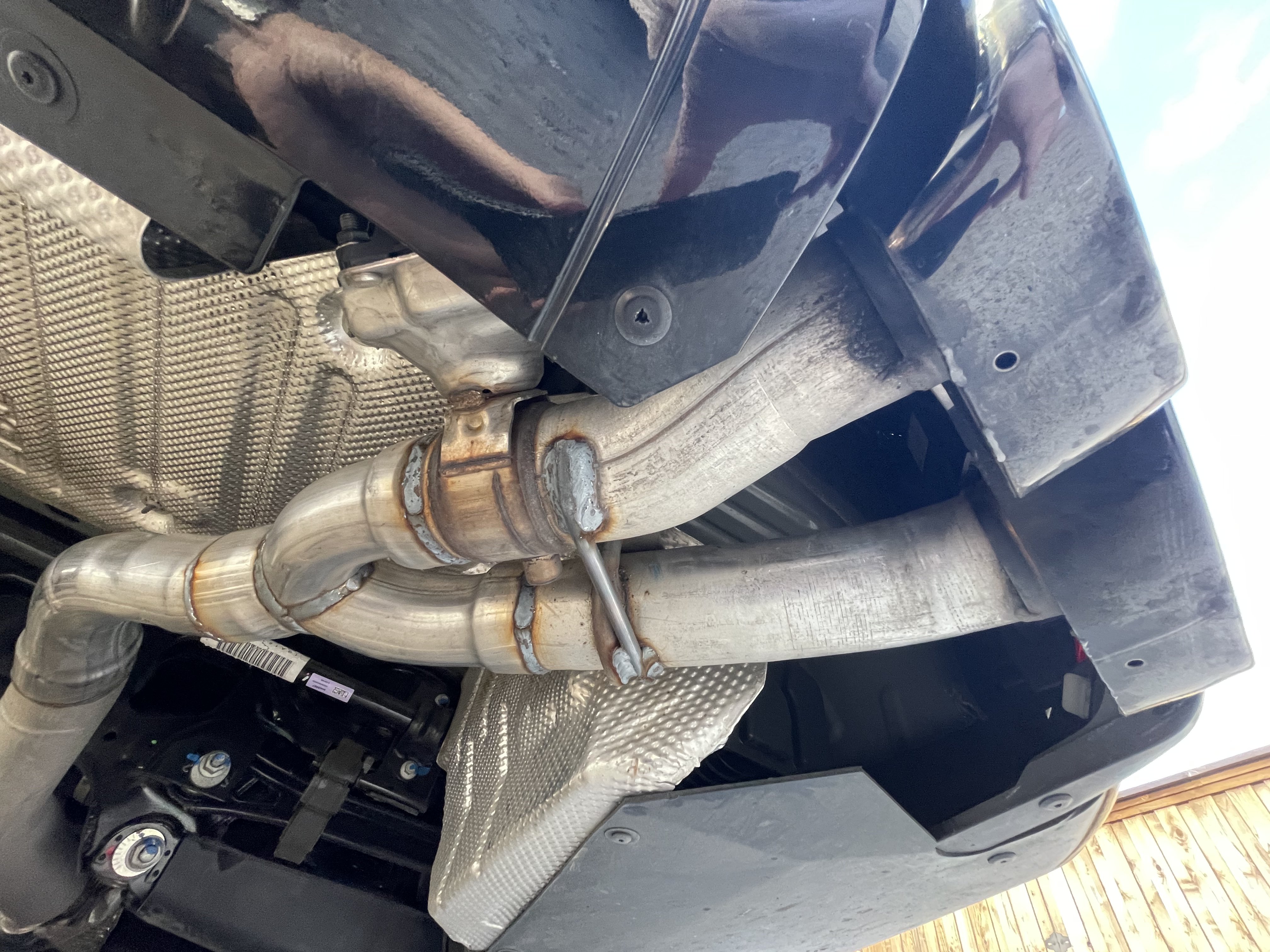

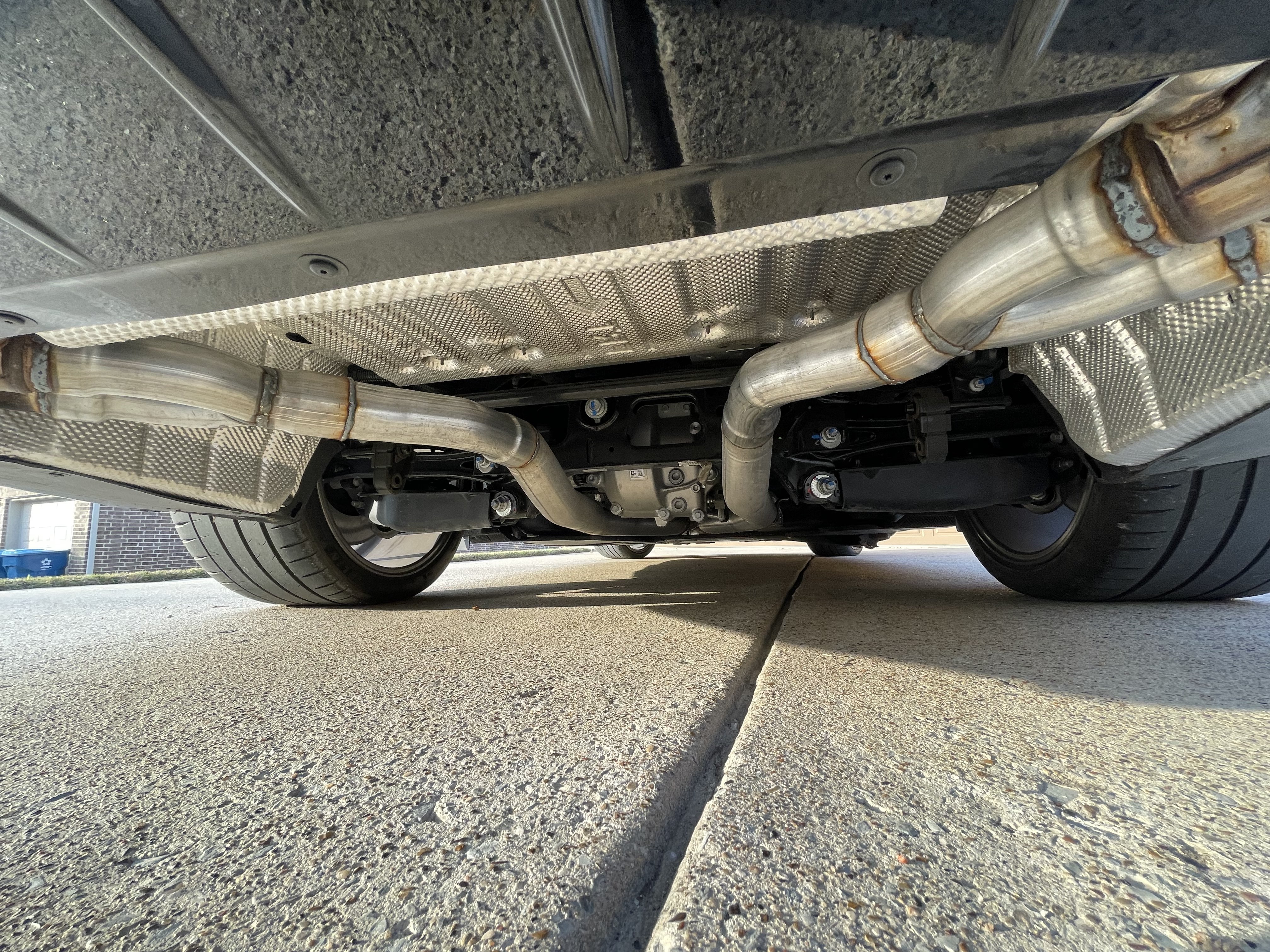

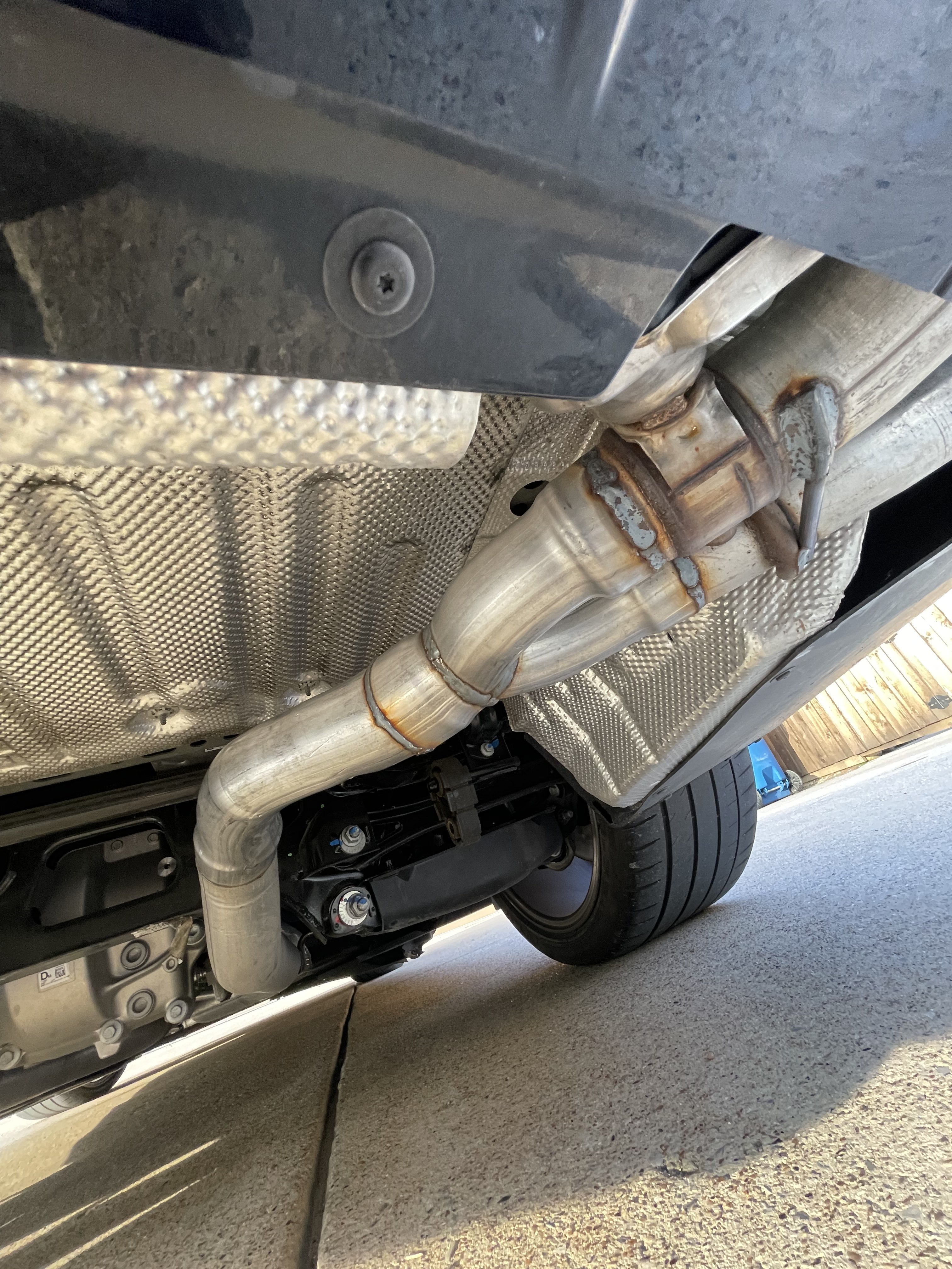

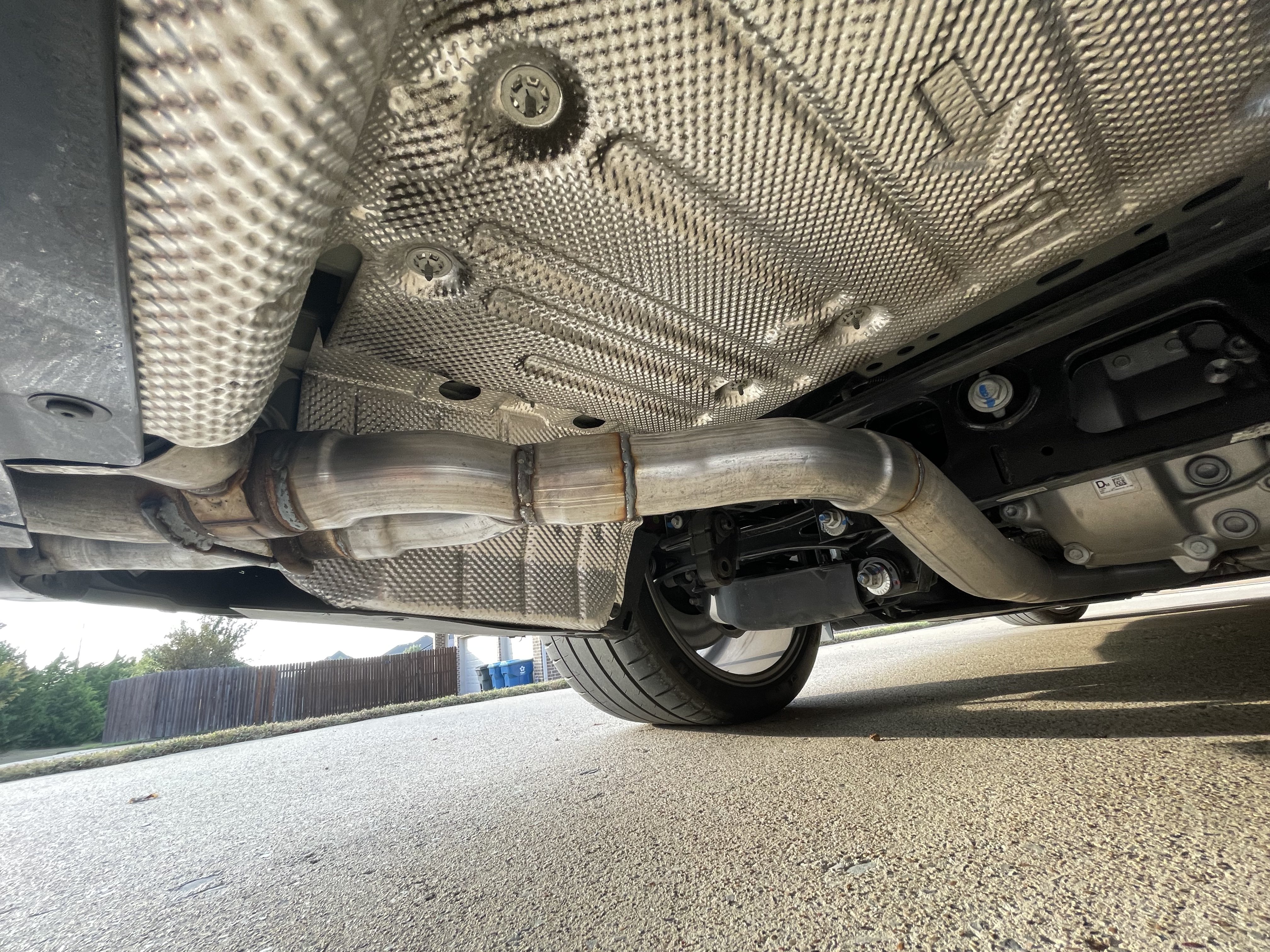

Something I’ve been thinking about doing for awhile now. Finally pulled the trigger. Figured worst comes to worst if the outcome wasn’t the expected sound, we could re weld in the stock box.
Left the stock tips and valves for obvious reasons.
Both videos are with the valves fully open.
Volume ⬆️!

I dont get the point of keeping the valves when it doesnt force the flow back into a muffler. All its doing is effectively just shutting one pair of the exhaust tips. Just dont see how that would really change much of the sound honestly.
But atleast its not as loud as we thought it would be with basically a straight piped exhaust. Plus the weight saving since we imagine the stock mufflers are pretty heavy.
Keeping the valves was necessary for me considering I’ve got a 15 month old little girl. When we’re in my car in lieu of my wife’s, it’s nice to be able to put it into its quietest mode.
As for the sound, it didn’t necessarily change. The notes hit a little higher / lower depending on the mode but the difference is minimal. Main change is the total volume you gain compared to stock. Sounds much better in my opinion
I haven’t yet. I’m sure it’s every bit of 40-50 pounds though.
You know I get trimming weight but the balance of the car was nearly 50/50 and they do things like put the battery in the back to achieve this. My question is what is the new weight distribution? Do you feel any effect in handling? Are you seeing more wheel spin than before?
No idea of the new weight distribution. No effect on the handling after the removal. And the wheels spin quite a bit with the JB4 installed.
This were purely to help get a truer tone of the motor as I felt the stock box was too quite. Even with the values fully open.
