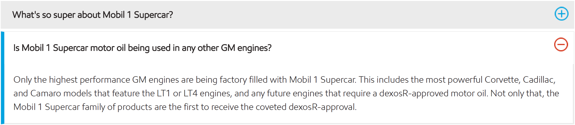

Cadillac/GM in their CT4V-BW service manual specifies the older oil - reference document 6131547:
"Engine Oil 5W-30 - part #19293000". Yet, Mobil 1 claims that Cadillac performance vehicles come from the factory with Mobil 1 Supercar. Maybe they mean only the CT5V-BW.
To me, that is confusing.

It's not confusing. The FAQ specifically refers to cars that come with LT1 and LT4 engines, which the 4BW doesn't.
