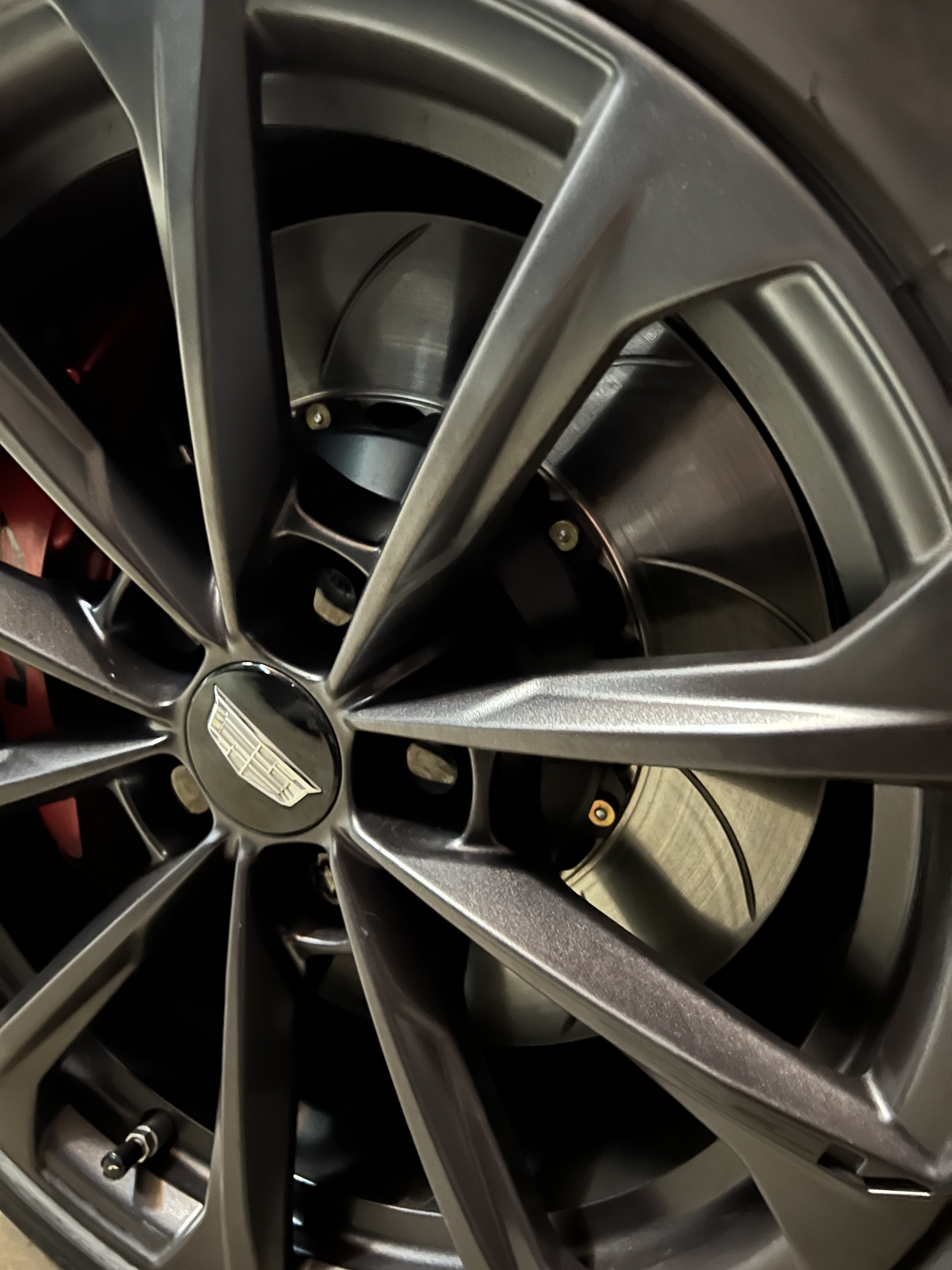

Can I get your opinions on my front rotors
Ok so now I'm in a weird situation. I finally got my front rotors and pads replaced. The shop I went with told me they were ordering OEM rotors but "accidentally" ordered GiroDisc and put those on. Is there any reason I should NOT want the GiroDisc on my car? I realize they are less expensive and I need to figure that part out with the mechanic.
I have only heard great things about Girodiscs from the track rats I know. Having a pair of those in place of the OE rotors seems like a good thing especially since they shit the bed on you so soon. People use them because they are lightweight and can save over 5lbs of rotational mass, resistant to thermal cycling and the disc can be purchased separately to save costs. In some applications girodiscs offer a larger brake surface area and include caliper brackets.
I know the Girodiscs can handle track abuse, as to how long they will last is another concern I never thought of. I'm curious to know myself and I'll ask around but would someone chime in who's knowledgeable on the longevity of Girodisc rotors?
There was likely nothing wrong with the rotors that were on the car. I’ve abused my 5 about as much as one can at the track and can easily go 3 sets of pads before the rotors are to their minimum thickness allowed
Girodiscs wer considered a premium replacement for the C7 Z06 and that has the same calipers as the CT4-V BW has.
Thanks for the feedback y’all. Sounds like I will be sticking with these rotors. So far so good. I will update if there are any issues.

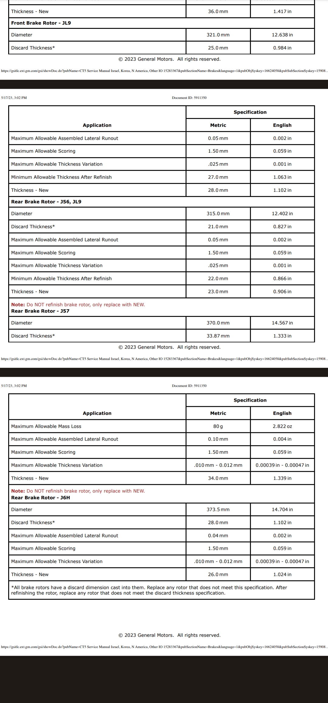

FWIW I usually replace rotors or do a heavy bed in procedure in lieu of refinish/resurface. I suspect it recommends replacement because these braking systems are track capable. Resurfaced rotors put alot of heat on the steel face of the rotor and they are then more prone to symptoms associated with a warped rotor when tracked.

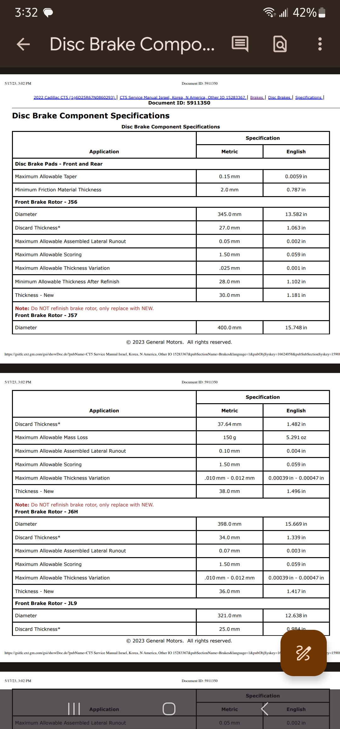

Mother of God your right, attached is the service manual disc brake specsView attachment 20573View attachment 20574
this is really strange, it contradicts itself, saying both, there is a minimum allowable thickness "AFTER REFINISH" (implying a refinish is OK so long as it is think enough), and "Do NOT refinish...". So which one we following?
🤔I'm not trying to sound like a know it all here but I reviewed the SM in more detail.
J56/JL9 is a V series steel rotor
J57 is the CCB blackwing rotor
J6H is the steel faced standard blackwing rotor
If you notice this verbiage is only mentioned under the V series steel rotors and not the blackwing rotor codes which further solidifies that resurfacing Blackwing rotors is recommended.
It's written in red lettering not to resurface the Blackwing rotors and especially the the CCB rotors.
I am assuming the Asterisk referencing the rotor refinishing is only applicable to the J56/JL9 and they didn't double Asterisk for the blackwing rotors. This is a service manual not an owners manual and there are other documents that may dictate what the process is for servicing these rotors.
