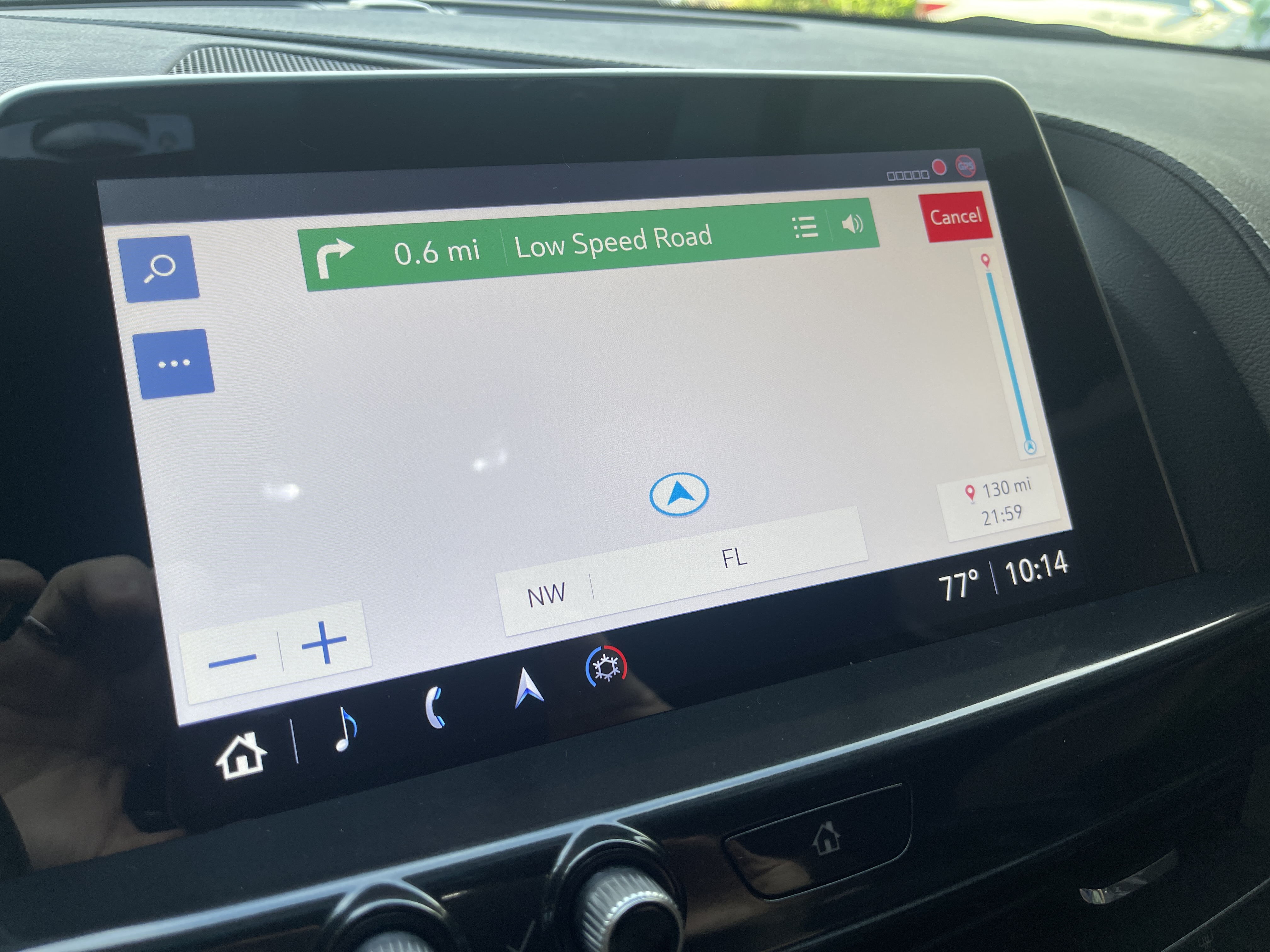

Pulled the brown coax today; and as suspected it is a dual-cellular/GPS antenna. It did throw one additional code B13AA13‐13 in addition to the code that popped when the purple coax was pulled which was B178C13‐13. This did not throw a CEL or impact other functionality as a result from what I could see.
After pulling brown coax, the infotainment system indicated no GPS in top right corner. However, the built in Nav continue to work but did not load backroad/side roads. I’m thinking the built in Nav uses this dual link for both GPS and data link to load map layers. More testing needed on this. That said, everything else continued to work just fine, voice commands, CarPlay, PDR, etc. need some time for more robust testing on the brown coax but at this time I see little to no impact on my daily usage requirements.
Update: With brown coax removed, built in Nav will work but won’t be accurate with a high degree of error. Map layers will not load or refresh. Speed Limit sign data will also not load.
