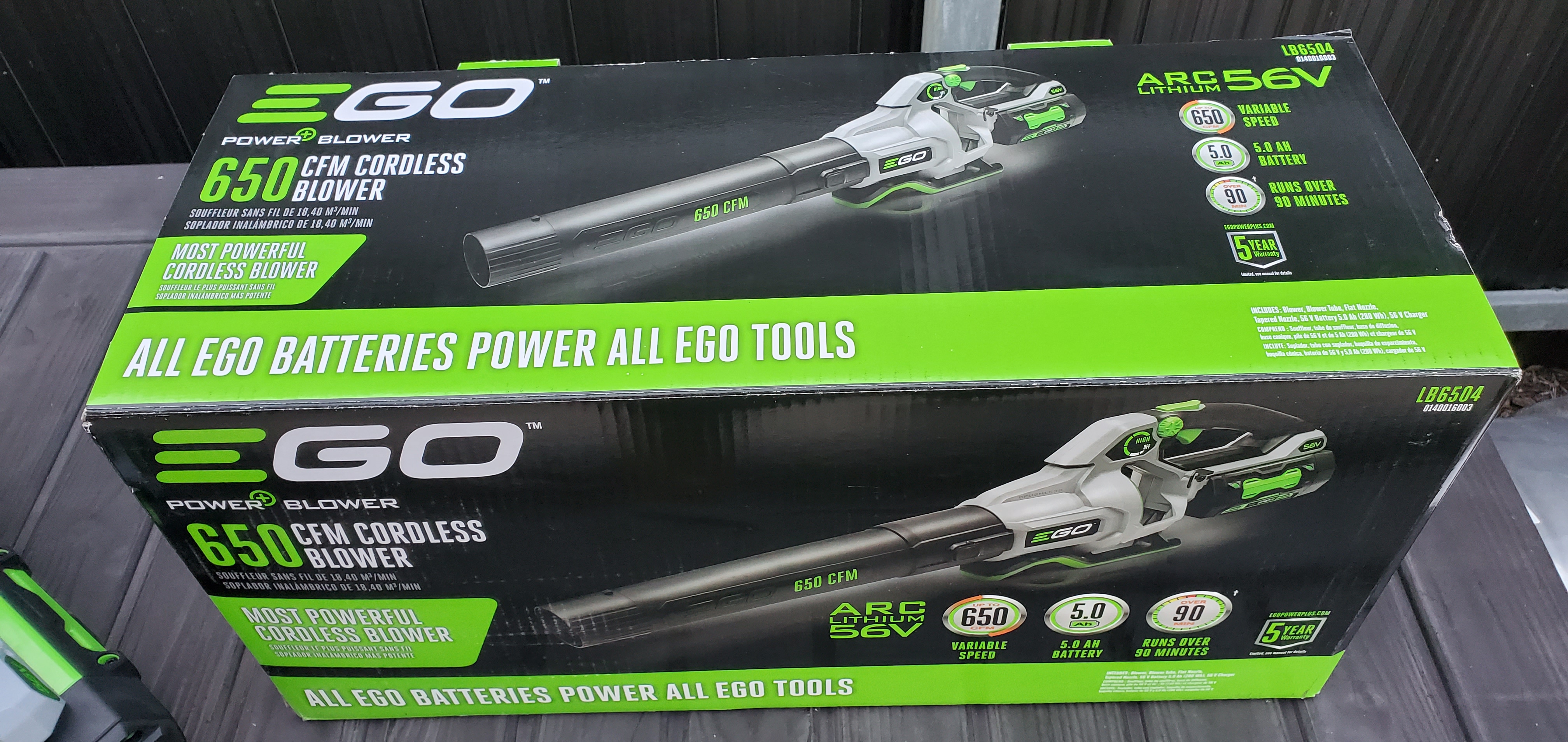

Problem solved ;) Nice and dry.
First step in my evolution towards an a "non" ICE world. :(
