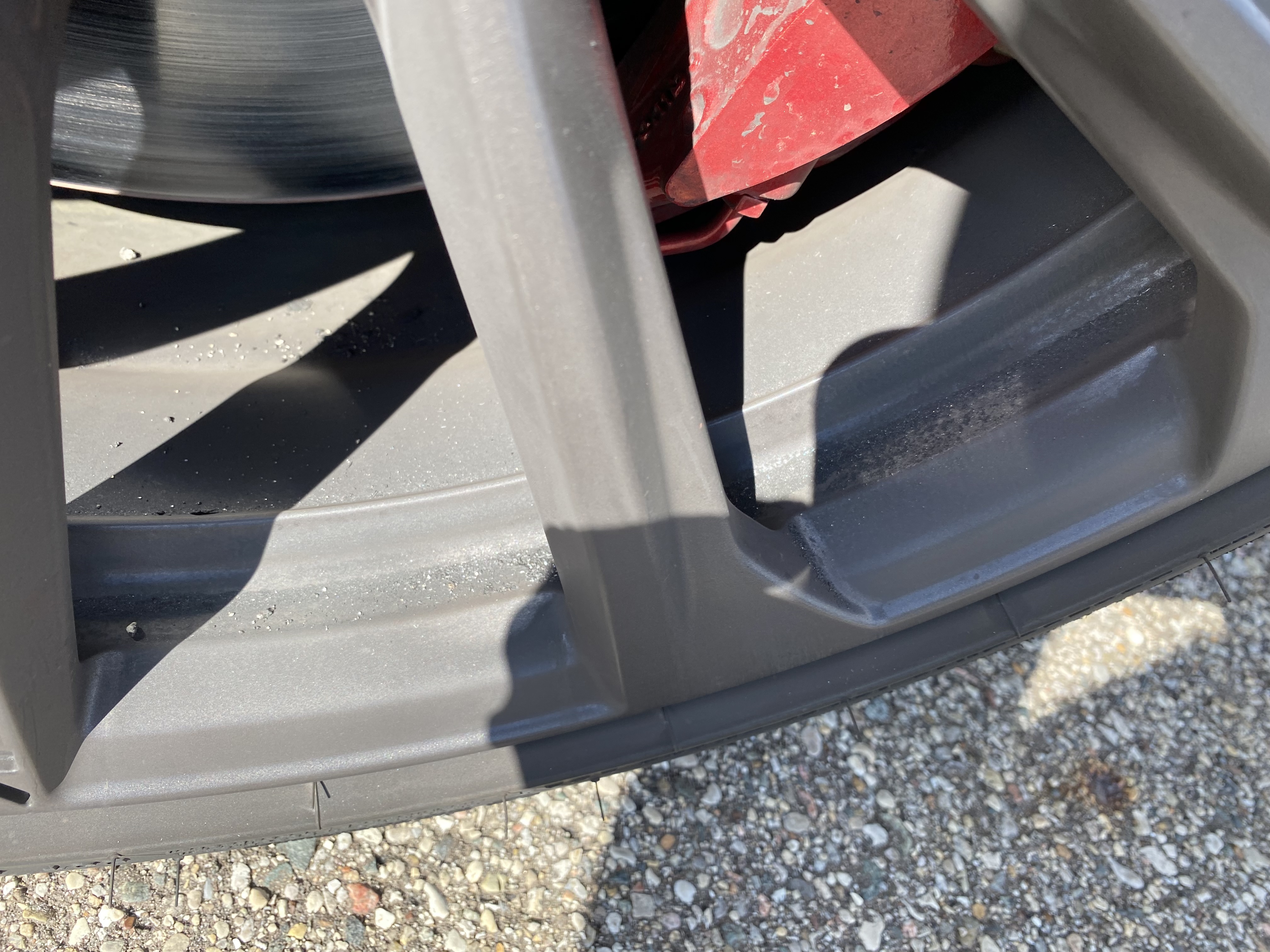

Check mine from track day today lol
Dust is way less than my BMW X3M!
