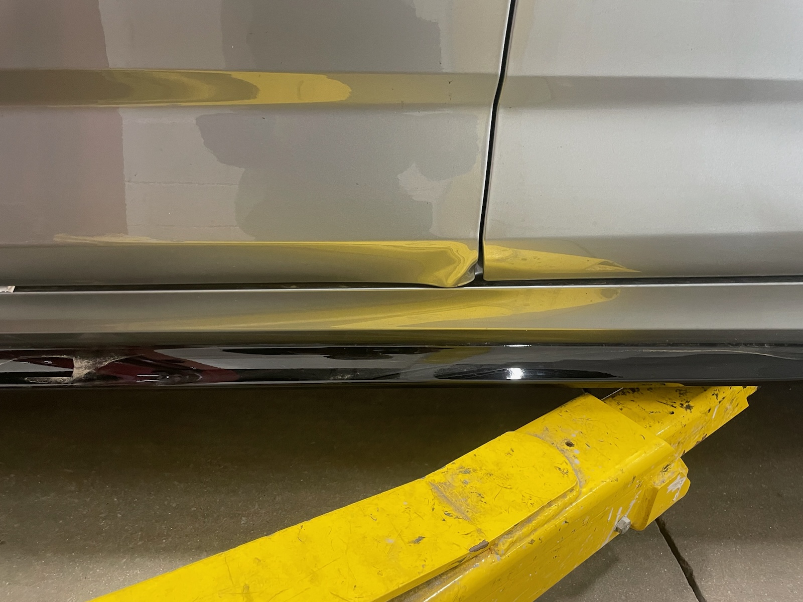

After 6 months or waiting my car came in yesterday only to come in with a damaged driver door corner. Not happy.
What do people recommend? Decline this vehicle and wait for a new one? Or let dealer repair?

The pinch weld on the inside of the panel is cracked open from the bending. I went and saw it today. Unsure now. Dealer said they'll repair it all and let me decide. I'm leaning towards a new order
Get a new one. I think the door skin is aluminum and it's not easy to fix. unlike steel, it does not "remember" its previous shape.

Since this is car highly thought out about Weight Distribution by engineers. The front doors will be AL and rear doors FE for that reason I would surmise. As for fixing that? It wouldn't be a problem for a experienced body guy/gal super easy fix for them. It's lame that it happened but properly fixed you would never know?

OP, the dealer needs to fix it regardless, so see how it looks when it's done then decide. That's really just a cosmetic blemish, and if the repair is done properly and it looks good then keep it and save the grief of a new order.
PDR might work. Here are a couple videos using a quick Google search:
This will likely show up on the Carfax and many will bid lower on your car. I would take another one, unless you plan on keeping this car for 8 years or more and then it doesn't matter a lot.

That is an easy fix. The problem is making absolutely sure that the paint matches. I am 99% sure that they will be blending into the adjoining door and from experience, silver is very difficult to match.

You can't match the thickness of the paint and a good inspection by the dealer or independent will be able to tell that there has been some work done which lowers the value of the car perhaps as much as 10%.
This is all strictly hammer and dolly work with some Bondo thrown in. If it is done correctly, it will only be noticed if you look for it or know what to look for. It won't look 100% like a robot built door skin.
The #1 concern will be the paint. And like I said, silver and metallic paints are the hardest to match correctly. They will need to match and blend perfectly not to notice it in sunlight and streetlights. A pro shop has to have a good paint system in place. Then a good painter will blend the paint into adjoining panels to play a trick on the eye. If the color is off, the blend will keep spreading to compensate. I have seen where a door lock cylinder was punched out and they almost had to paint the whole side of the car to hide the poor paint match.
*** I worked in my family body shop for 12 years and we are still in business 65 years later. If this was my car, I would take a pass and get another one.....only because "I" would know that the damage was there and had been repaired. If you aren't really a car guy and it looks good to you after repairs and you will eventually get rid of the car, then take it and negotiate a discounted price.
