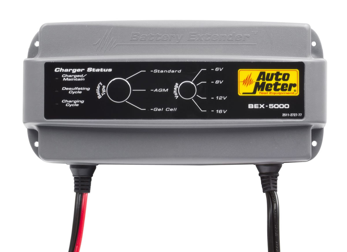

In 2015, AutoMeter redesigned the Battery Extender product line incorporating more modern technology, a widened feature list and more competitive pricing. This second design AutoMeter charger line was released in three versions, 1.5-Amp (PN BEX-1500), 3.0-Amp (PN BEX-3000) and 5.0-Amp (PN BEX-5000).
Auto Meter Bex 5000
One advantage of these new chargers over the original Battery Extender is their three modes of operation: “charging”, “maintenance” and “desulfation”. The first two modes are standard for any smart charger and were available from the old 9201s. What’s new is the “desulfation” mode. Lead-acid storage batteries can develop lead-sulfate crystals on their plates. When a battery becomes “sulfated,” its ability to hold a charge is degraded. Mild cases of sulfation can be mitigated by “pulsing” the charge voltage and current which can cause the crystals to separate from the plates. If an AutoMeter BEX-series smart charger senses sulfation is developing, it goes into the “desulfation” mode where voltage and current are varied in a way that causes the crystals to separate.
Another improvement of the new Battery Extender design is that the unit’s housing is made of a lightweight plastic and is sealed making the device water-resistant to the IP65 standard which means that, not only can it stay dry during a three-minute spray with a water jet, but it’s, also, impervious to dust. In our testing, we found the new, sealed housing not as valuable as an anti-moisture-and-dust measure as it is an “insect repellant” measure. We have two of the old Battery Extenders, which were vented for cooling and one of them is used outdoors under a carport. We’ve found that insects, especially little spiders, like the interior of the first design Battery Extenders–so much so that two or three times a year, we have to unplug it, then use shop air to blow though the housing’s exterior vents to get rid of partially eaten insects, spider poop and spiders. In short, we definitely like the hard plastic housing used by AutoMeter in the current Battery Extender design.
Three other features of the BEX-series chargers are: automatic overcharge protection, reverse polarity protection and spark-free connection. With the first two systems, there’s very little chance of screwing-up a battery by not paying attention to how long it’s connected nor connecting red to black and black to red. With the third, you don’t have to worry about a little spark when you connect the second cable and remember: connect red first and black second.
We like that all Battery Extenders always come in a kit which includes two sets of leads. One set has traditional  spring-clips on one end and another set with ring terminals on one end. Both sets of leads connect to the charger with a quick-disconnect mechanism. The ring terminal set is good in a case where the Battery Extender is always connected to the same vehicle.
Some smart chargers have designed-in protection which prevents the user from mistakenly connecting a 12V charger to a 6V battery. The charger senses the battery’s voltage and if it’s below 5 volts or so, the charger will not function. AutoMeter decided to let the user take responsibility for knowing the voltage of their battery, so, according to Mike Gathman, AutoMeter’s Vice President of Engineering, all the BEX chargers will, “…charge batteries down to an open circuit voltage of 3 volts. It is up the user to select the proper charger or (with the BEX-5000) charge voltage that matches the battery they are charging. The BEX chargers have a timer that will terminate the charge and flash all the LED’s when the charger senses the charge is not making proper progress due to a defective battery, a large parasitic draw, or wrong battery voltage.”
We have tested the BEX-5000 against some other chargers and, indeed, it will charge a very low battery when some other products will not.
The final advantage of the new BEX line is that they are priced lower, and with the BEX-1500 and BEX-3000, a lot lower than the first generation Battery Extenders. Thank modern circuit design, lower component costs and lower-cost manufacturing for that.
Our favorite AutoMeter BEX charger is the 3000. We have two in service and one of them has been working almost continuously for three years. The BEX-3000 is compatible with all types of lead-acid batteries: wet cell or “flooded”, absorbent glass mat (AGM) and gel cell. It has a selector button used to set the kind of battery to which the charger is connected. It’s street priced at about 60 bucks and it’s price point coupled its optimization for flooded, AGM and Gel Cell batteries
We don’t recommend the BEX-1500 because some batteries in V-Series are AGM. While the BEX-1500 functions with AGM and gel cells, it’s optimized for flooded batteries, only. Additionally, its very low output makes it impractical for Corvette use if the goal is to charge a partially discharged battery prior to its acting as a maintenance charger. For that reason, we think the 1500, is better suited to ATV, UTV and motorcycle applications. Finally, in our view, its price is too high. For about ten bucks more you can have the 3000 with twice the max. charge rate and compatibility with AGM batteries.
The BEX-5000, AutoMeter’s flagship smart charger, offers the highest charge rate and selectable output voltages of 6-,8-, 12- or 16-volts whereas the 1500 and 3000 are 12V only. When operating the 5000 at the first three voltages, the maximum charge current  is 5-amps, however, in the 16-volt mode, its max. is 3-amps.
The Battery Extenders’ safe ambient temperature range is -4°F to 122°F. Sustained operation outside that range, may cause a malfunction. Their input voltage range  is 108 to 132-volts AC.
