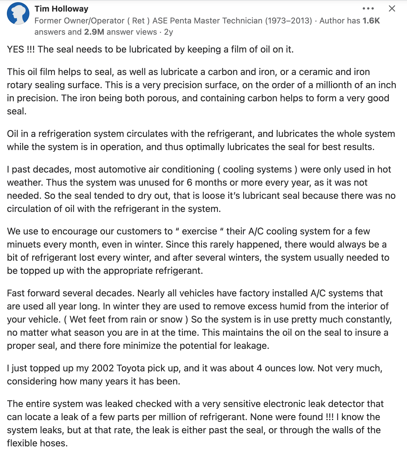

What if you never use the HVAC system? Literally, I never use AC even during summer months and my BW hibernates once its cold out. Come to think of it, I never even tested it. Only had it since 12/22/2021
FWIW, I always read it was important to run your HVAC from time to time so the refrigerant lubricates the seals/o-rings, otherwise you risk drying them out and developing leaks. Here is a good write-up on it.
