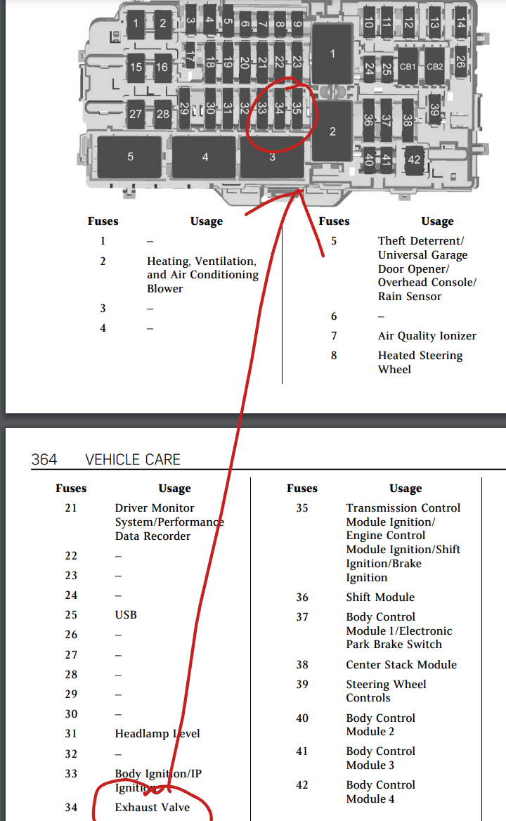

Not trying to veer too far off course here, but since we are talking fuses. Can anyone here with a CT5V BW verify the fuse type for the exhaust valves? I ordered a Mild 2 Wild fuse switch for it, but I probably got the wrong one. I think the C8 version might be the same (Micro3) as the BW.
why would you need this?
Pulling the fuse fully opens the exhaust valves. Even in the most "open" mode the valves will still be slightly closed unless above a certain RPM. That is, unless this is different than every other GM V8 car with valved exhaust in the past 20 years or so. It's only $100 so just going to give it a try.
