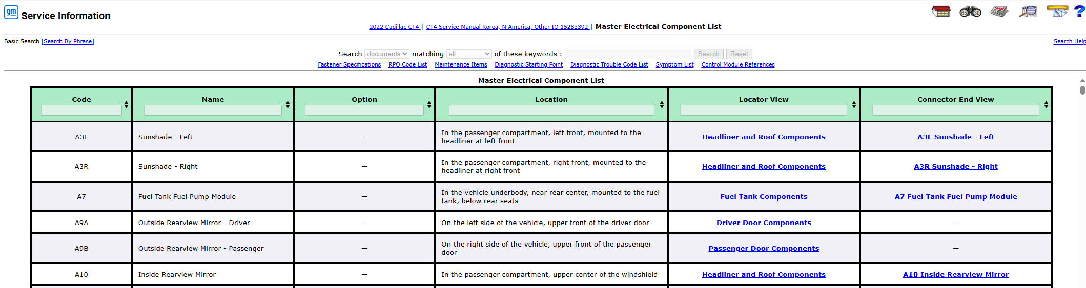

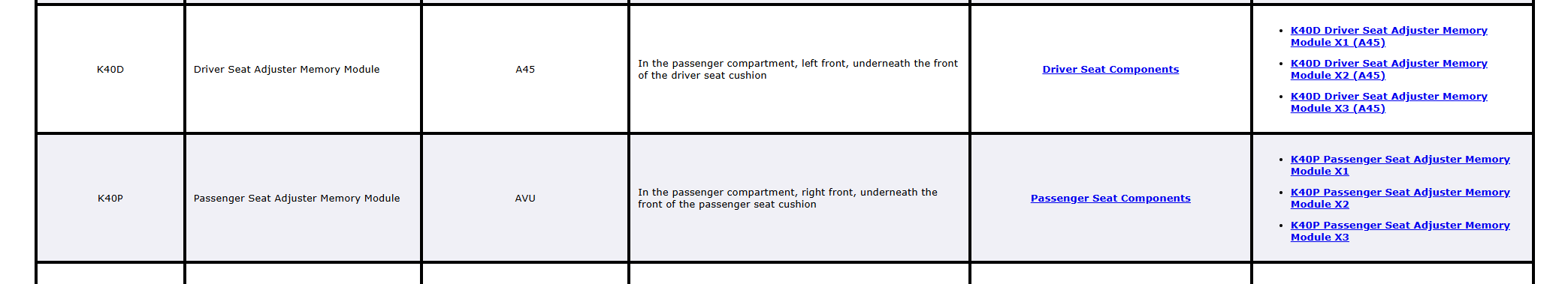

Did you check the online service manual? It will have diagrams of the seat components (Master Electrical Component List - Component Locations - Document ID: 5752806, 5752805, 5752804, 5752803) and the wiring for the pin connections. That might give you an idea what's different between the two seats.

That's a good point - I didn't check those (though I did use some docs for trim removal to get down to the lower seat controls). My sub expired now though ..
