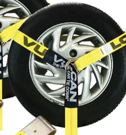

Has anyone trailered their Blackwing (Camaro SS / ZL1)? I am looking for photos and recommendations on how to tie down the vehicle - with the underbody being so low I am thinking of going with tire nets / straps. I can't believe I am saying that my 3rd Gen car seems easier.
- Cars that would be towed: 6th Gen Camaro SS 1LE, ZL1 1LE and CT5 Blackwing with Carbon 1+2.​
Any recommendations with photos are greatly appreciated.
Thank you,
I don't have any photos when I towed my 5BW or C8 to VIR & CMP but I used:
  • Tie down straps on the front wheels (like a tire net but without the expense of a tire net -- see attached example). You'll need to find tie down points on the side of the trailer or underneath. The trailer I rented had tie down points on the side.
  • Tie downs in a cross pattern with axle straps looped around the control arm in the rear.
Hope this helps!
