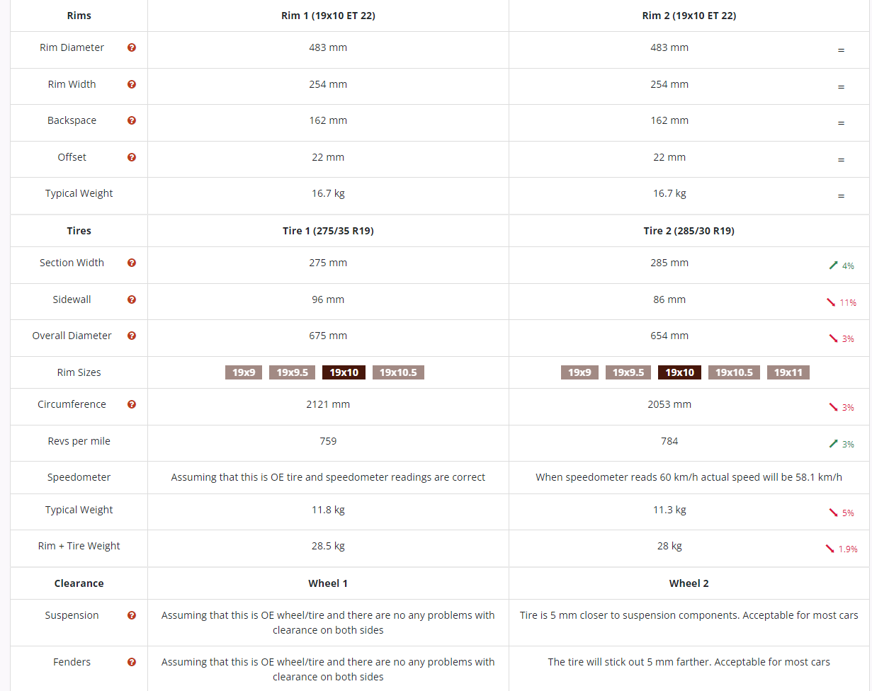

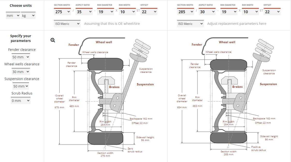

Here's what Wheelsize.com's calculator says when swapping from Apex's 19" 275 front wheel fitment to the 20" 285 fitment:
"Suspension clearance: The Same"
But here's what happens on a 19" when you size up to a 285:
"Tire is 5 mm closer to suspension components"
Sorry but I still don't see it? For 19" wheels I see they have 275 as the front tire.

I just figured that the choice to step up to 285 on the 20" setup would be due to the wheel being 10.5" wide with a 15mm offset, vs the 10" wide, 20mm offset 19" setup.
Either way, Apex doesn't say in their guide why they picked a 275 for their 19" wheel vs a 285, and the camber for the 20" is what they suggested per the guide and not my numbers.
Personally, I'd need to see that a 285/35r19 on a 19x10 ET20 would clear the suspension under compression before I'd put one on. The math says I'd be placing a tire that's 4mm taller, 5mm closer to the suspension components. It looked tight when I looked in there, although I didn't measure.
And as for a 315/35r19...that's nearly 20mm taller and 5mm closer to suspension components in the rear so break out a tape measure I guess.
I'm as interested to see what tire options start being used as anyone, but I need to see it to believe it.
YMMV

Yes, I know that the wheel is OEM sized, but a 285/30r19 is -21mm smaller in diameter (I do not get -30?) from a stock 275/35r19 tire. That means it is -10.5 mm reduced in height away from the struts (10.5mm shorter sidewall/-21 mm in diameter) but still pushed inboard 5mm towards the suspension.
Based on that information, I'd still need to know what remaining inboard clearance/distance between my tires and struts when under load, because I'm still losing 5mm between the tire and suspension when running a 285/30r19.
I'm not saying that it won't fit, I am however saying that without data I can't agree that it will, so buyer beware.
