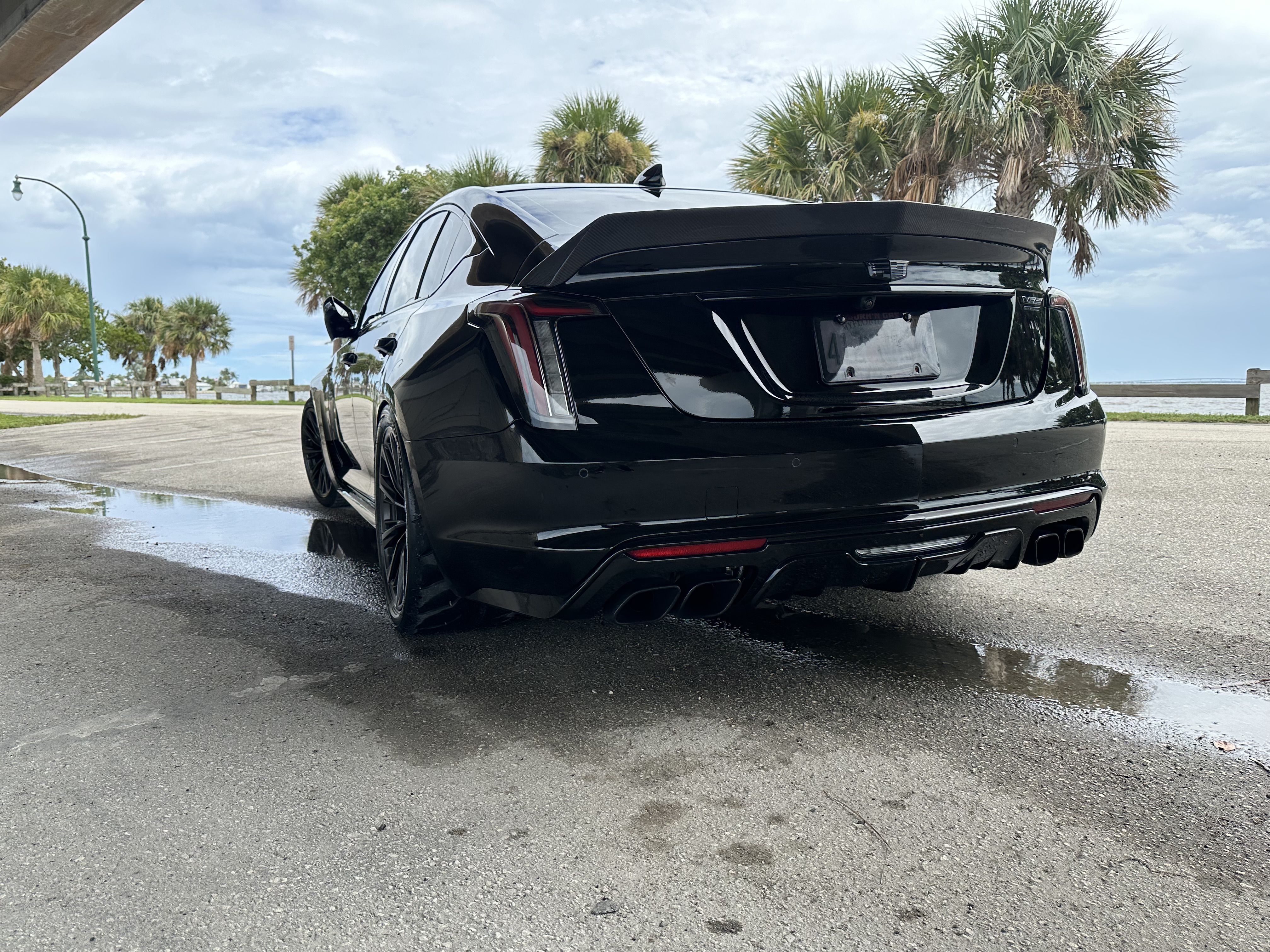

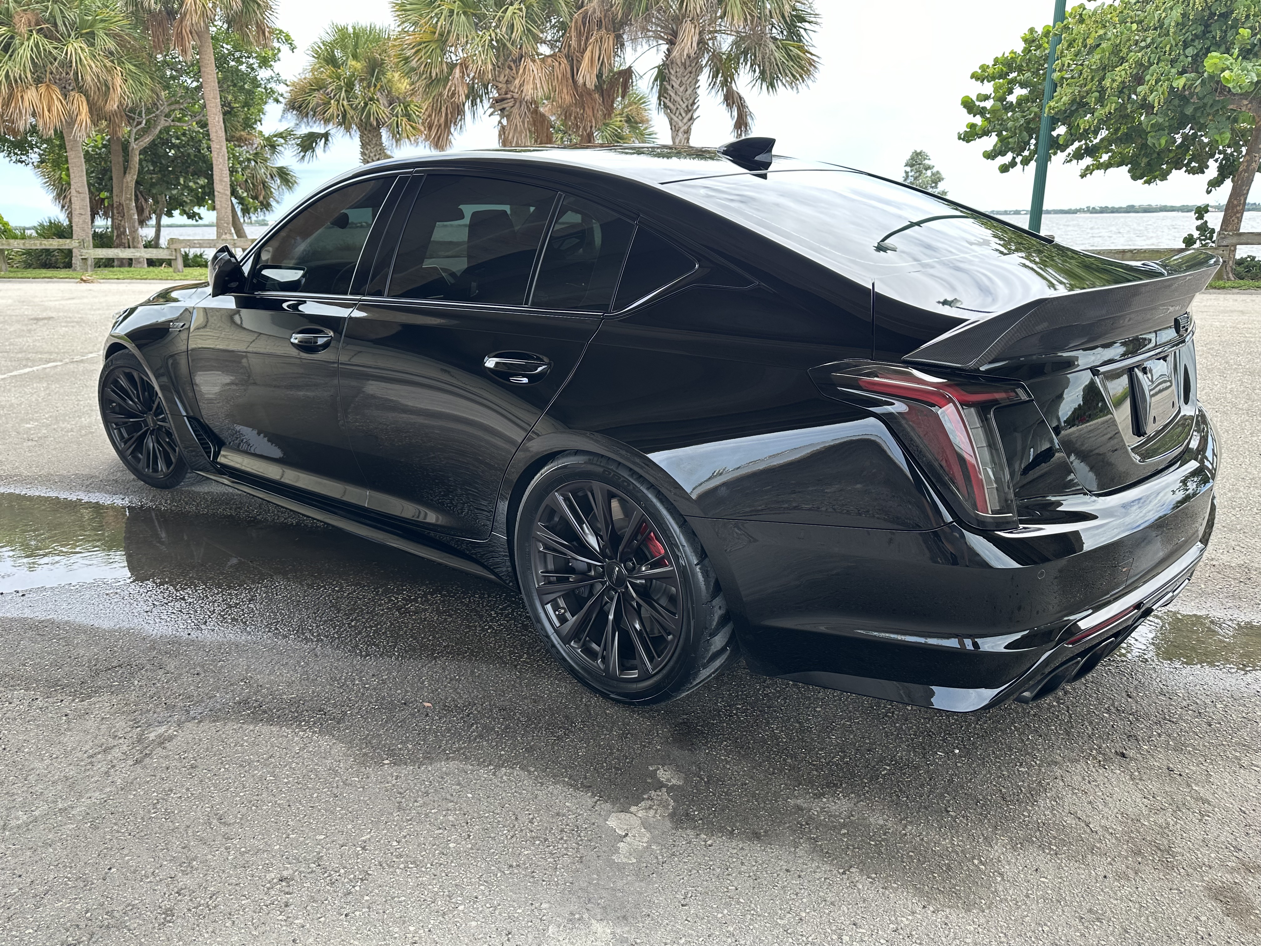

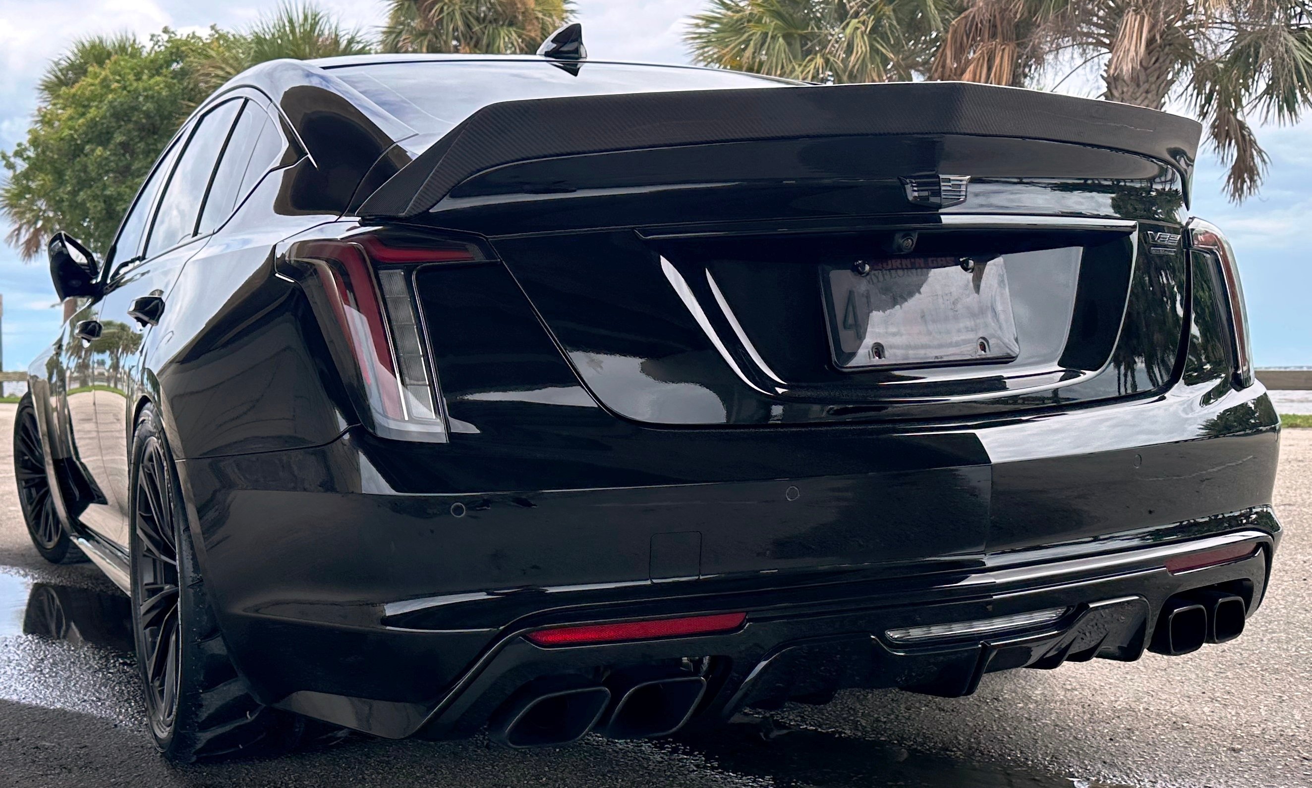

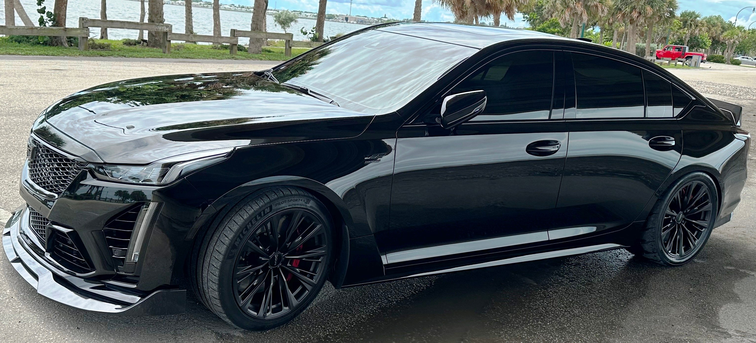

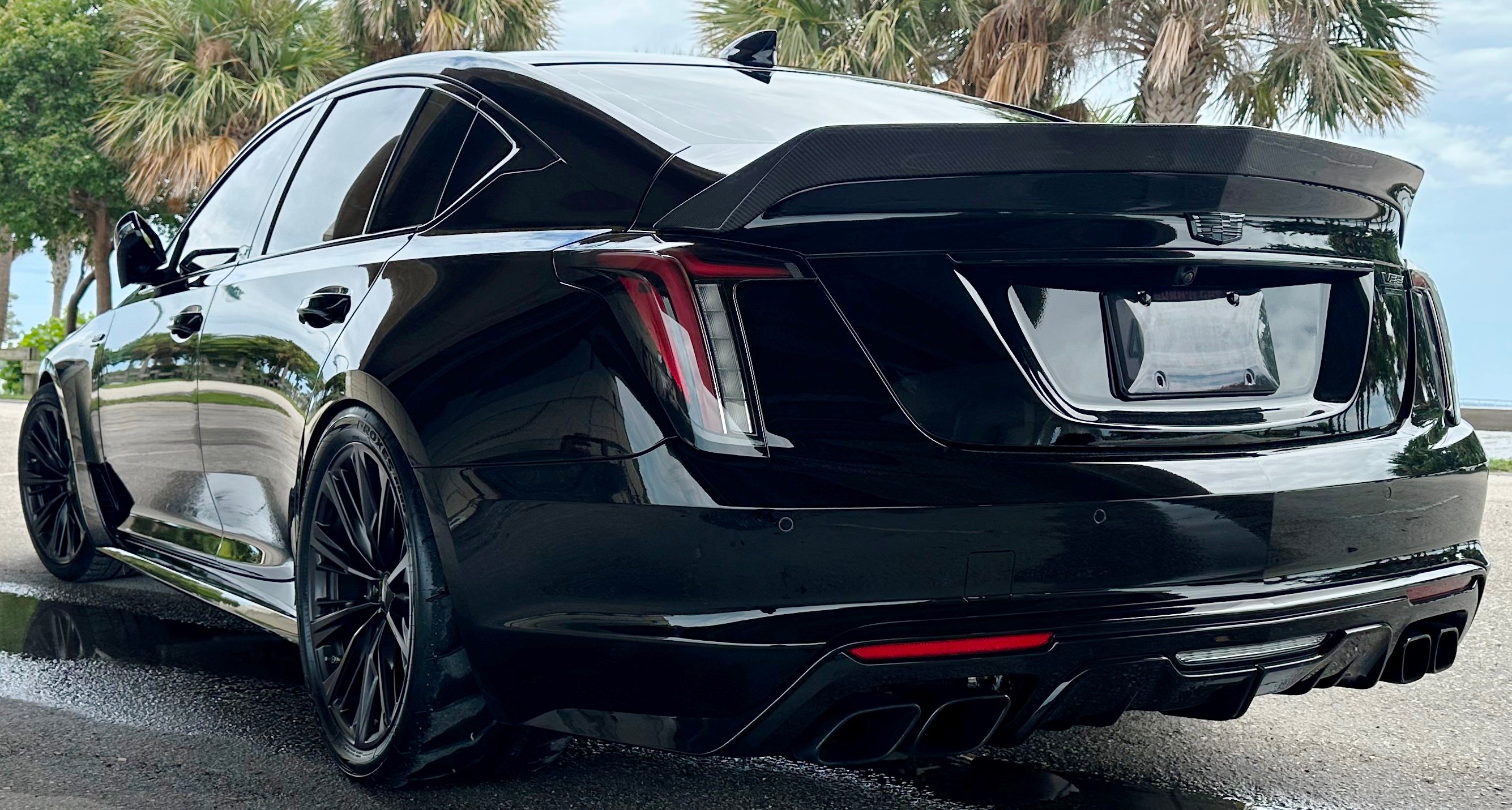

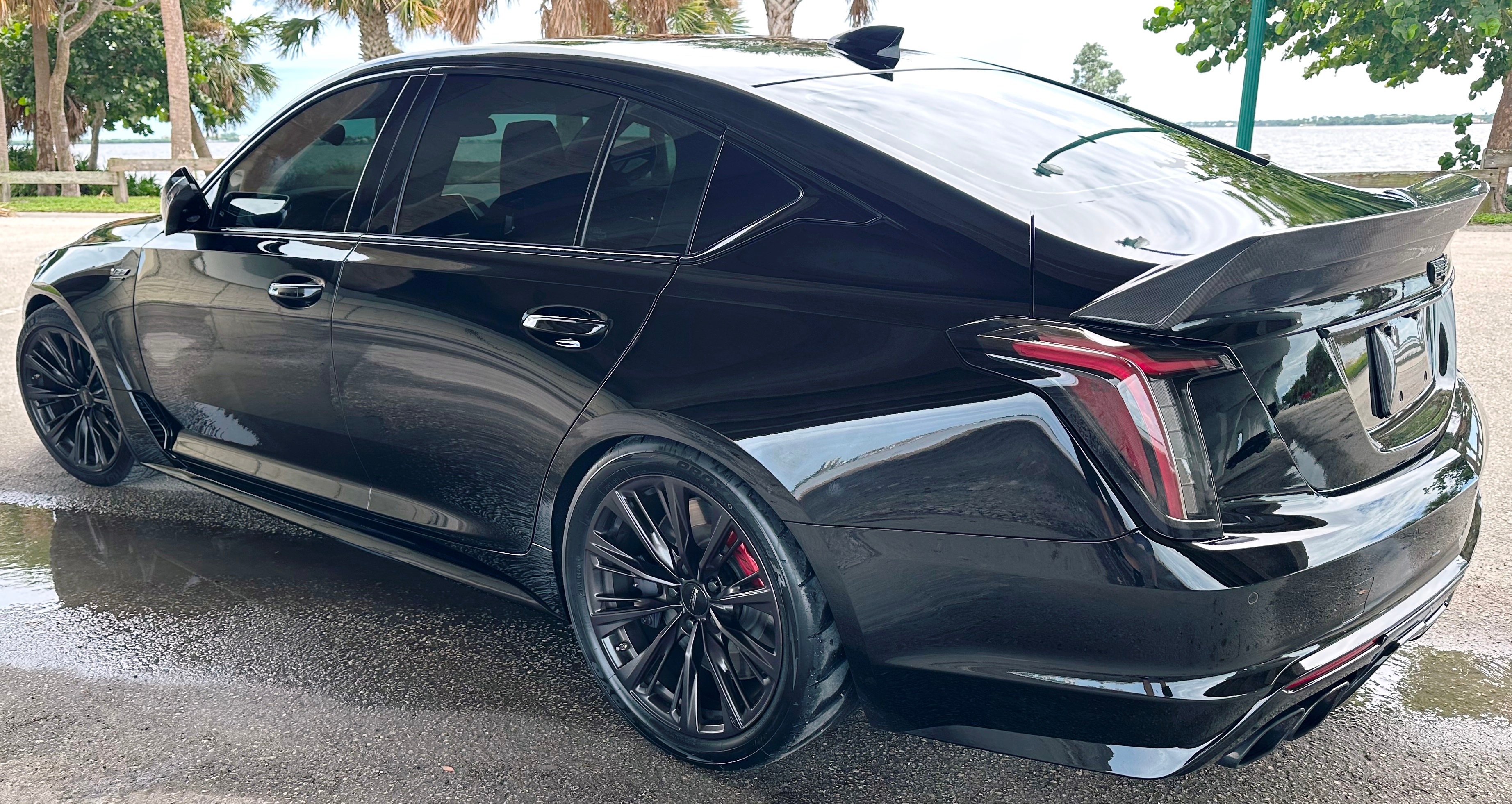

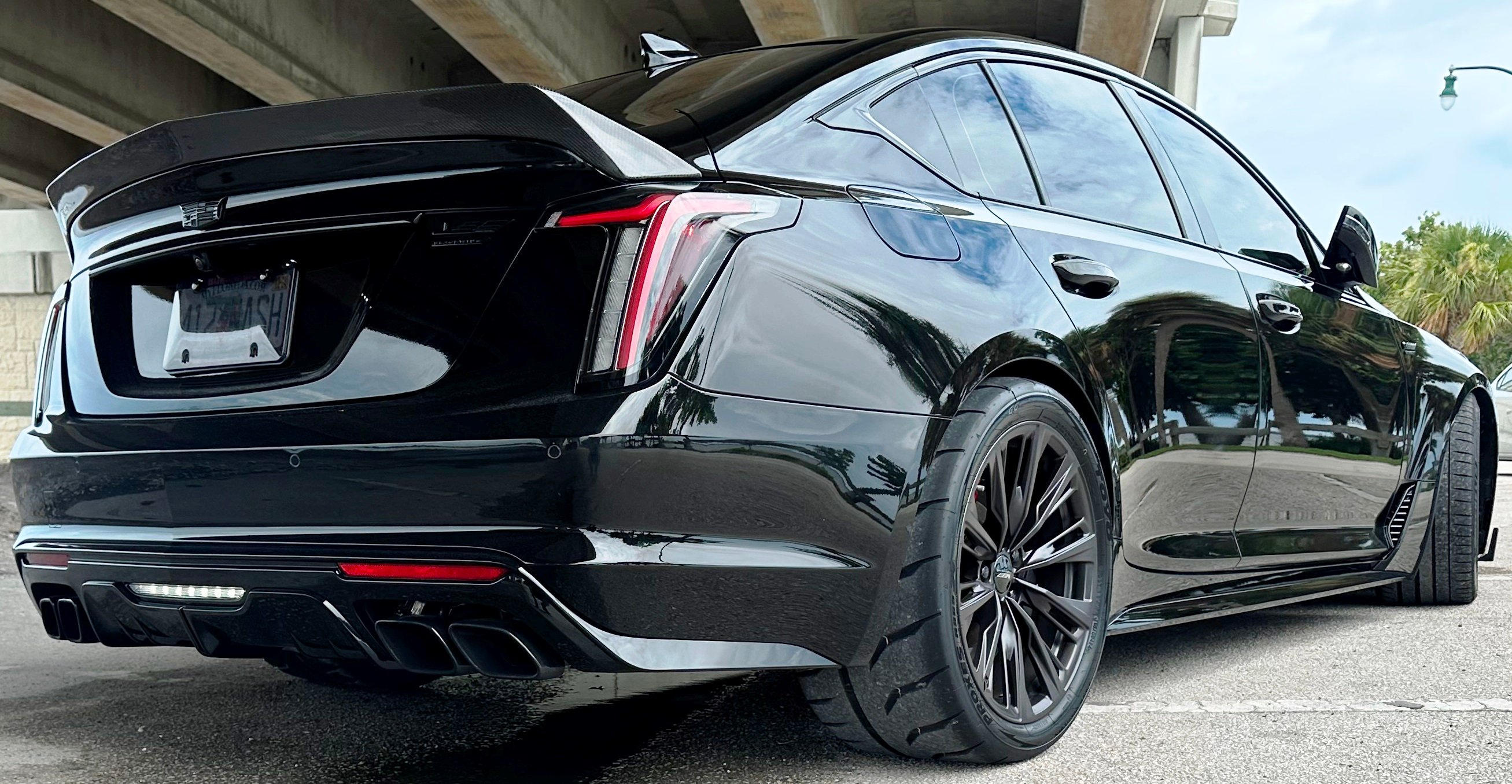

The car is sitting a bit uneven bit they are amazing!
That is killer... almost like it was made for those tires. 😯
So, no rubbing whatsoever?!?
Are your fenders rolled?
Have you checked at the extreme yet (e.g. with two adults in the back seat, hitting a large depression at speed, etc.)?
Car is lowered?

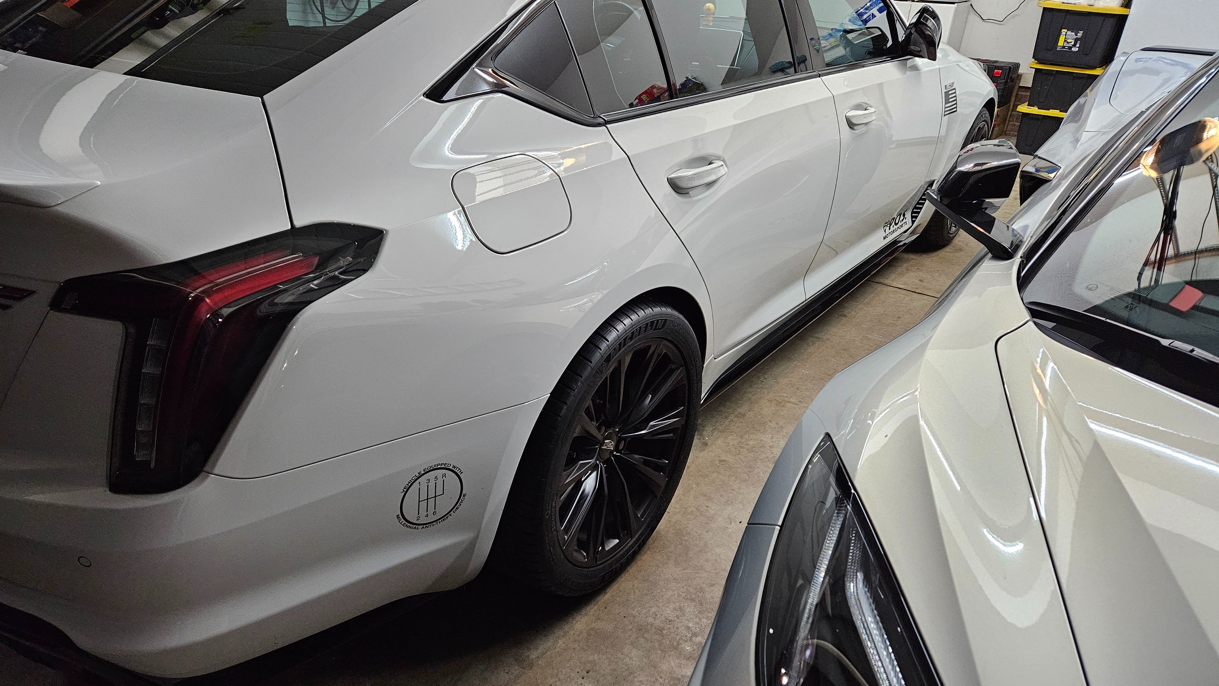

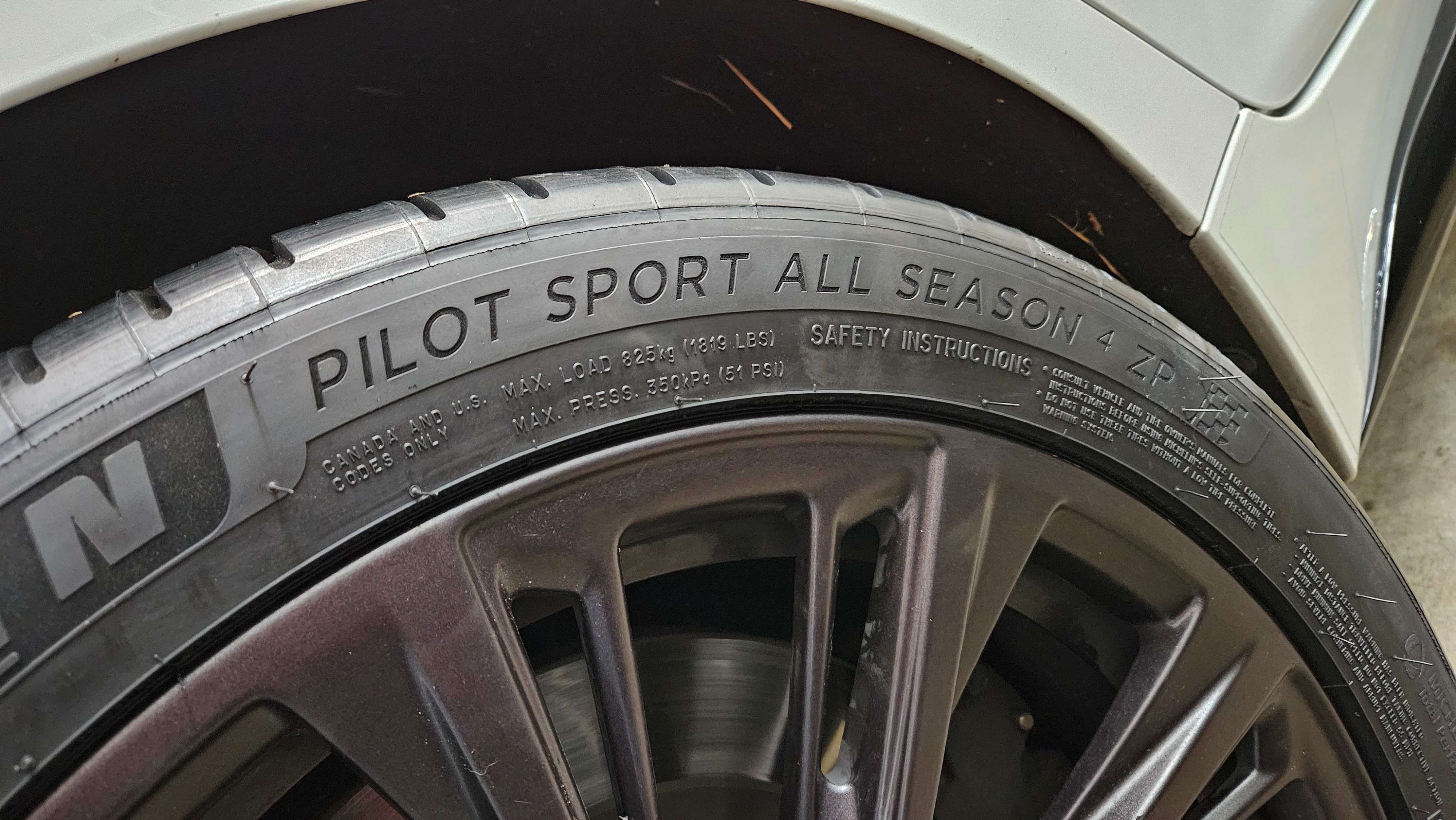

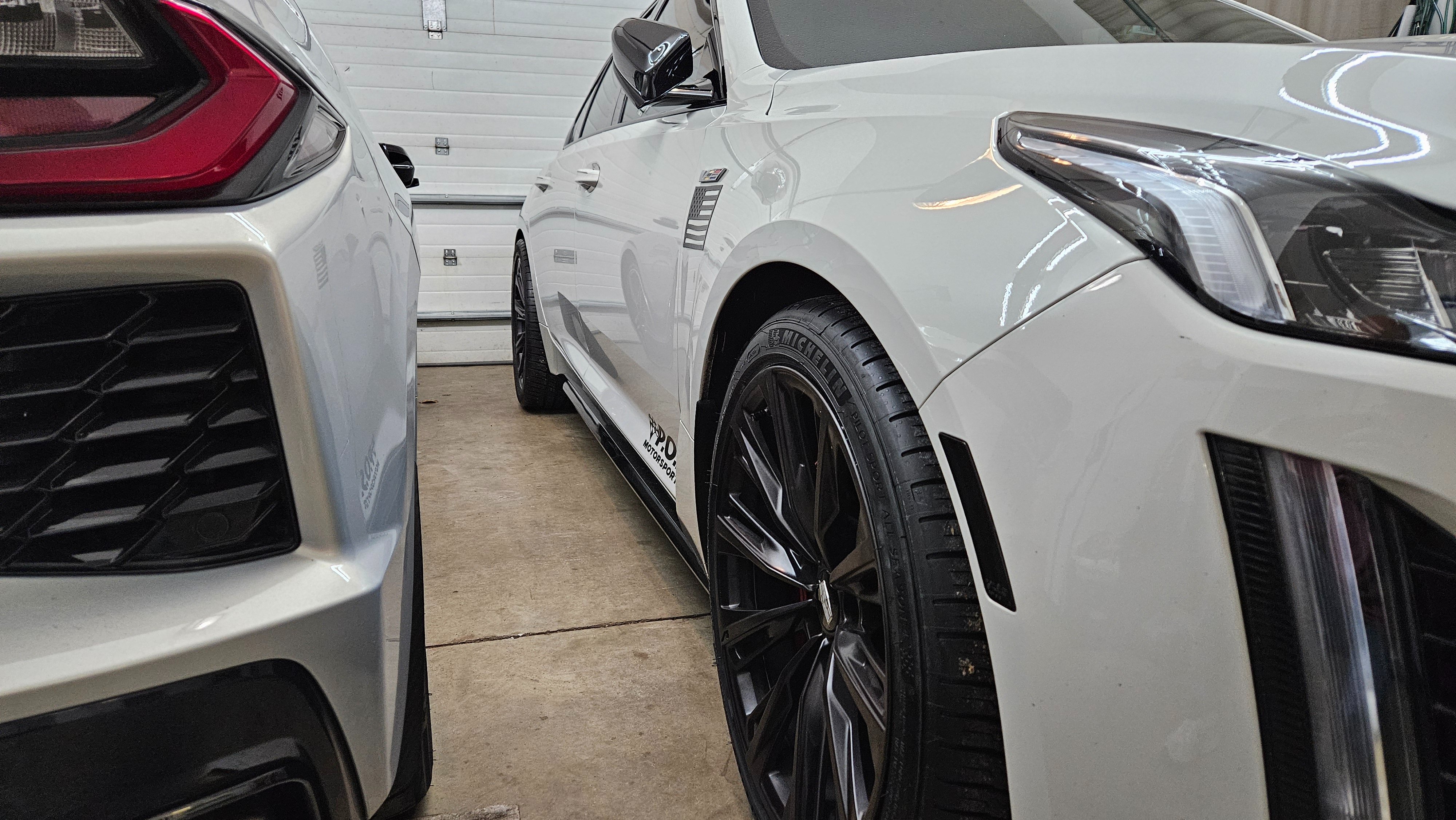

As posted on a previous thread, I did the same thing: Michelin Pilot All Sport AS4 325/30/19 in the rear on OEM wheels with 6mm spacers.
No rubbing at all of the fender. The inside edge of the tire sometimes just barely touches the fender liner -- but just barely & only under severe loading.

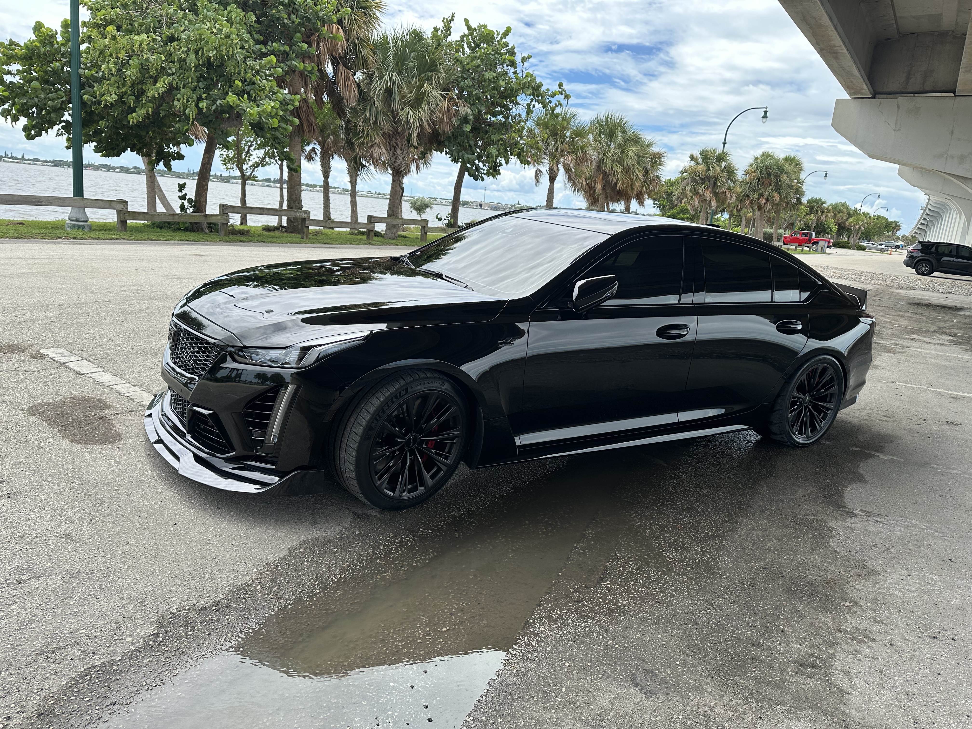

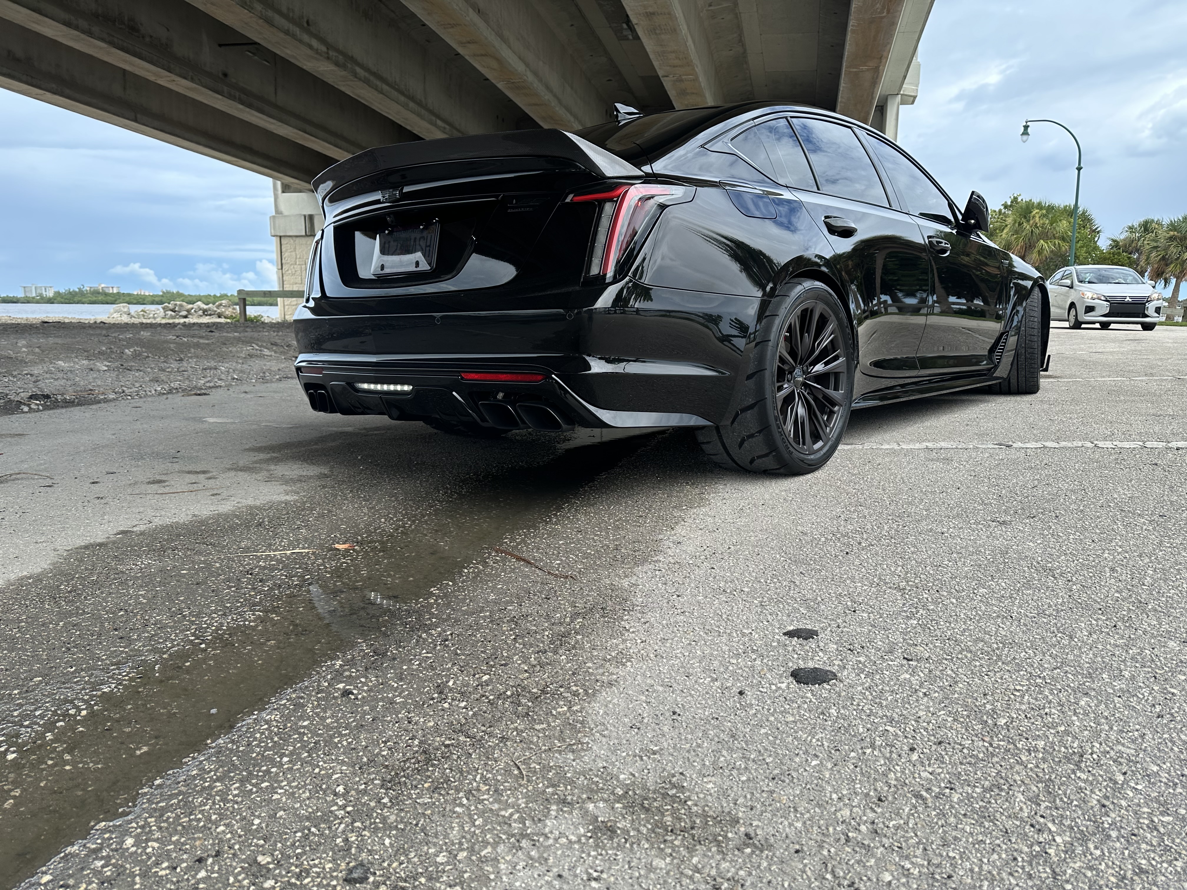

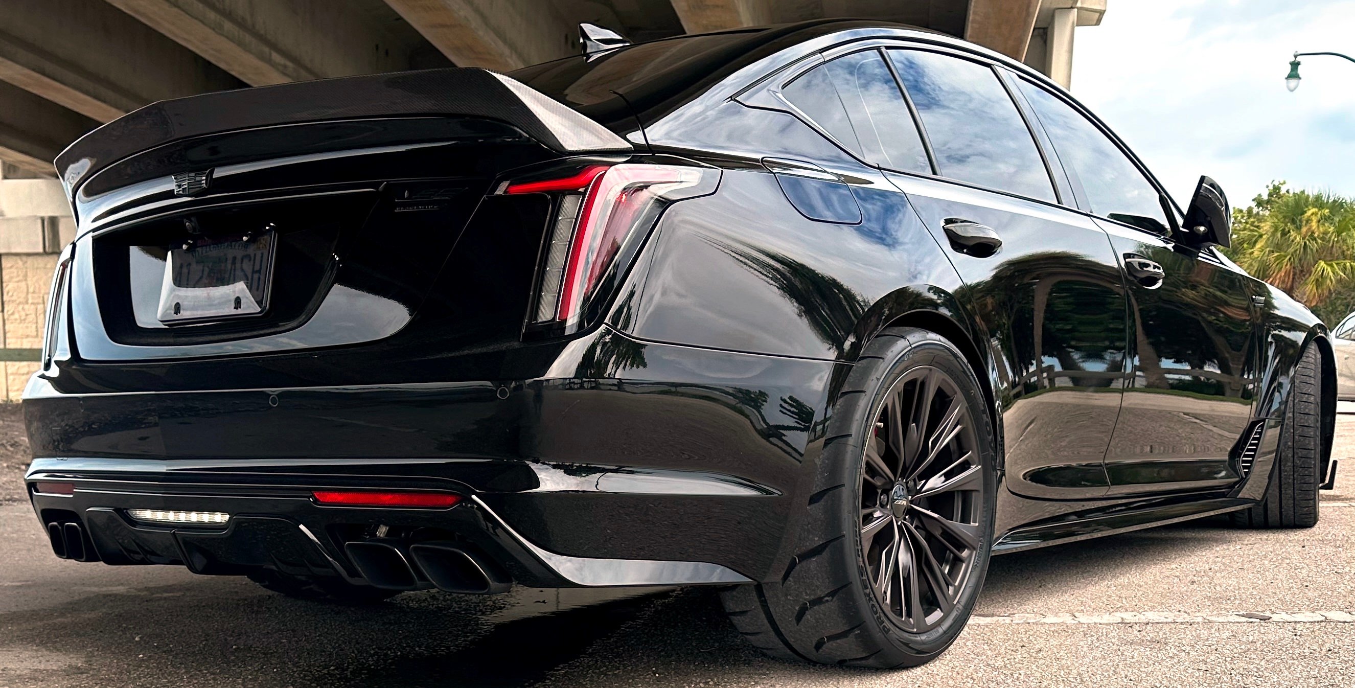

I just put Toyo R888R 325/30/19 on my stock CT5 V Blackwing wheels with 6mm wheel spacers and it works! Hooks like a champ!
Where did you get the extra extension on the front splitter? That looks great.
