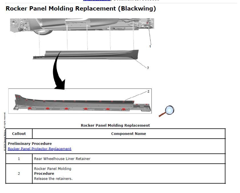

All the carbon parts from Anderson have arrived, I just got them PPF'd and ready for install. I tried looking up on the forum for folks whom have taken their stock side rockers off but didn't find anything. Service manual is really informative :confused:, "Procedure - Release the retainers" perhaps it's just that easy but was checking if folks had any gotchas?

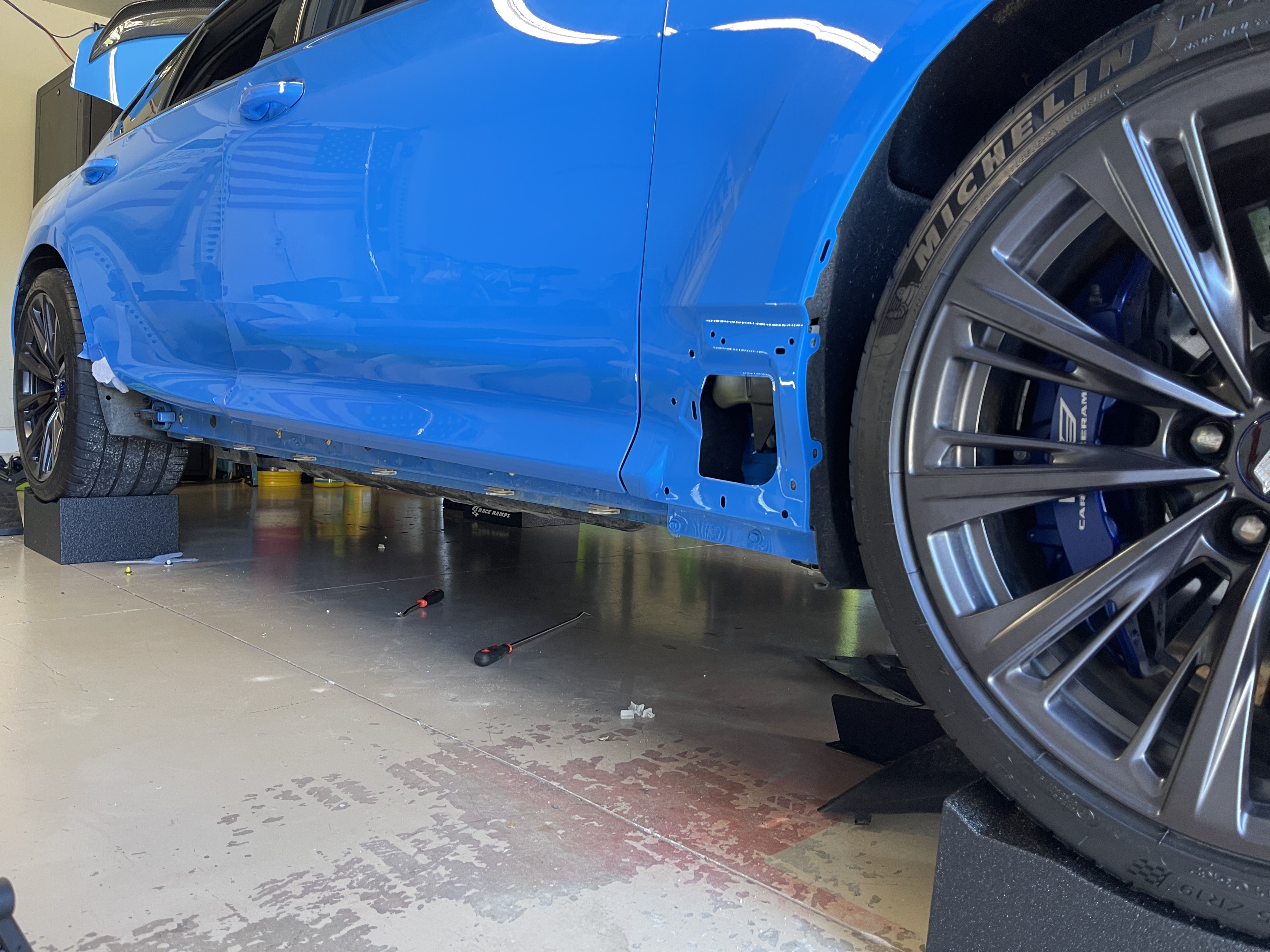

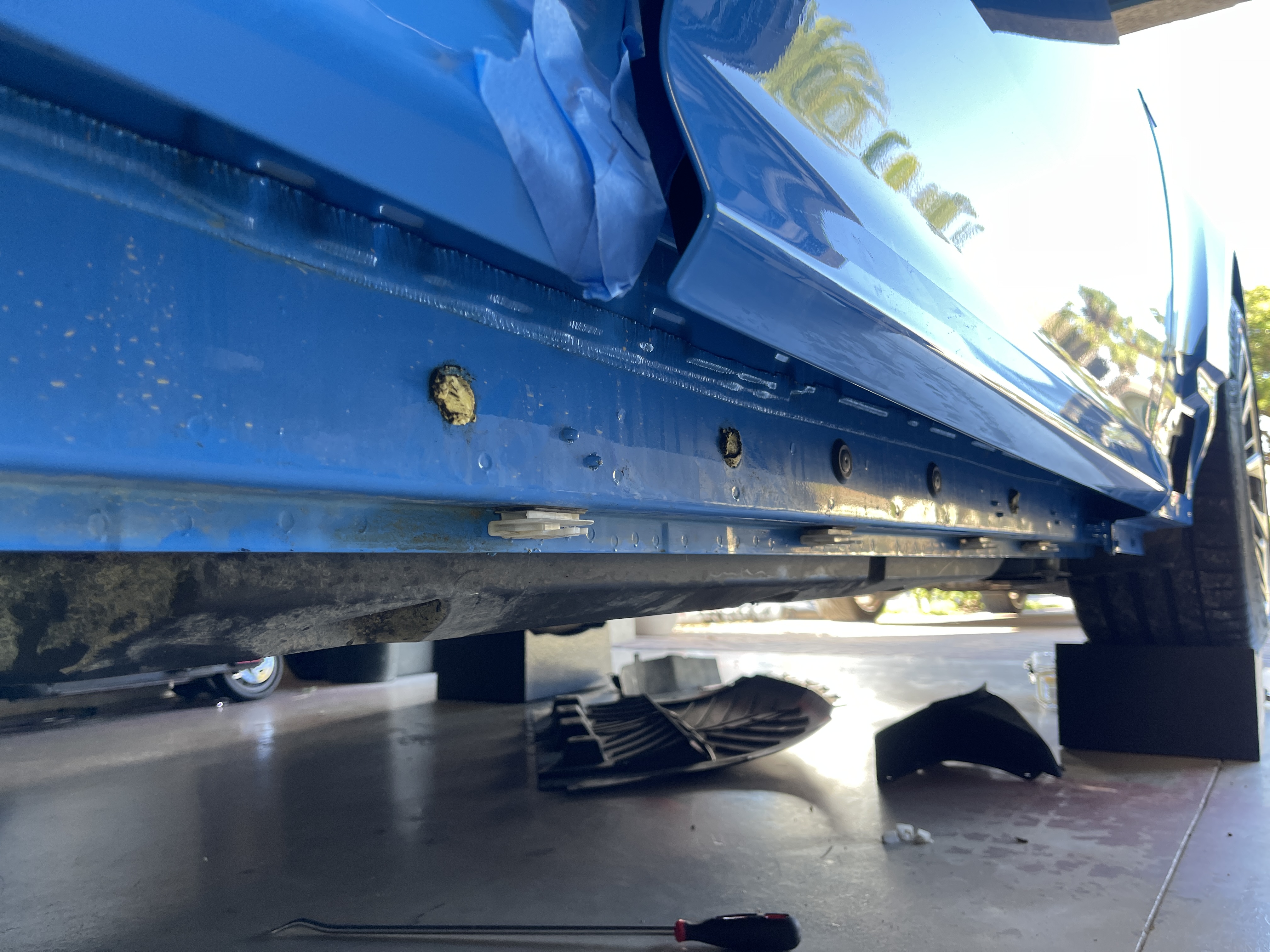

Thanks… I’ve got one side off, taking a bunch of pics for a write up. It’s a royal pain in the ass.

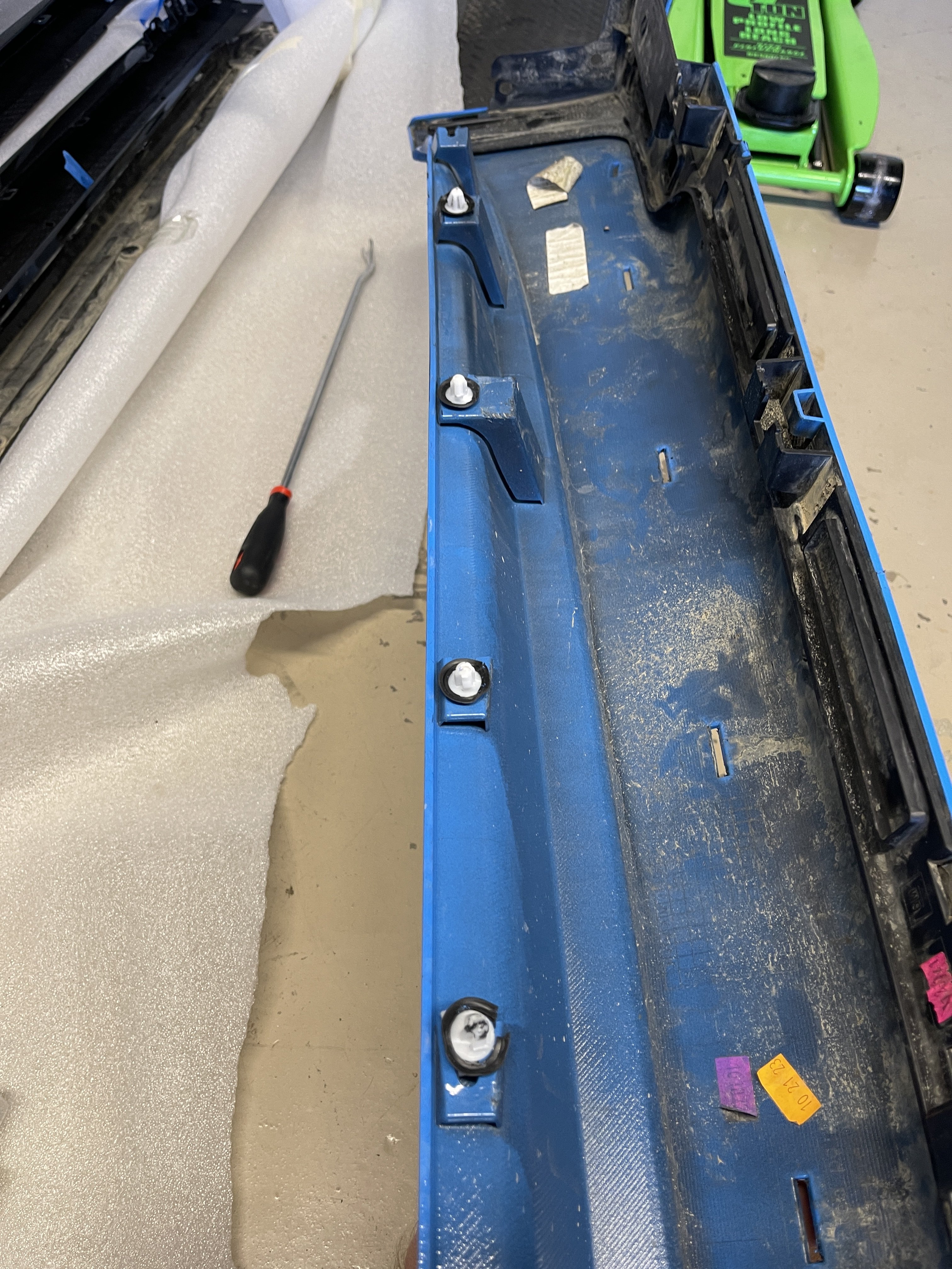

Update: well, wasn’t able to get the entire rocker off. The clips up by the door sills are really tight and I can feel the plastic about the break. Ordered some longer trim tools… if this doesn’t work I’ll need to have a body shop take care of it.

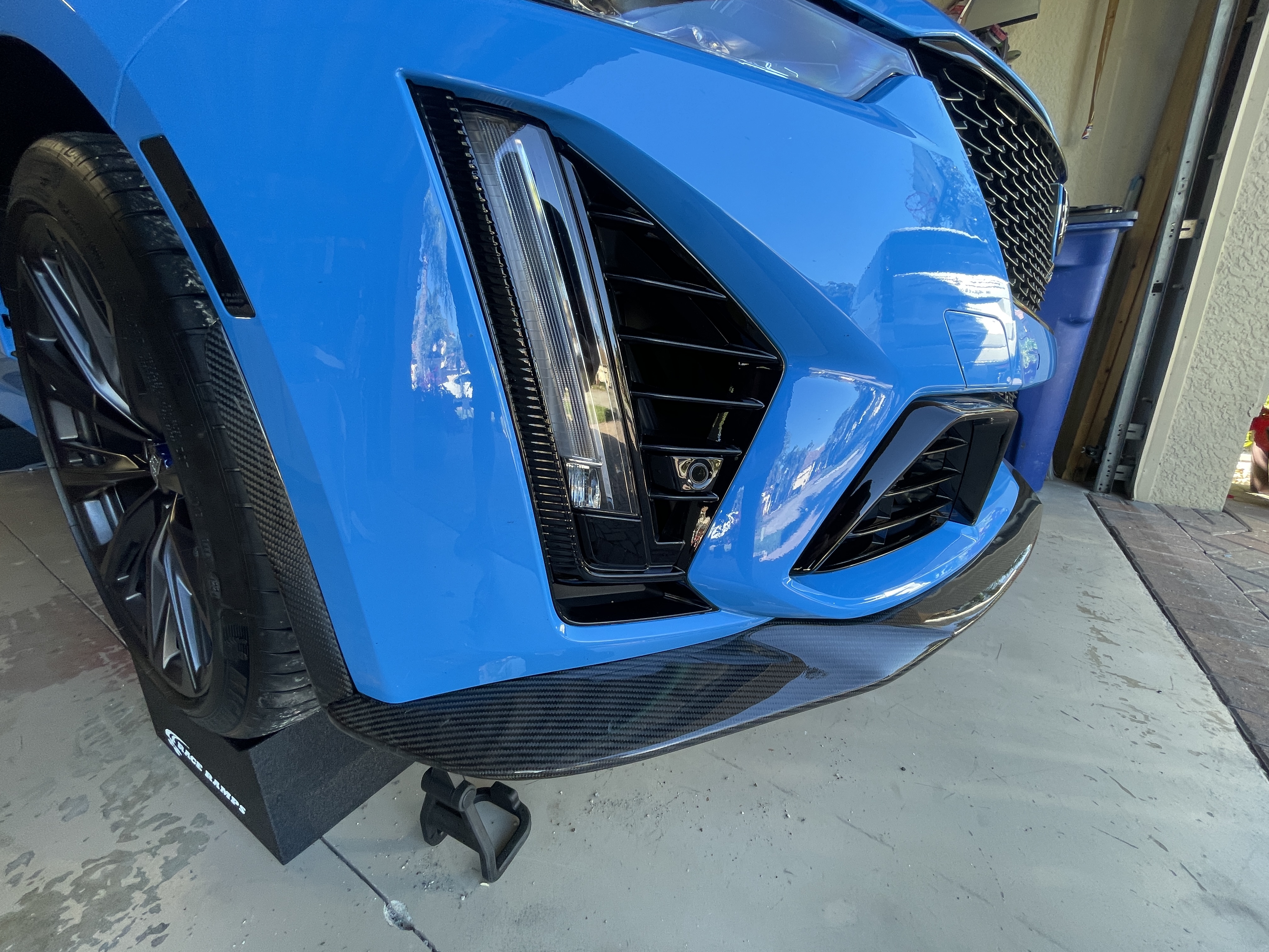

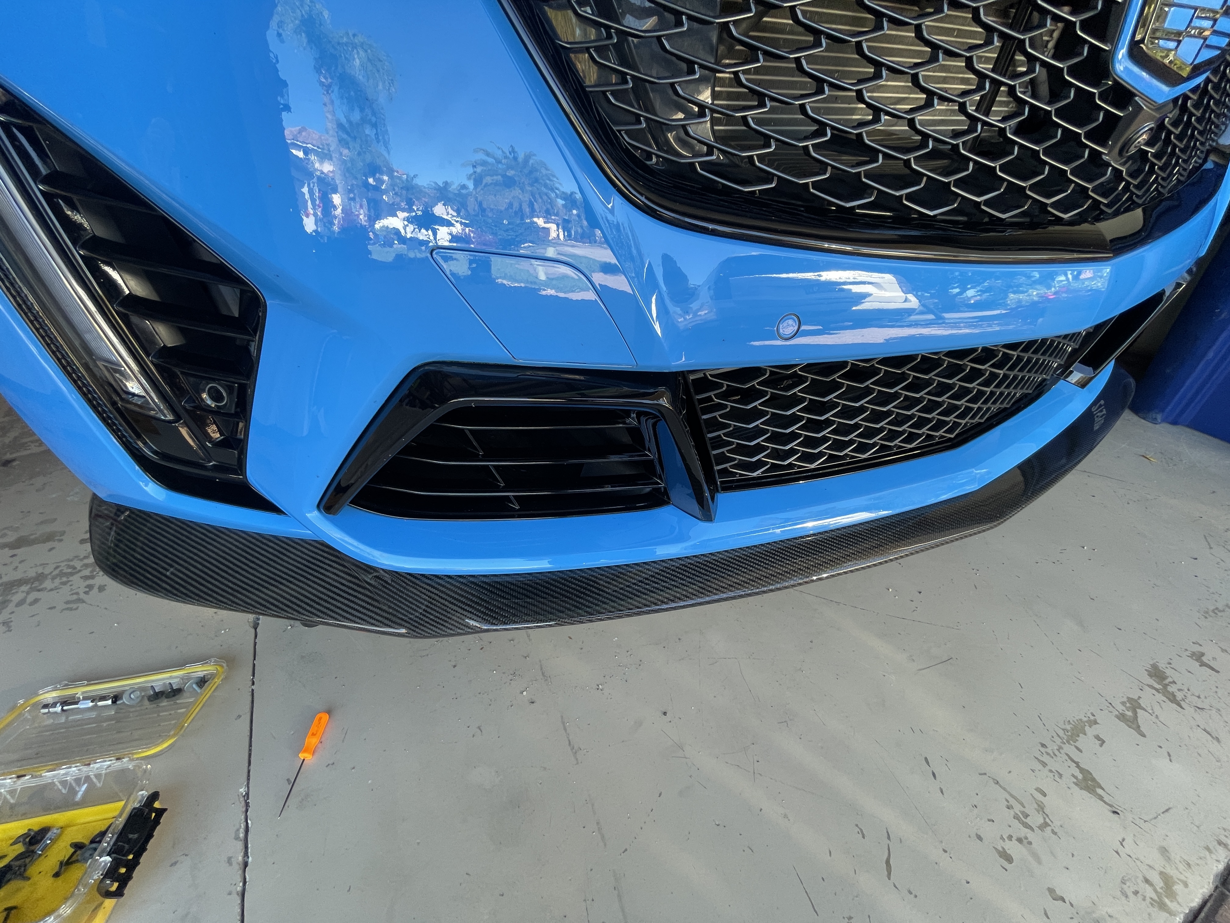

Progress being made…one side skirt off. Three panels, two rubber diverters, 52,000 screws later, the front spoiler is installed.
btw: It took forever to find the rocker clips on the GM parts page, mainly because they are labeled as a multi-purpose retainer, nothing about rockers, fenders, etc. GM charges between $7-$11 per clip. I got 30 for $8.99 on Amazon. I've broken one already but I'm going to replace them all. There's about 10 for each skirt.
