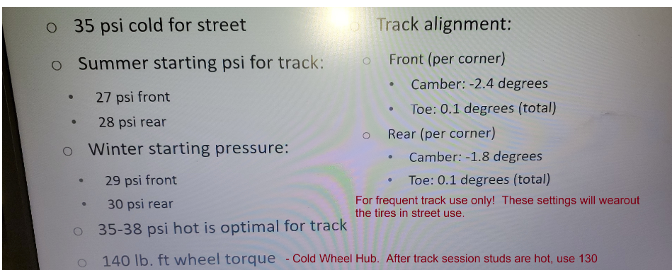

I had to go on a treasure hunt in my PC for this one haha (please see SM specs in pic above)
All PSI readings assume OEM tires (the shoulders on TPC spec tires are from a cup 2 and are specific to the BW)
Lower the starting pressure for track use - it should increase to 35psi when all warmed up. These will vary slightly depending on the ambient temps & surface conditions.
This is just my opinion: Leave any alignment adjustments to a qualified service department unless you have access to the right laser equipment and really know what you are doing. I learned early on that not all service departments are equal with respect to servicing your BW - find one you like (and can trust) if you plan on running it on the track.
In my experience, the steel brakes on the 4BW are incredible as is, with my only gripe being the immense amount of brake dust. I have seen some guys on here running alternative brake pads, but I can't speak to any perceived benefit of doing so, aside from less brake dust.
Thanks for the specs on pressure. It is obvious my tires were over inflated during my run, I'm sure that didn't help.
