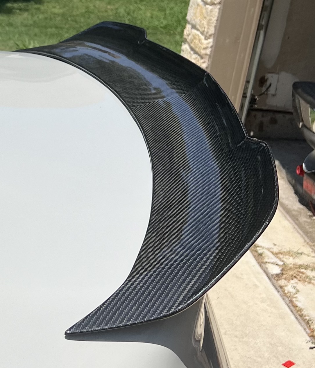

I have a 2024 4BW. I don’t have the carbon fiber packages and hence I have the base rear spoiler. While I’m not interested in the carbon fiber packages, I do really like the look of the rear spoiler that comes with those packages. Does anyone have any experience with removing the rear spoiler and adding a new one? Savage cadillac seems to have the upgraded spoiler and id love to fit itbut I I’m not sure if this is just a 3M tape removal with a bit of heat and fishing line similar to a debage or if this thing is actually bolted to the car.
You will need to remove the trunk liner and remove like 7 nuts that secure the wing. Theres is 3m tape as well you will need to clean up. It’s not too bad of a proces. Be careful removing the the trunk liner as the clips may come loose from the liner. Support the clips as you pull them. I had two clips come off. I ended up securing them with 3m tape when I put it back together. This is the tapout carbon wing.

Perfect. Looks great! Thank you!!!
