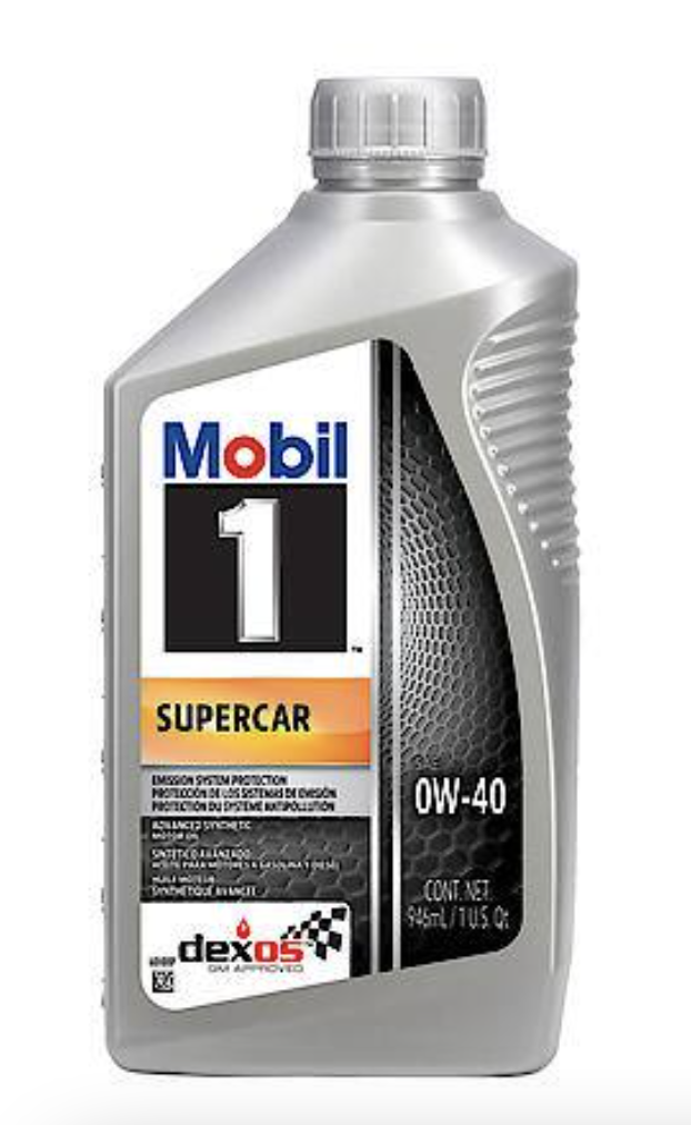

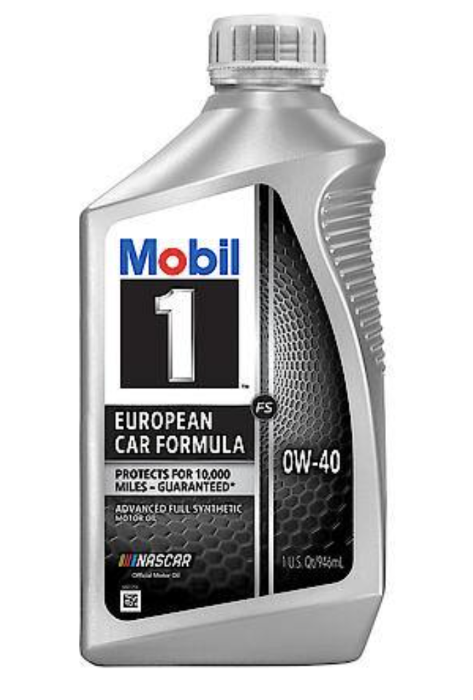

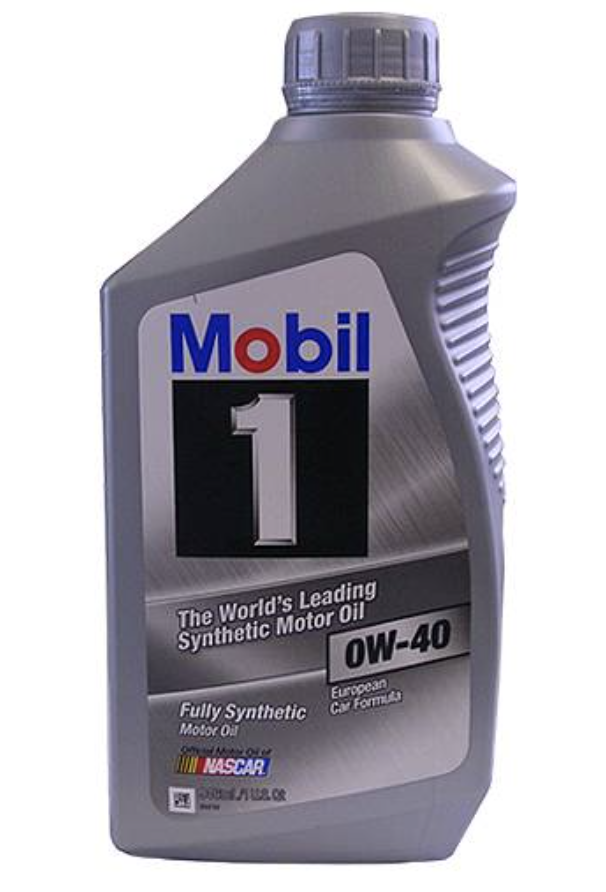

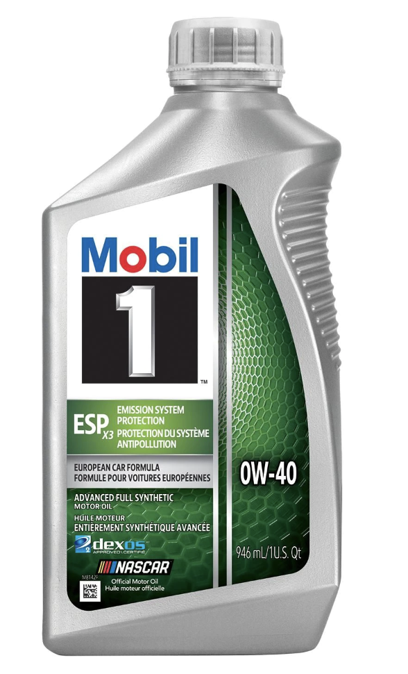

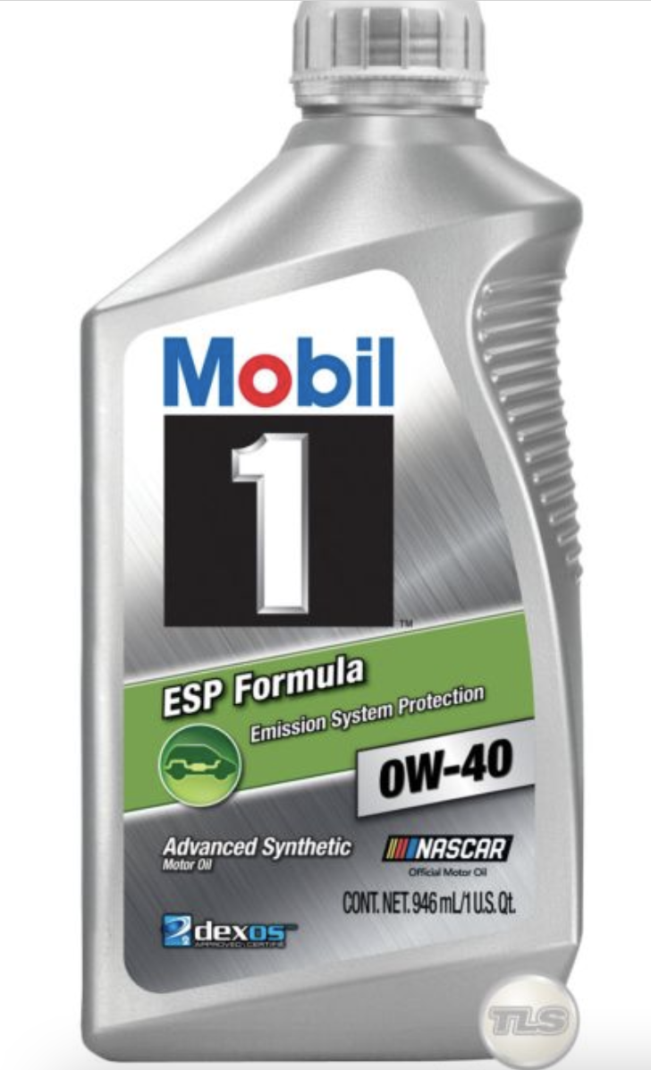

Very frustrating... Here are some pictures that may help since there are multiple versions of this stuff and it can be confusing. The key is making sure you get Dexos2 in the LT4.
Correct - new Supercar branding

Correct - US Version

Correct - European Version - same as above with some added stuff to meet Euro emissions standards.

Not Correct

Not Correct
Not Correct
Not Correct
nice add to the discussion. the big thing is whether or not it says DEXOS 2 anywhere on it if you don't want to try and memorize which image = okay and which = not okay

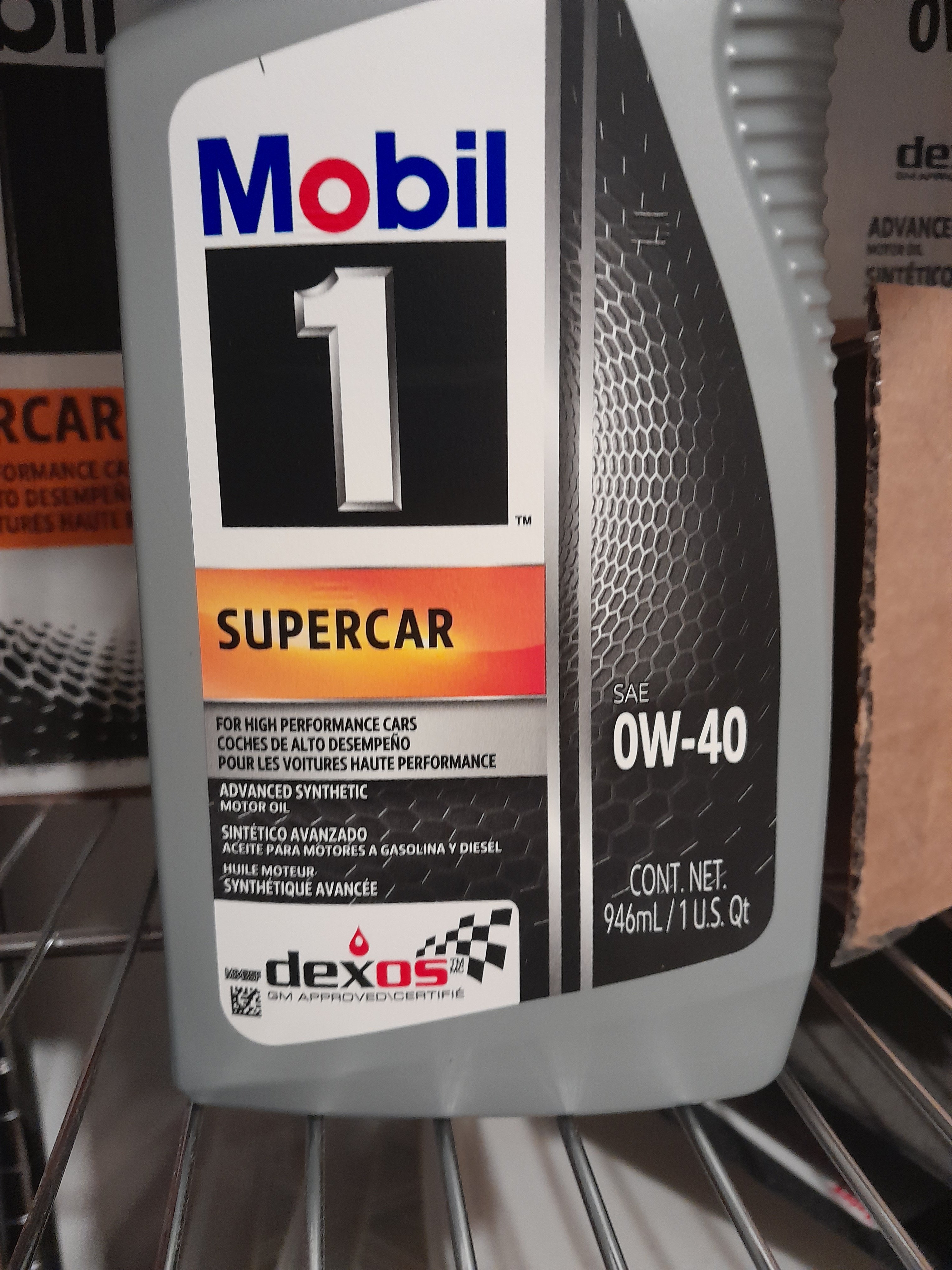

Problem is that the new supercar branding got rid of Dexos 2. It's Dexos R now. Just to make things more confusing.

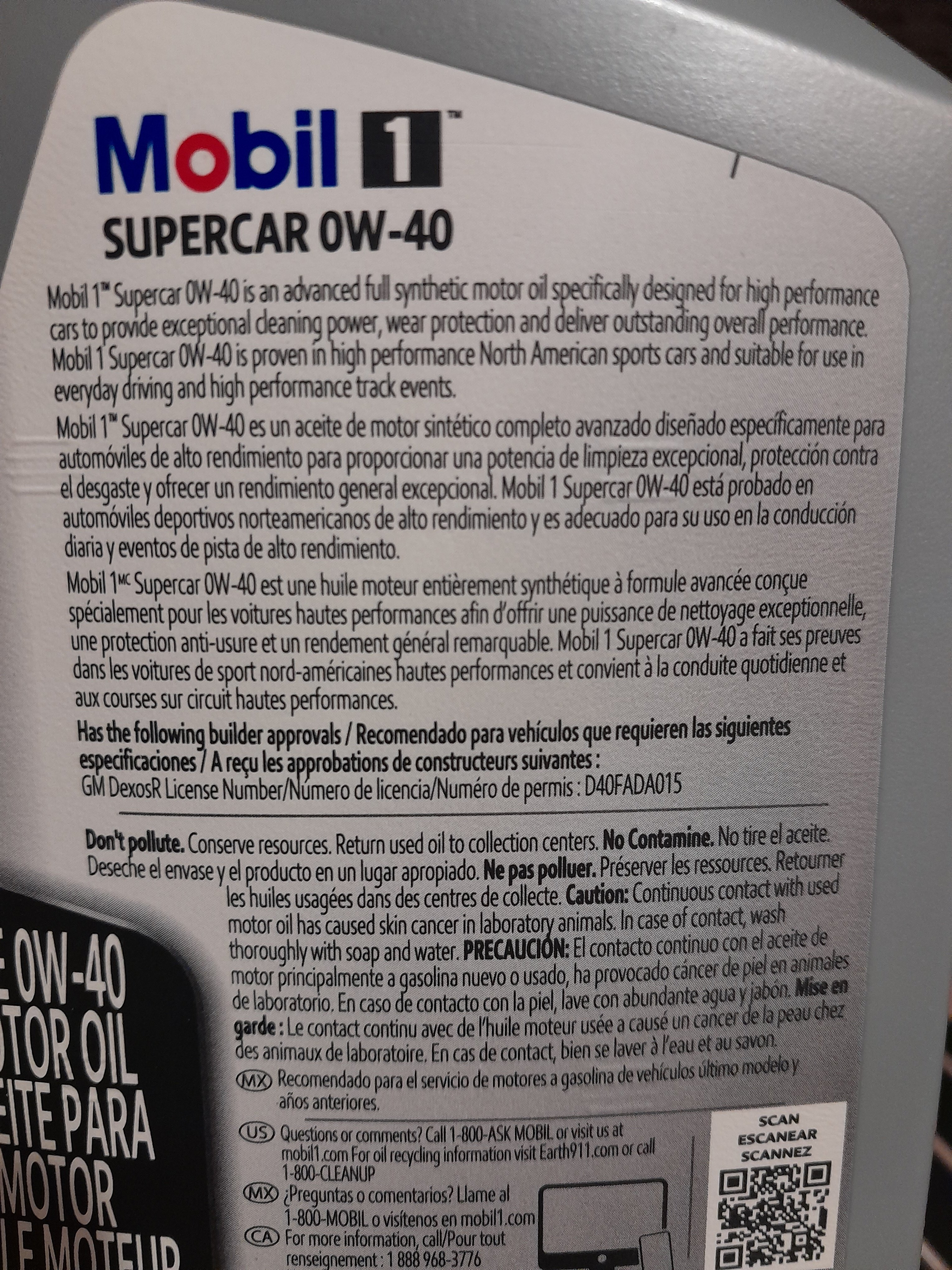

I just received my mobil1 supercar oil this week. I was kinda surprised that it only says "dexos" on the front/case, no "2" or "R". Only on the back does it show something in regards to DexosR with the license number.
