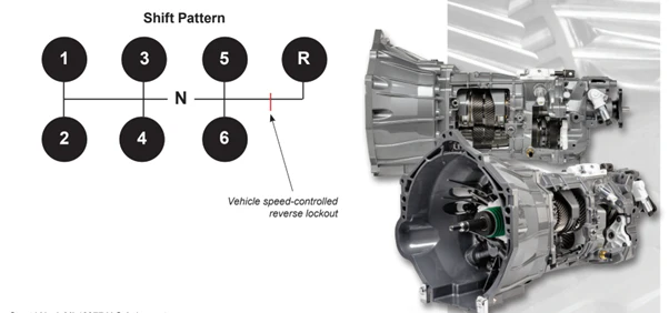

Would someone with an M6 (I have a CT4 but I’m sure 5 should be the same) mind sanity-checking me that the tremec has a reverse gate lockout at highway speed?
For example, if I’m going 50 in fourth and push selector all the right in neutral, straight up should be 5th and straight down 6th, right?
At around 8k miles and the above scenario is allowing the selector to reach the far right reverse gate. Straight down does not select a gear (as there’s no gear below reverse) and unclear whether the car would actually allow me to select reverse at highways speeds (I’ve been avoiding fully entering that gate, but I sure hope not…)
Quick google seems to indicate a solenoid in the trans regulates the reverse lockout, so I’m assuming I have a faulty one that would hopefully be covered by warranty if this is in fact an issue.
Curious if anyone else has experienced this, or if I’m crazy and the transmission has always been this way and I’ve just never noticed because my 4>5 shifts have been perfect to this point (unlikely)

Yes, I have a 22 CT4BW. Especially at highway speeds it shouldn't allow you to shift all the way right to go into R. For me, it stops and only gears are up to 5 or down to 6. I back into my driveway and garage and I've noticed even at around 10 MPH it wouldn't allow me to go into reverse until I'm closer to 5 MPH.
The T6060 definitely has a reverse lockout solenoid and it's default position is locked out, so if it fails it should make reverse difficult/impossible to engage. Why don't YOU check if you can find reverse on the interstate, haha. If you're really ham-fisting your 4-5 shift you might be getting tangled up in the lockout mechanism. I would practice better technique and go from there.
Certainly not asking anyone to find reverse on the interstate (sorry if it came off that way). The whole me checking my own potentially faulty transmission kind of defeats the control group comparison I was asking for in the forum, doesn’t it?
What I’m asking is whether the reverse gate is accessible for anyone else at speed, not the reverse gear (i.e., if you select all the way right in neutral and pull straight down, do you find 6th or are you locked out because you’ve accessed the reverse gate?)
Reverse is still easily accessible when stationary, so I am thinking there may be a dual redundancy (one lockout for access to the gate and a second safeguard lockout against actually shifting into reverse gear). See attached image for the lockout that I think is at play here.
I can still find 5th just fine, I would just prefer to push out to the right on the 4>5 shift and be able to rely on that lockout to foreclose the potential (however slim) of a 4>3 money shift.
I have an '07 Z06 (T56) and my reverse lockout solenoid started sticking in the retracted position. But that was north of 80K miles and I wouldn't expect a similar failure of OPs '24 (unless his solenoid is defective).
Reverse on my 5BW doesn’t unlock until you’re damn near stopped. I’ve found that out when trying to get into reverse when parking and still rolling forward a few mph.
Also my reverse is locked out when the car is off so that to me would confirm the thought that reverse is normally locked out and the solenoid needs to unlock reverse.
Yea-this is what I was trying to say.
Just in case anyone else runs into this issue, finally got around to bringing my car to the shop and it was a simple solenoid replacement (covered under warranty).
Link to part:
You reference part 24280288. I suspect that's a 19178634 plus the right angle adapter. It's the part I put in my 2007 Z06 when I noticed it wasn't really working.
This lives on the top of the trans and wasn't easy to swap; I ended up removing the entire assembly and replacing the solenoid on the bench.
