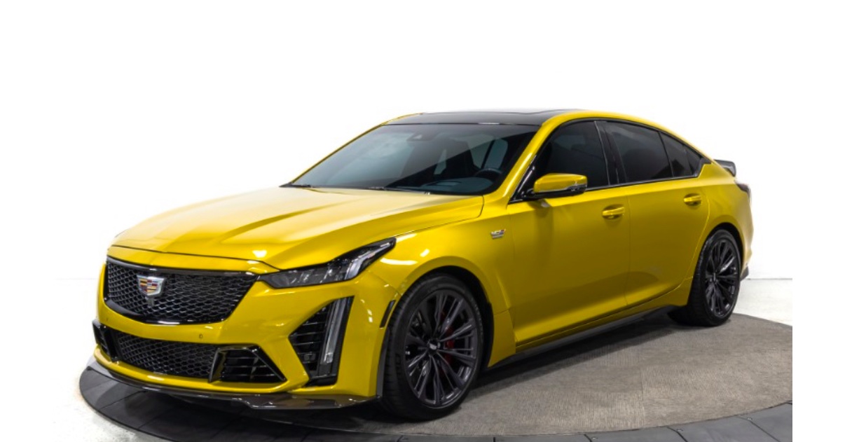

New member here and my “new to me” CT5 Blackwing will be arriving in about a week. It’s a 2024 Cyber Yellow with manual. Coming from my last GM car which was a C6 ZR1, I’m somewhat familiar with the engine/platform and want to do a couple things to increase power. Not looking to do anything extreme like heads or cams, mainly looking to do a couple tweaks to unleash some easy HP. In some searching, seems the new group B ECU has the ability to learn and not throw CELs with certain bolt-ons. Reading and watching a few articles and videos, looks like the Kong ported supercharger and drop in filter can add up to 60whp and still maintain a safe AFR. Before I go and do this, wanted to see what others in the blackwing community have to say about it and if there’s a different path or any issues with this approach. I’ve usually always just tuned my cars, but the unlocking and hassle of doing this with the new ECUs is making me not want to deal with that unless I really need to. Thanks in advance.
