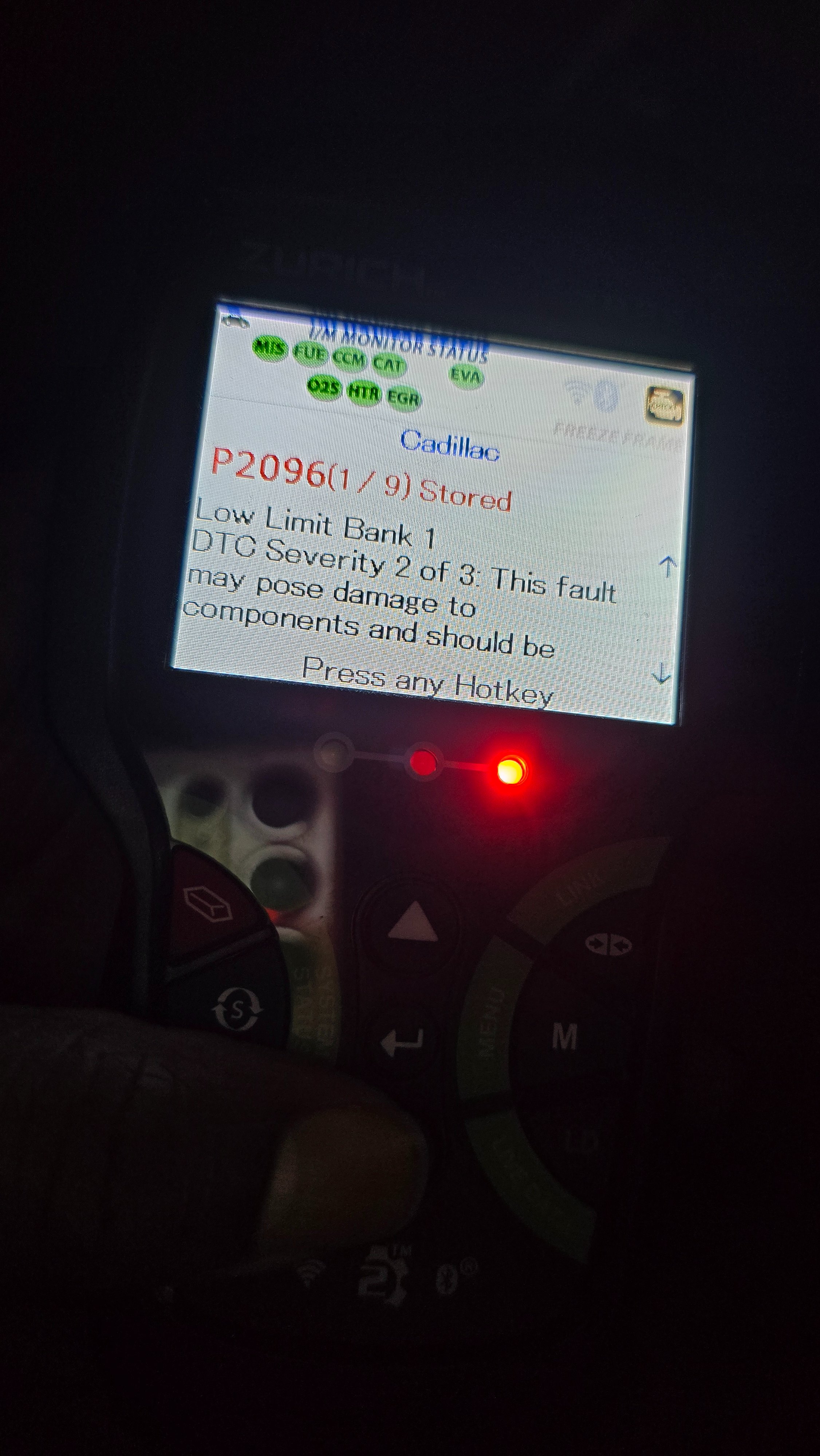

The code came back
P2096 is a PITA code as there’s several things that can trigger it. Are there any other codes? Have you checked the O2 sensor after the cat? You can back probe the sensor with a multimeter, with engine on, set the meter to volts, should fluctuate between .1~1.0. If it’s a steady voltage, no fluctuation, or no reading, the sensor has a problem. If that’s good, perhaps check the MAF, clean it… as well as checking vacuum hoses. That’s where I’d start without a secondary code to help narrow the scope.

Since you got a scan tool, check if it does live data, depending on the scanner you have you may be able to see this data without getting under the car.
With the scan tool, go to live data, (I only see bank 1, no sensor number from your photo), go to the corresponding sensor. It may give you mA or voltage, if mA, the sensor reading should fluctuate between -2-1.5 range, 0 is good. Voltage will generally be between 0.1-0.9. With engine running, pump brake or give a couple revs, fluctuating is good. If you can see the LAMBDA for the sensor, 1 is good but should also fluctuate. If no fluctuations and the voltage/mA is pegged, out of range, not changing, likely a bad sensor. You could quickly check all sensors while you’re there if live data is available.
