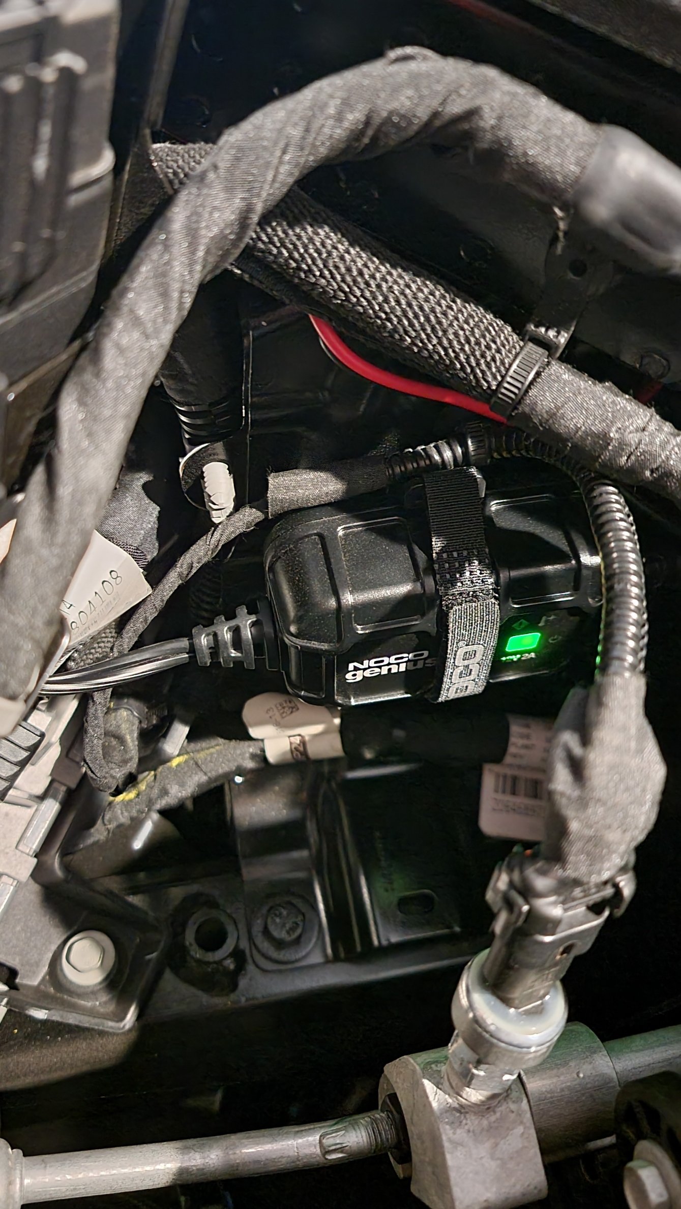

Understand that the car has been started and stopped many times in that 800 miles. Around the plant, on and off the truck, dealer movements, and whatever short trips you have done. It takes a lot of steady state driving to get a battery back to full charge after that. If your car is a weekend warrior, then I strongly recommend a maintainer. I know some folks have a battery filled with unicorn juice and they never fail, but a maintainer will prolong the life and keep weird conditions like you describe from being a thing.
NOCO makes a permanent vehicle mounted maintainer that I hard wired to the lugs under the hood. I run a cord to it and close the hood to the safety latch status, then cover it.
