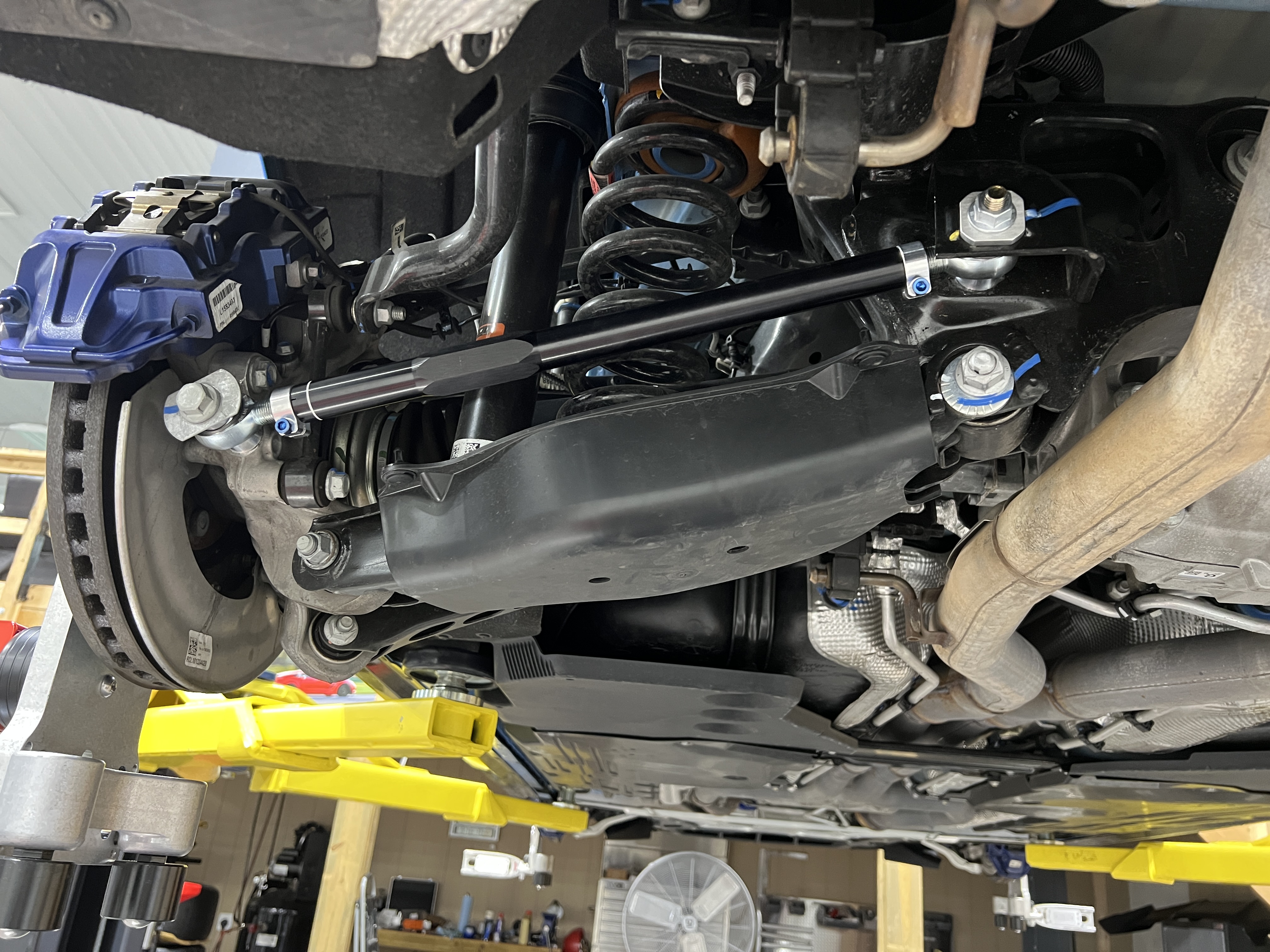

I've confirmed that the SPL rear toe links for the Camaro work fine for the 5BW. Without them, you won't have enough toe adjustment to get the requisite camber. SPL part number is RTAEL CAM6 and you'll also want to get new inner toe link bolts since the factory ones are single use - they should be GM part number 11609598. You're also supposed to replace the camber eccentric bolts, which I did - GM part 11547215.
Did you just get the toe arms or also the eccentric lockout kit? I had both on my 1LE. Was happy with them.

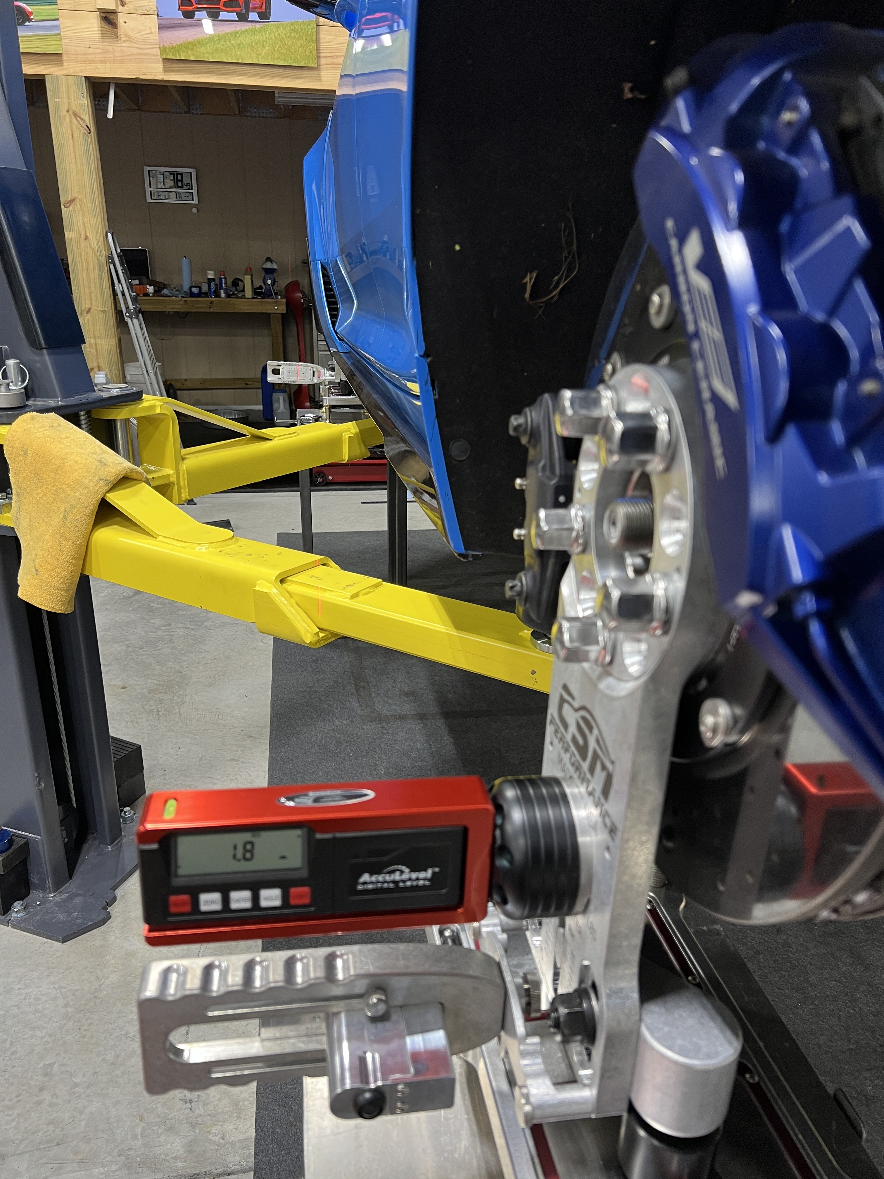

3) cool tools too (alignment jig)

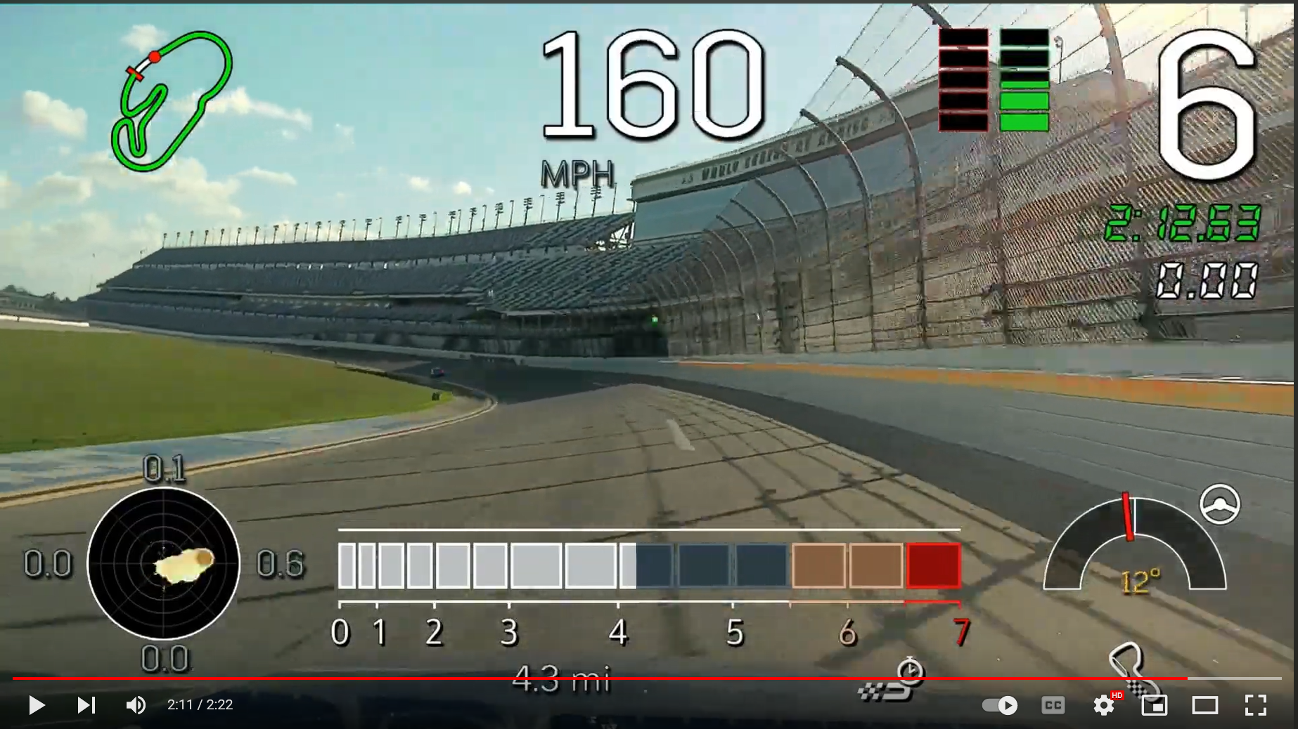

iv) I love VIR too, but I ain't gonna do 160 in a street car
I'm just a pussy, that's OK, I've accepted it.
You won't die. Promise. :D
Hell I did 160 in a 4th gen Corvette in a public road and lived to tell about it. Of course that was during the Pony Express a whole bunch of years ago, but who's counting? ;-)
