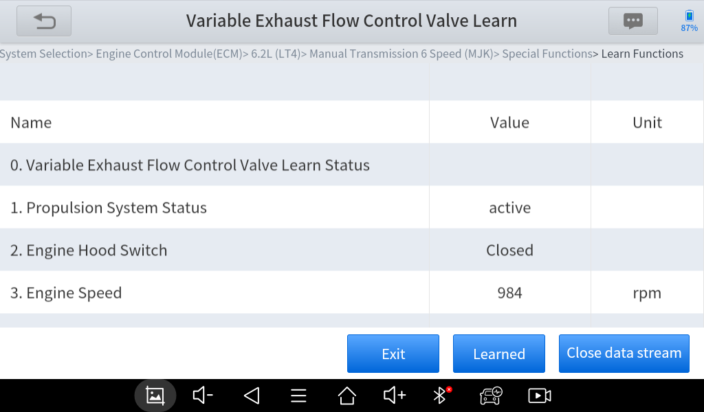

I hooked up my scan tool and within ECM > Special Functions I have an exhaust valve relearn option.

I’m using a Xtool D7. This one runs about $300, well worth the money.
There’s many different scan tools out there but look for one with bidirectional capabilities (allows you to actuate different functions like valves, pumps, etc.) and special function support.

This is heavily dependent on the tool (which scanner?) itself. Look for bidirectional or special function option. The exhaust valve relearn function should be under the ECM tree.

If you purchased the 2024 LAUNCH Creader Elite for GM, I was able to use the following video that walks through the steps for the C8 Corvette:
Of course, you'll need to change the steps just a little bit to select your vehicle (instead of the C8 in the video), but the steps are generally the same. The only thing that I noted that was materially different was that there was only one relearn function required. In the video, there are two - "cylinder deactivation exhaust control valve learn" and "exhaust control valve learn" for the Corvette. However, for my car there was just one exhaust valve learn function available. If you need any additional help, feel free to direct message me.
Yeah, I ended up watching the C8 video. I was using the same 2024 LAUNCH Creader Elite. I realized a few lessons, so I figure I will share with others as well:
1. My reader was not instant to fully recognize the make/model/VIN
- it took a few tries before the auto scan features fully recognized the vehicle and all supported modules
- once it recognized, I saw what I was expecting to see
2. Specifically for the Exhaust Valve Relearn, don’t select in and then hit learn
- when you navigate to the valve learn screen, just press learn. Do not press on the valve module again before hitting learn. It will not work properly.
