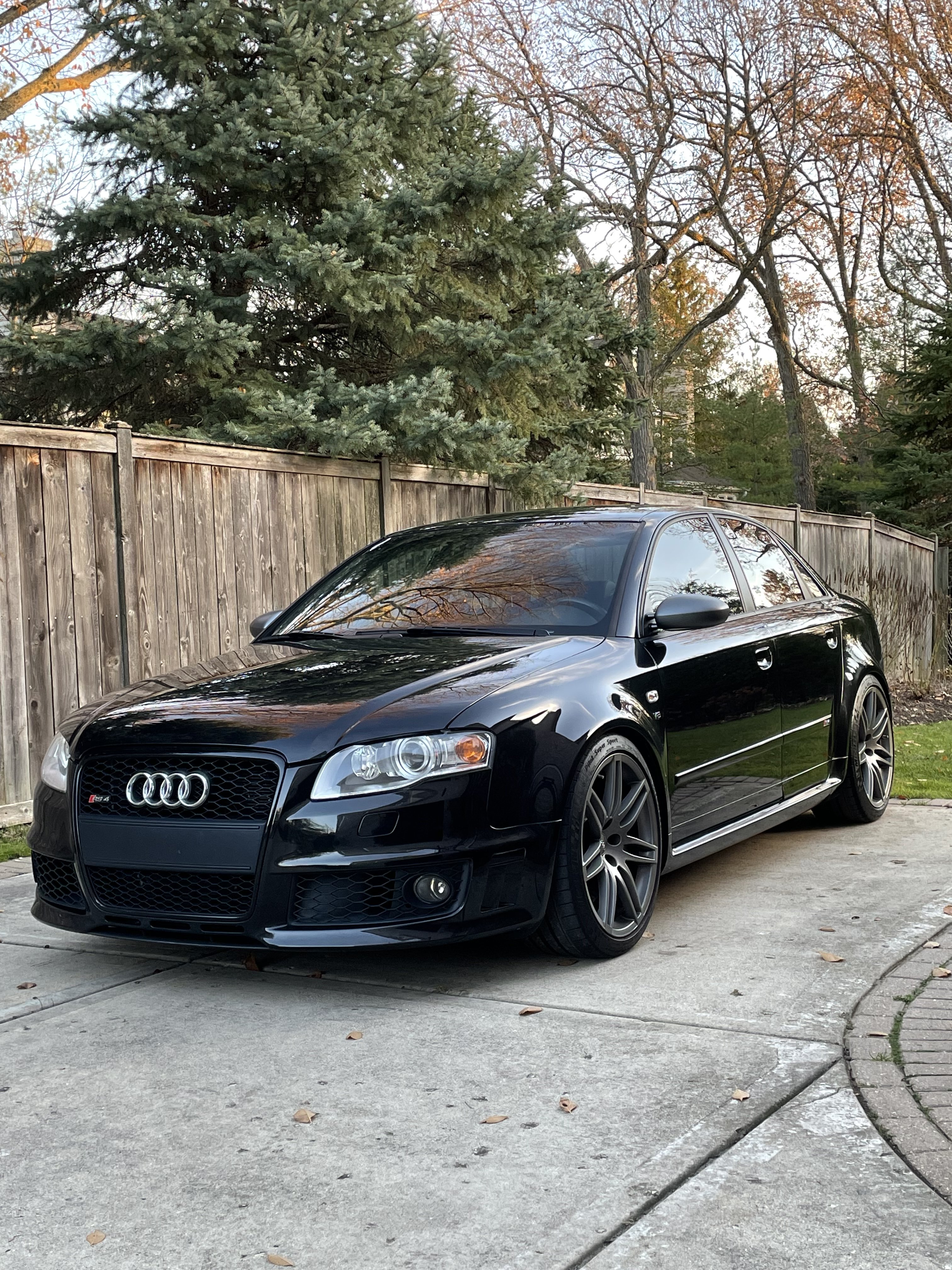

You are making me not want to buy a 5BW and cherish my RS4 more and more.
Keep both if you can until you’re sure the 5BW engine is good. I still have my RS4!
