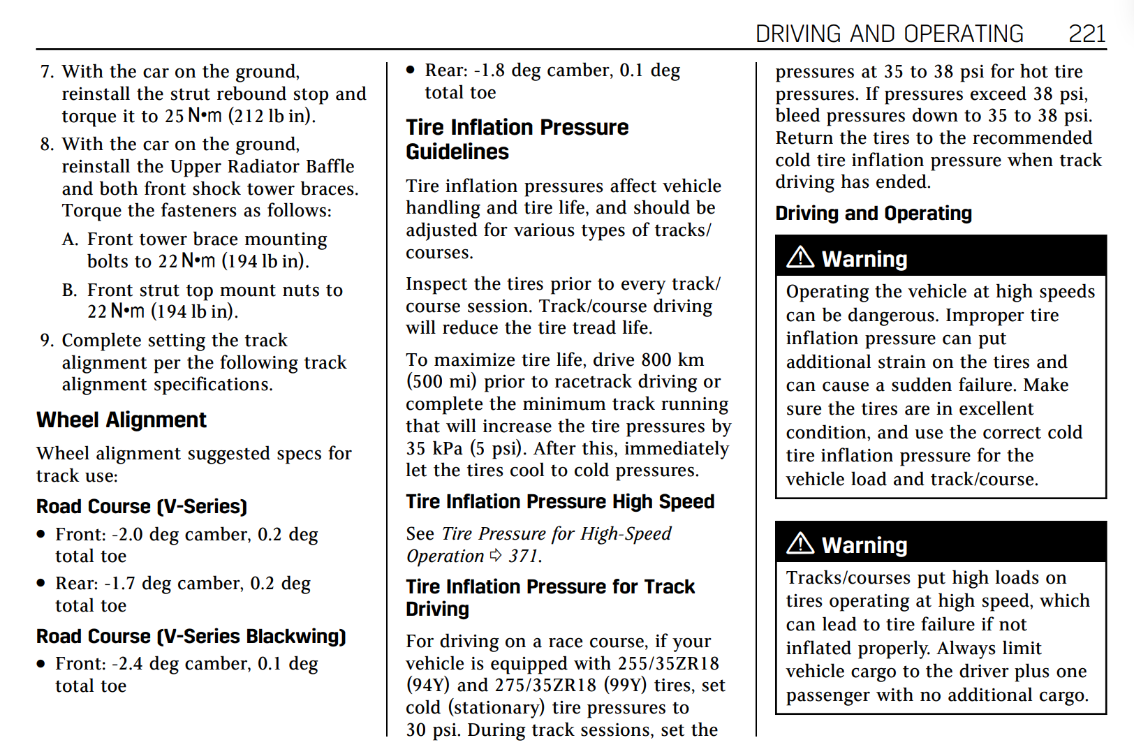

As for tires, I've only run the OEM tires. They are fantastic as long as you keep them in the 34-38 PSI range. Above that, they get greasy. If you haven't driven the car on track before, just run OEM tires. I put a new set on at the beginning of this year and the fronts started chunking on the last day of the last event, so they have a pretty good run life.
