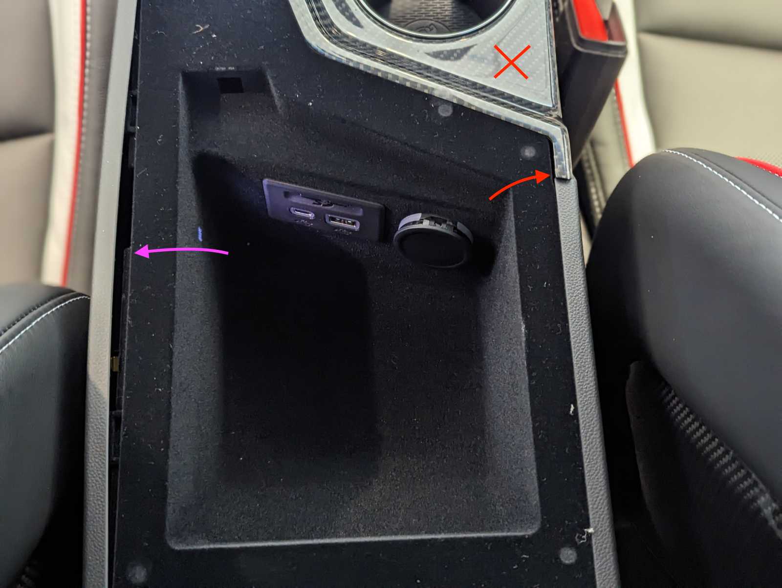

Hello Everyone. Does your console look like this?
My did. And, so does the new 2023 at Smail Cadillac. What are the odds that they were poorly cobbled together in the exact same way(?)
Nonetheless, the section with the purple arrow snapped together with little effort. For the red arrow, the clip underneath refuses to seat. After a few bending attempts, a small piece of a toothpick placed in the bottom of the clip did the trick. It snapped exactly into place and is holding. (yes, a toothpick was used on a premium automobile to fix a console and avoid infinite trips to a dealer. Good thing that there were still 4 in the box.)
