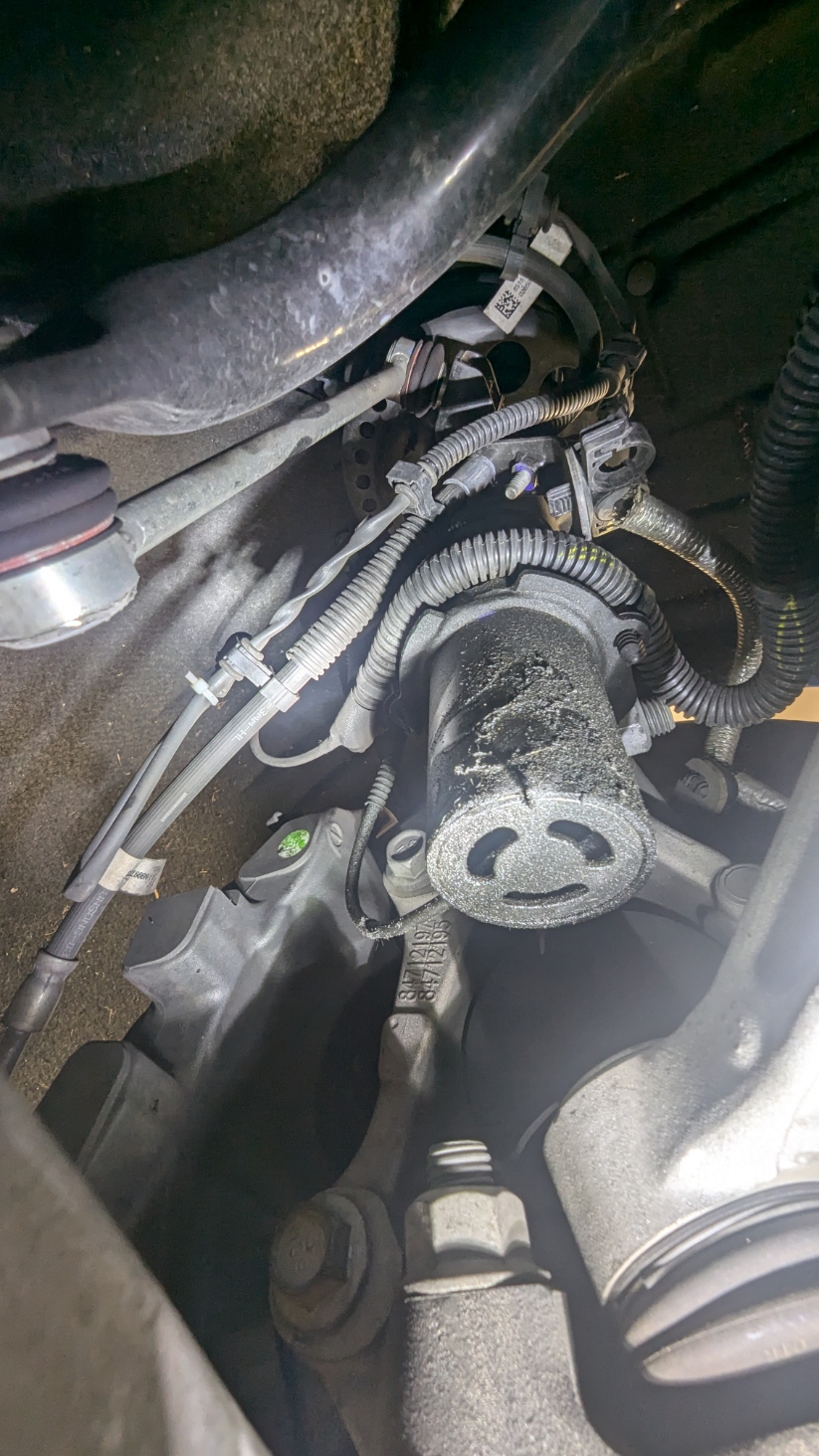

4bw 24,000 miles. I developed a noise like something is loose under the dash. It seems to be suspension related and is very subtle. Bugs the crap out of me. Not all the time but mostly going over rough roads. happens more when going 30-45 mph and wheel slightly right. Suspension feels slightly harsher than when new. Anyway, jacked up the car and driver strut has a resevoir or something that is covered in fluid. Dont know if that's the cause, but going to get it checked out.

But yeah, that's just the bottom of your mag ride damper. Can you see an active leak? If not it's hard to tell if that's coming from the damper itself or perhaps something you kicked up.

pull the wheel off and check the strut reservoir. Mine felt like intermittent rattle/clunk was coming through the steering column. Would only happen when turning slightly right. I pulled the wheel off and the strut reservoir was covered in some sort of fluid. Dealer replaced strut and I love my car again. Here's a video of what it sounded like. It was annoying. PXL_20240805_195038095.mp4
