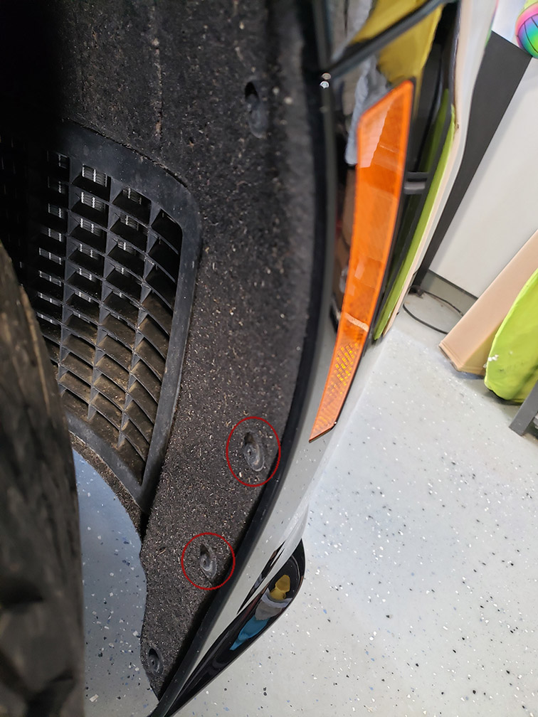

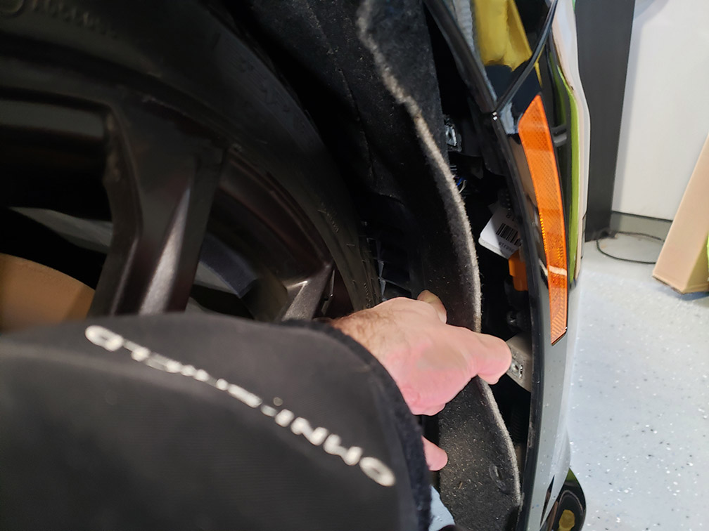

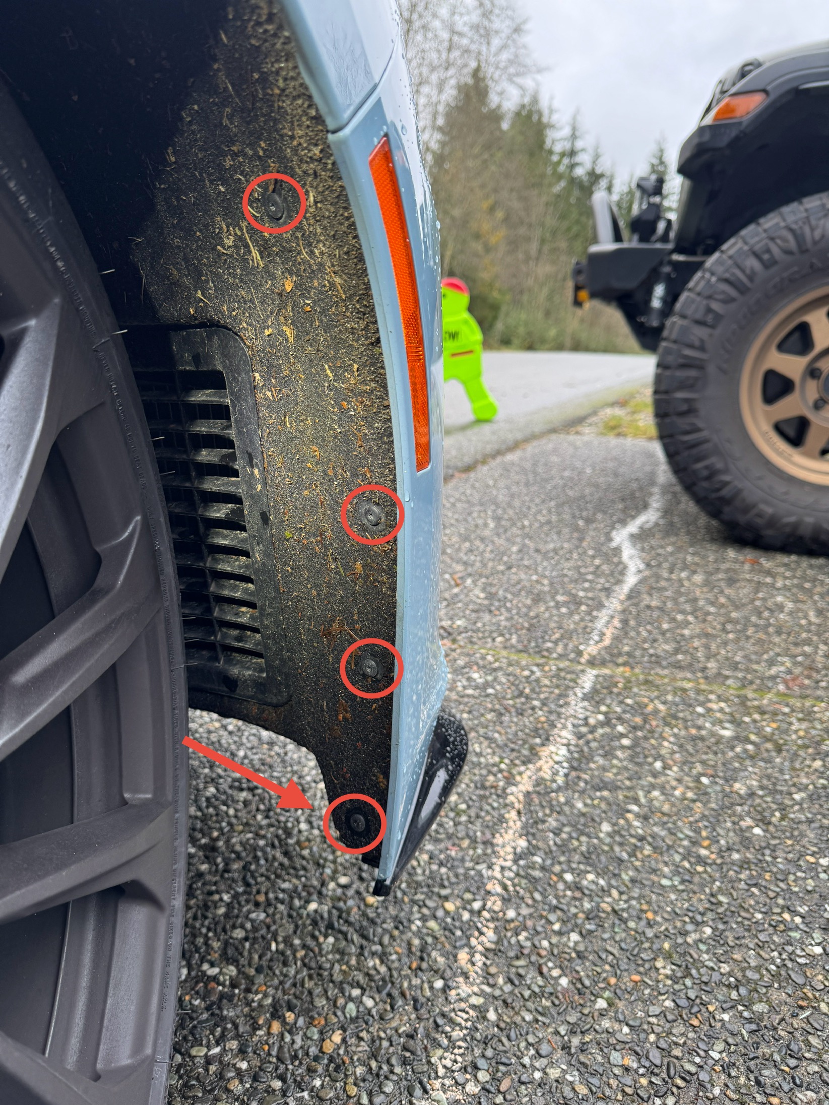

1.) Remove the first 4 to 5 wheel well screws so that you pull back the material.
2.) Pull back the material away from the fender. You want to pull it back a bit above the seem between the fender and the bumper. Using a plastic pry tool makes it easy.

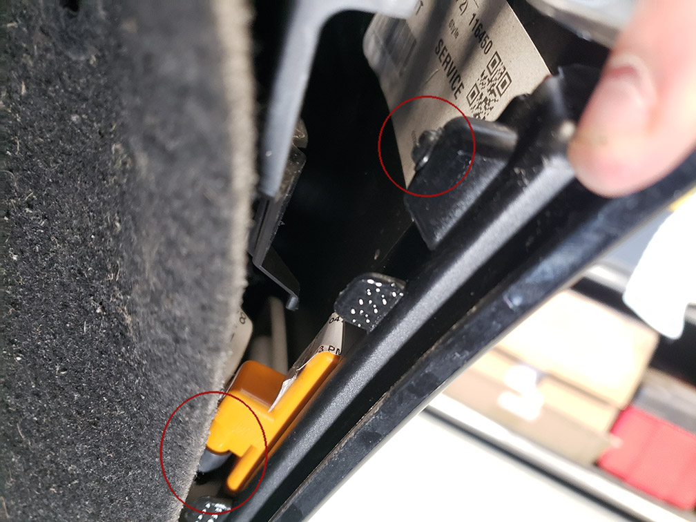

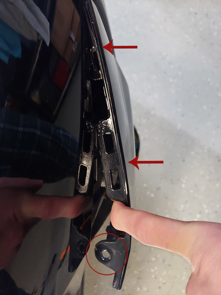

3.) Reveal the torx screw that secures the bumper to the fender. Remove it.

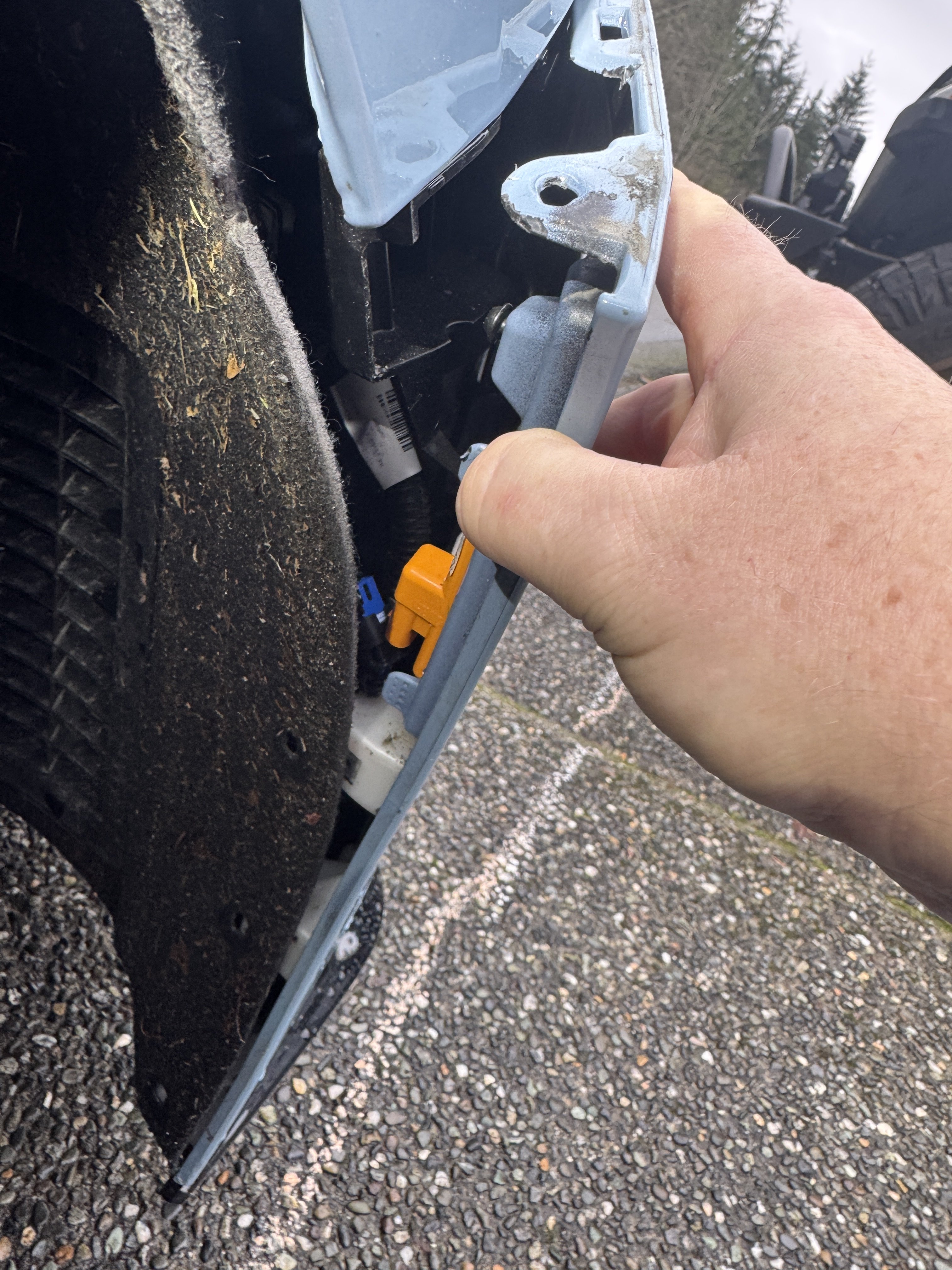

4.) Pull the bumper away from the fender. You can see in Pic4 that it's just two clips that hold it in place. they are easy to unclip by simply pulling the bumper away from the fender.

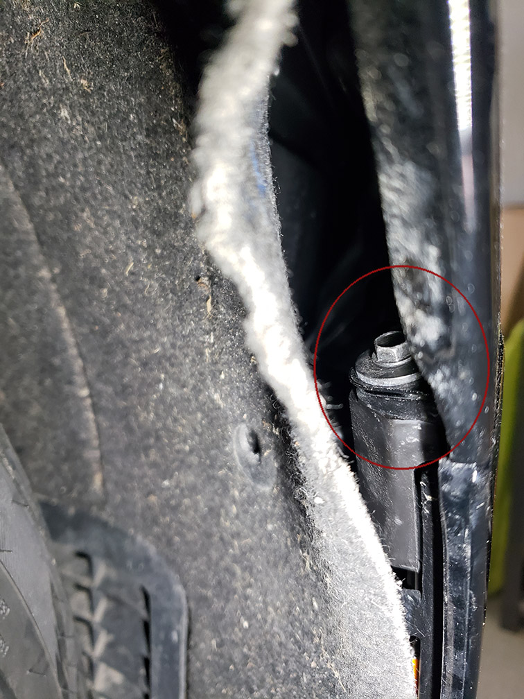

5.) Now you can get to the screw that holds the indicator to the bumper.

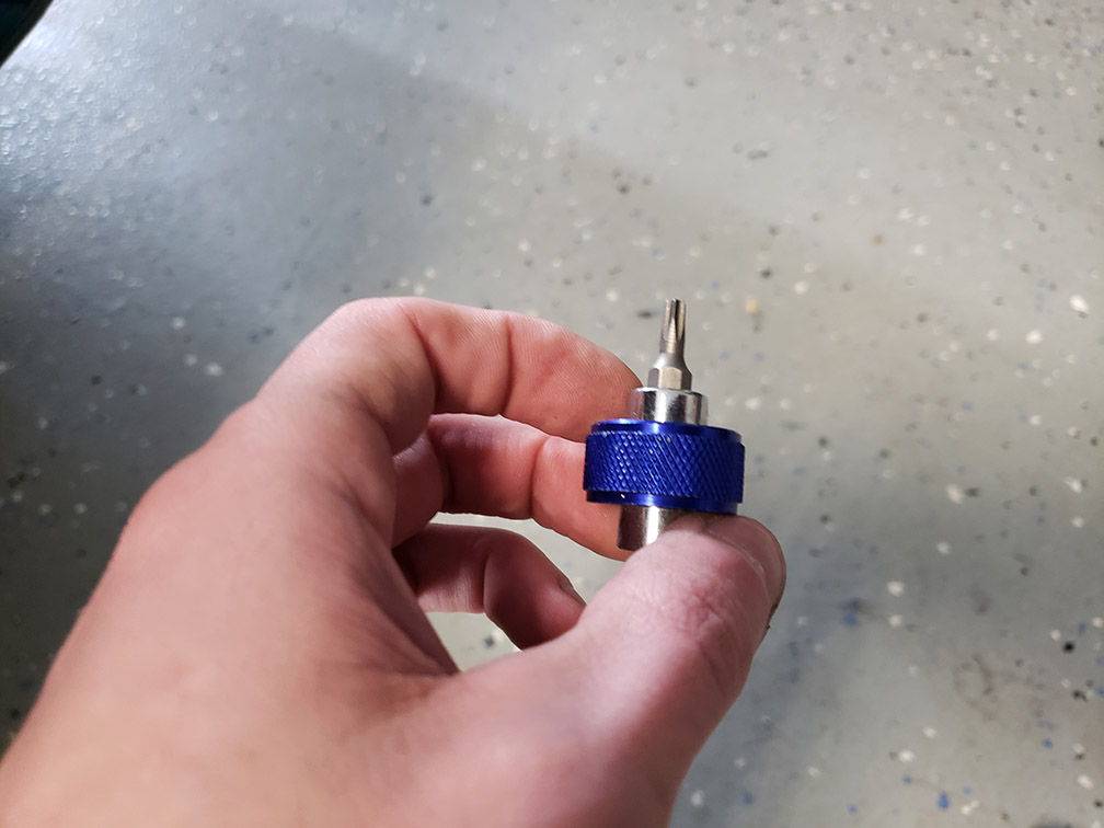

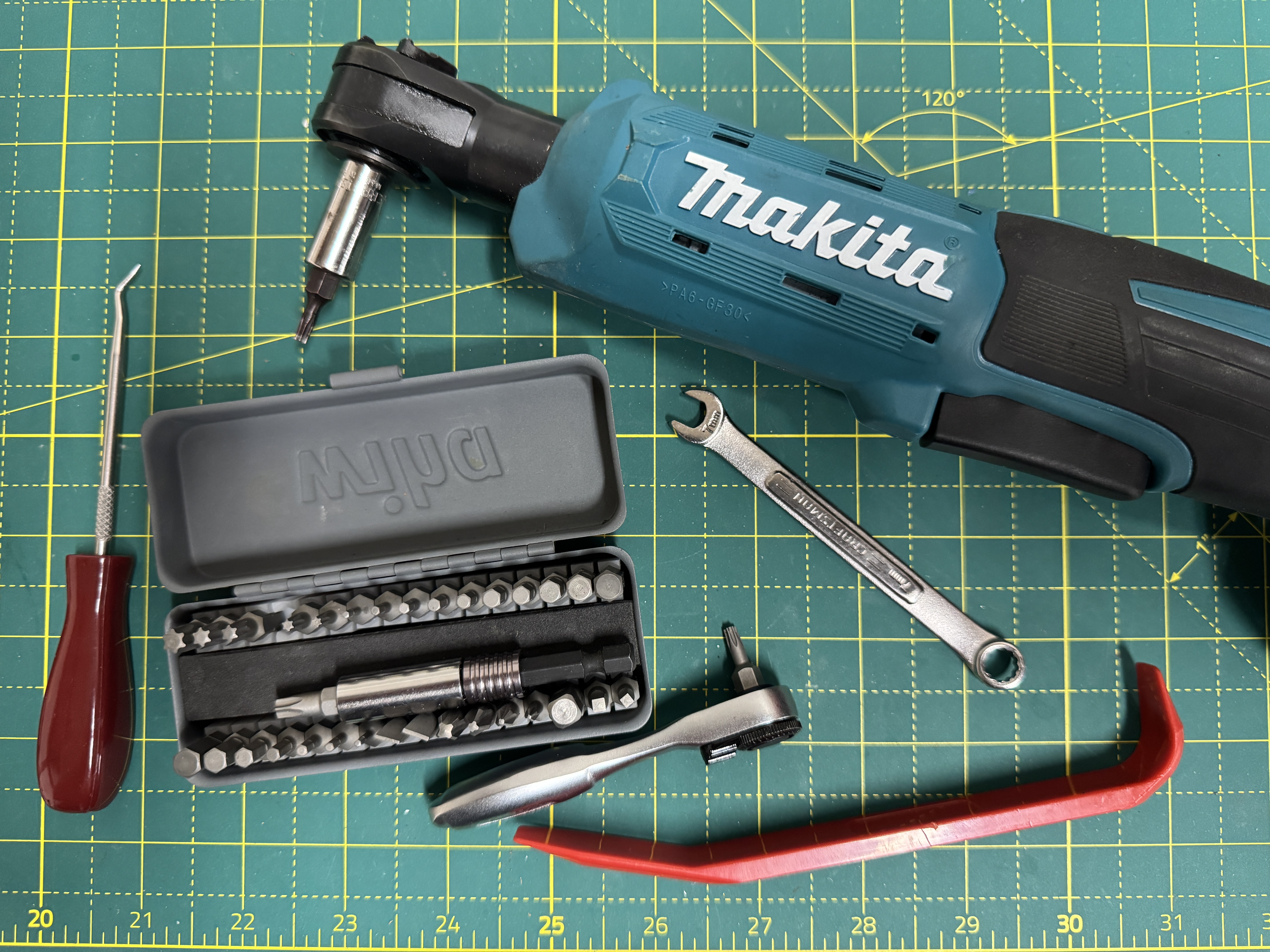

6.) I used one of these to remove the screw.

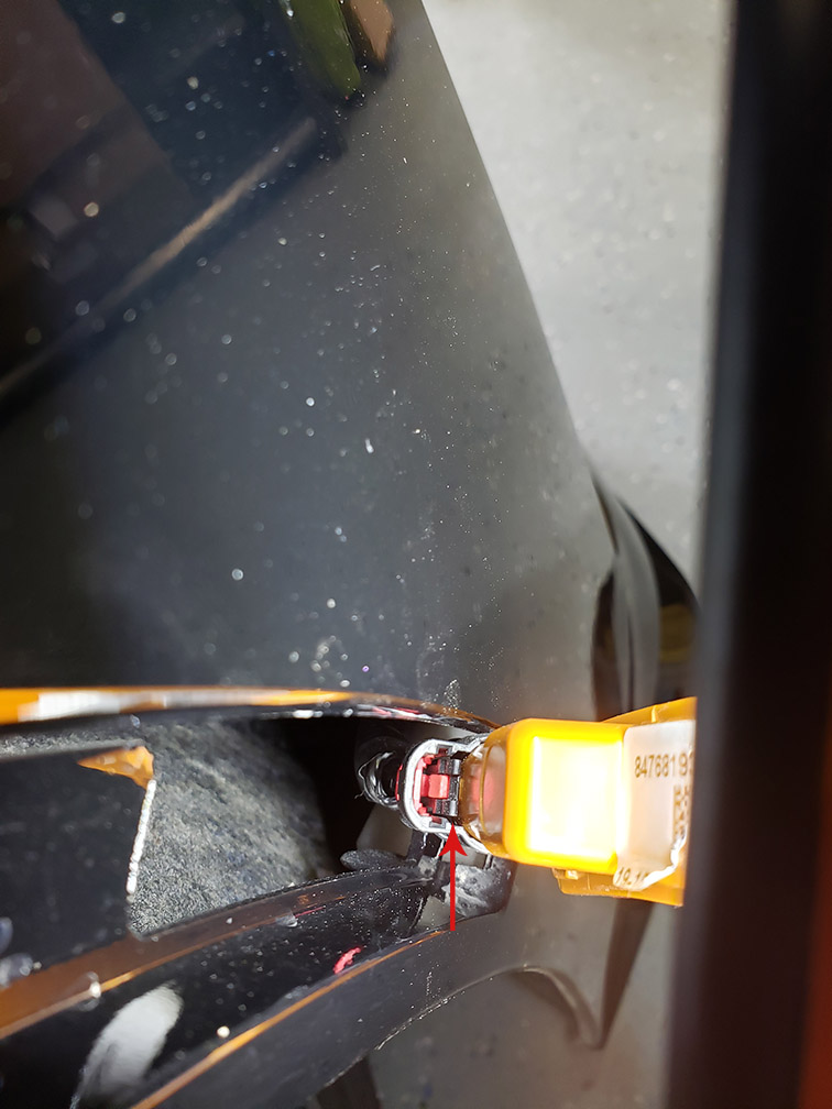

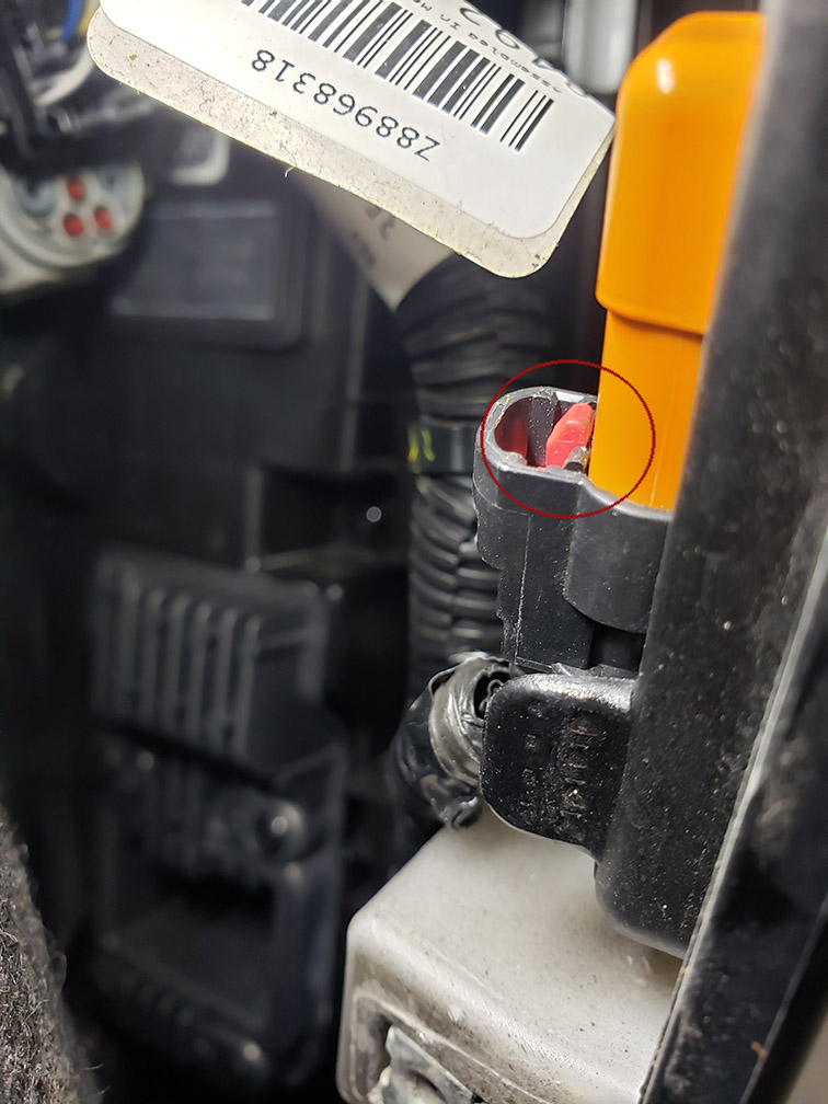

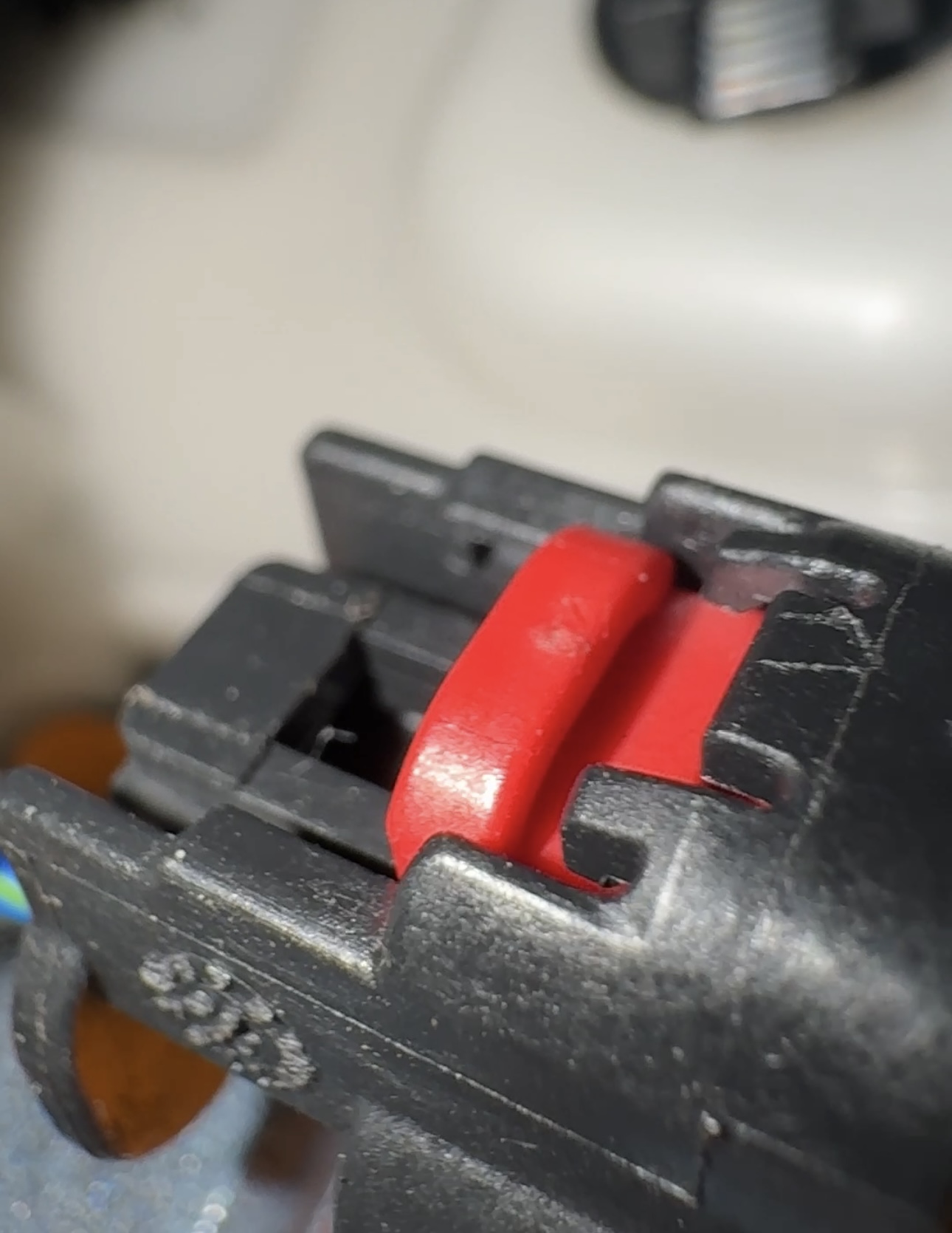

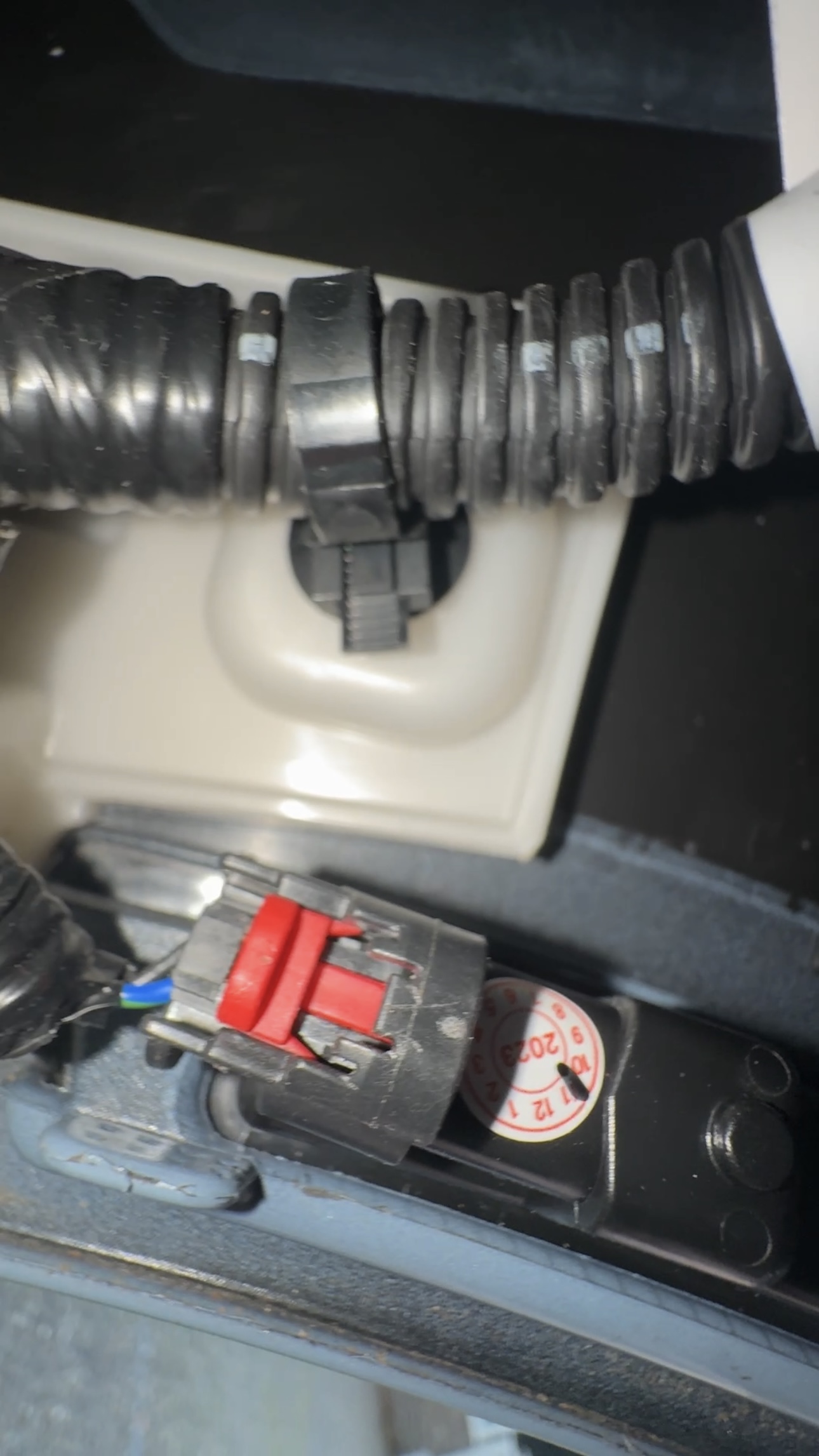

7.) You can see the clip here that connects to the indicator.
8.) I'm a bit fuzzy on this but I believe you have to slide the red clip back and then you can lift the black clip piece away from the yellow indicator body.

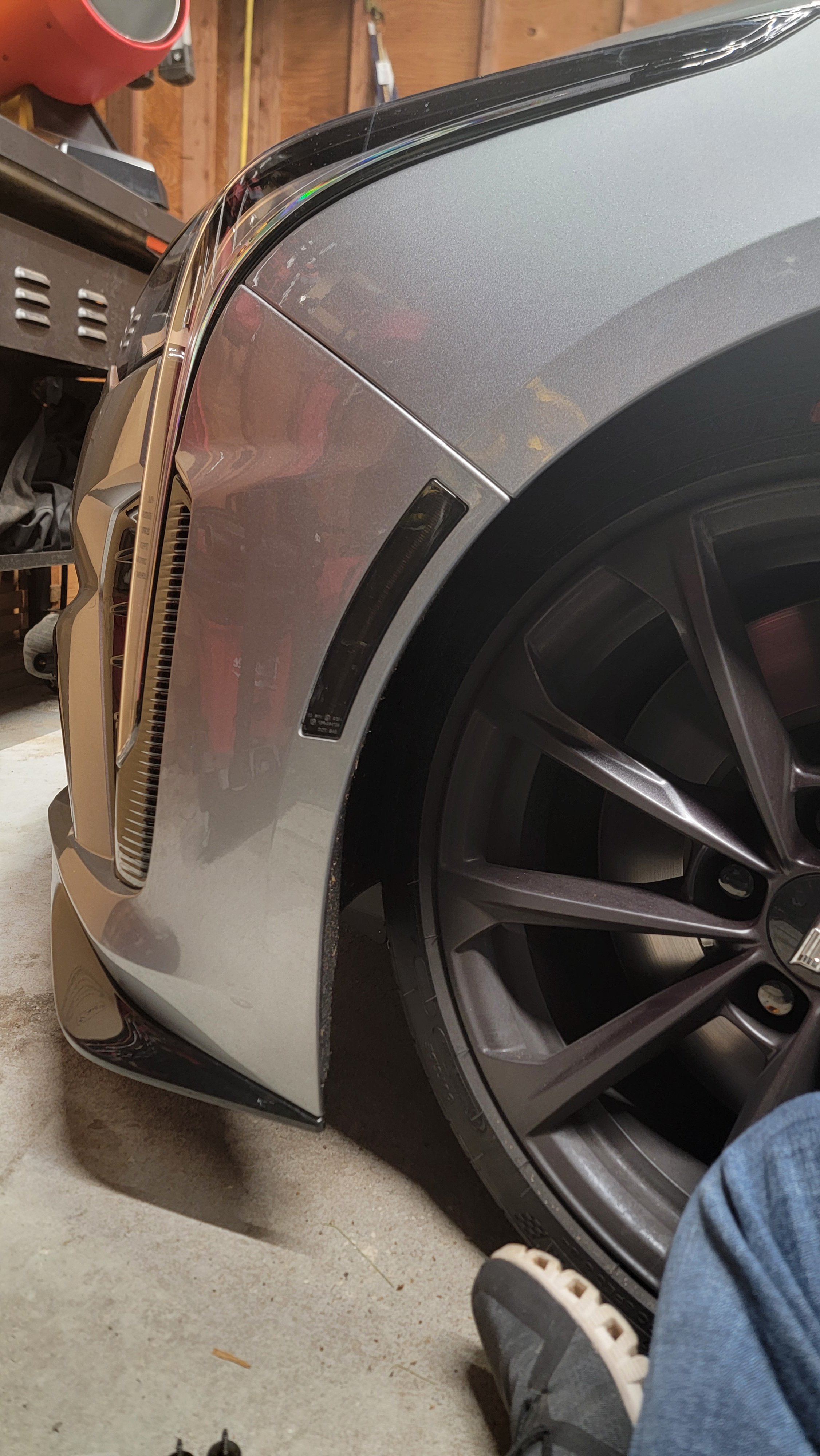

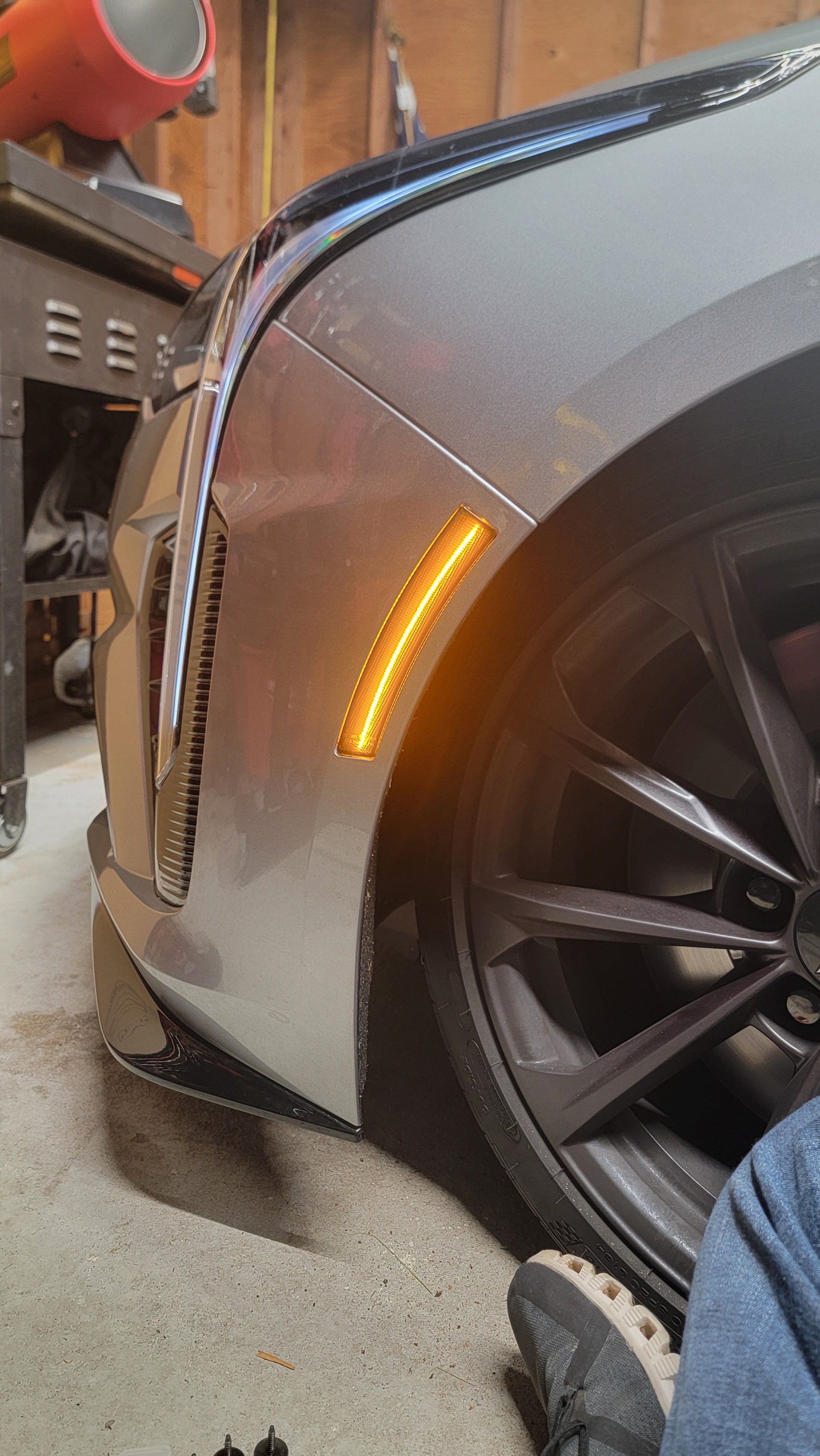

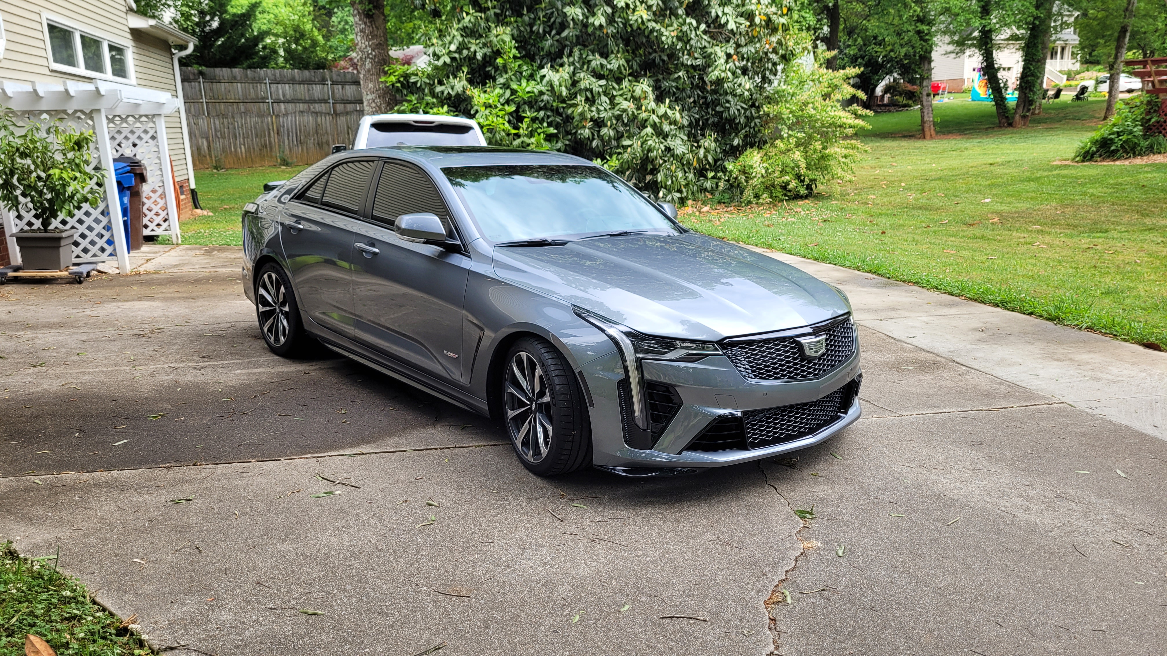

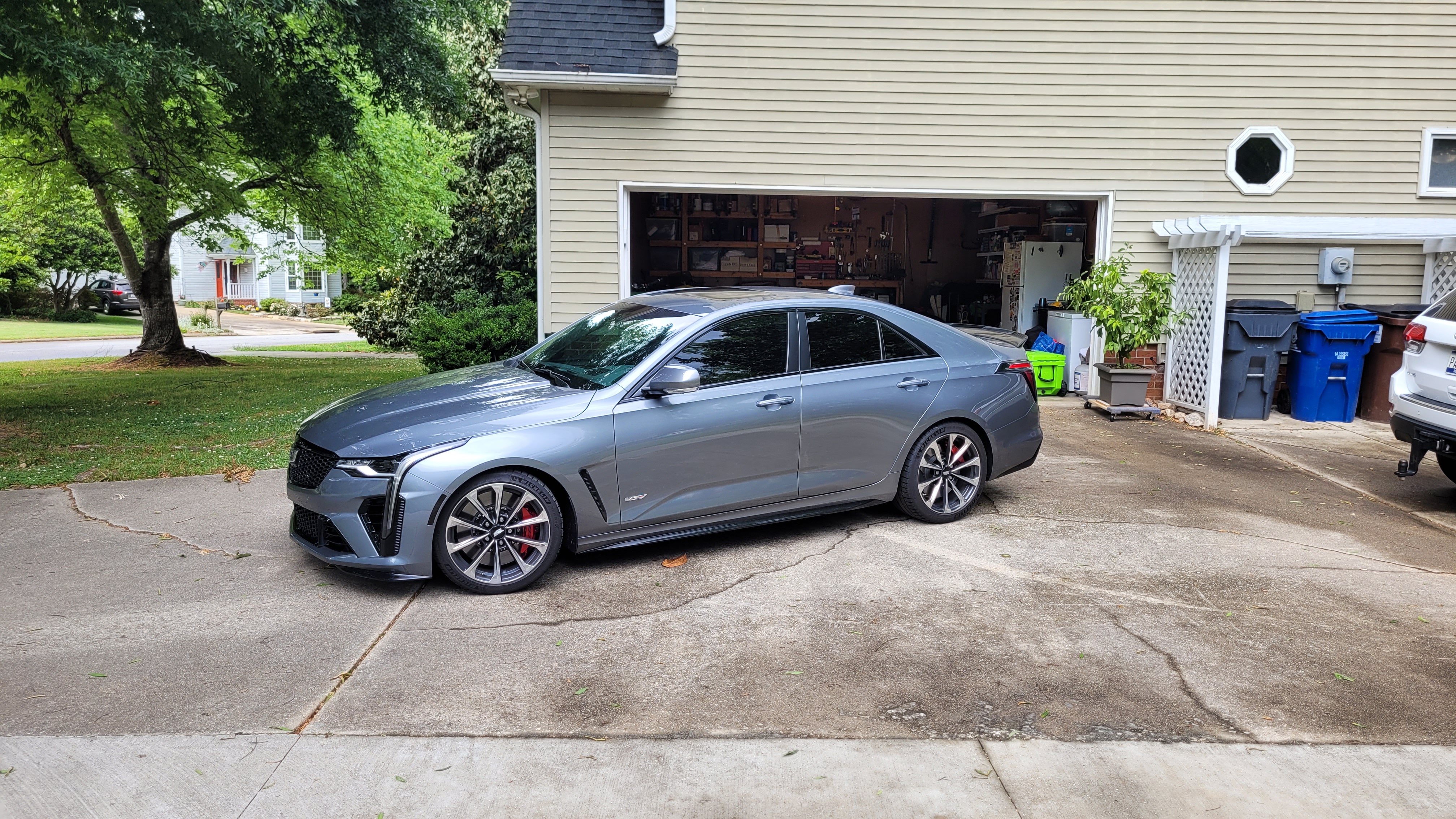

Got time to tint mine this afternoon and I used the Vvivid Air-Tint in Dark Black.
@strohw This walkthrough was great A couple quick notes for the next person using them:
- The screw that holds the bumper to the fender has a hex head. I used a 7mm socket to remove it.
- The screw that holds the light onto the bumper (Step 6) is the same size torx bit as the fender well screws, but it is a different sized (shorter) screw.
- Your directions on removing the wiring harness weren't fuzzy at all. Use a flathead screw driver to push the red locking mechanism downwards to the ground, then once its retracted, use the same screw driver to lift up the black tab and remove the light. It comes out rather easy.
Thanks again for the photos! I'll contribute by showing some of my finished product. Looks awesome with the Monochrome emblems.
