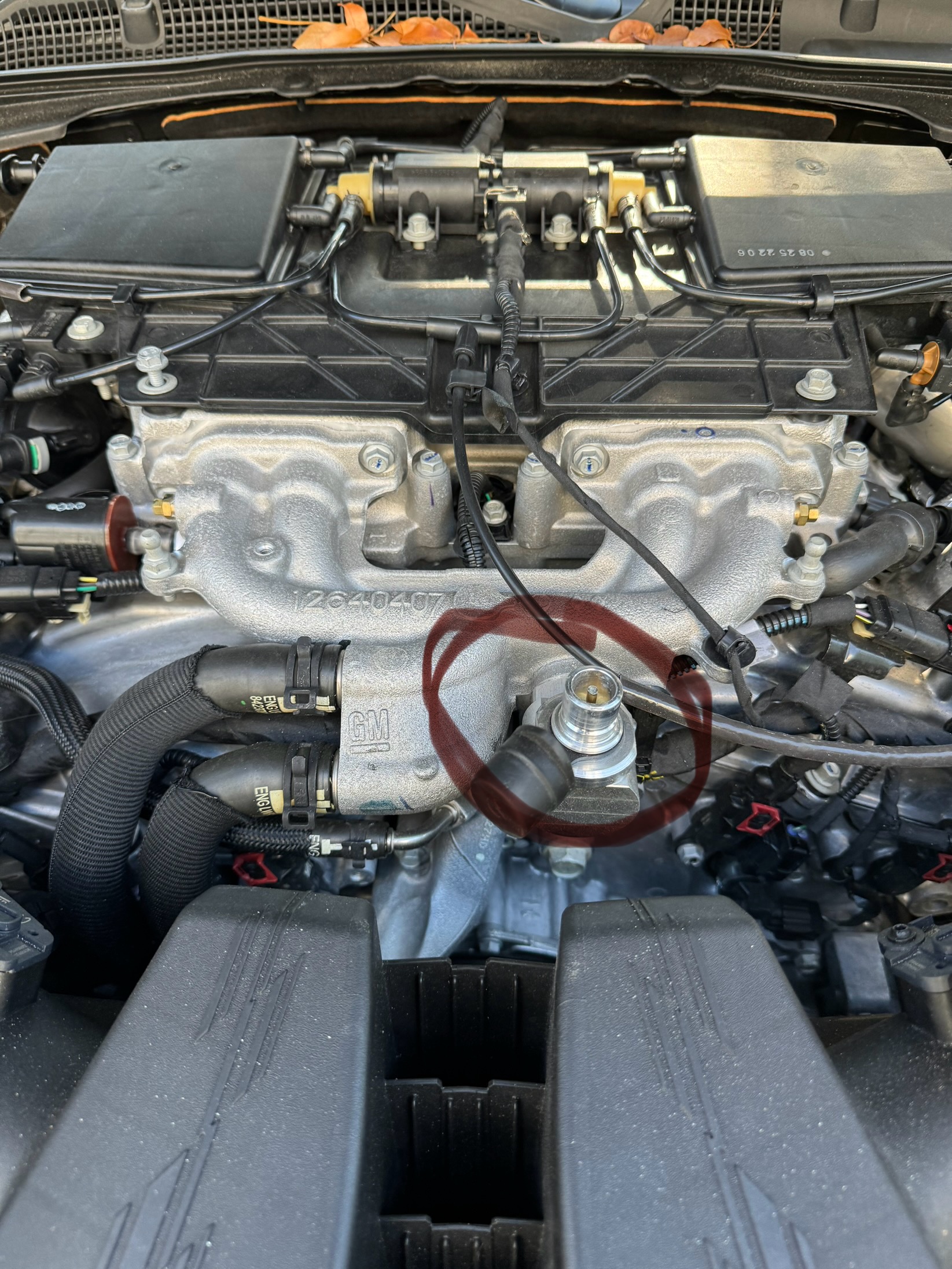

Do you know if this supposed to be loose? I noticed that this thing swivels.
