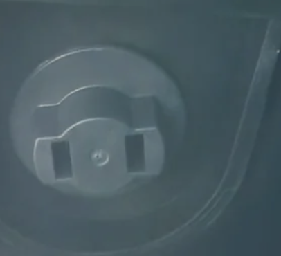

Sorry if this has been discussed before, just posting it here for posterity. I've been dealing with an insanely annoying rattle from the passenger side / glovebox area for a few months, reaching over while driving pushing on things, opening and closing the glovebox, anything I could think of to locate the rattle... no dice.
Finally my dumb ass Googled "ct4 v blackwing passenger side rattle", lo and behold this was the second result:
Literally a ten second fix. For those that don't have Reddit, there's a "lock" under the glovebox on the right side - I presume for the cabin air filter. It was unlocked and that was what created all the noise - just turned it 90 degrees and the sound went away. Whew.

Yeah, I saw this on reddit and gave it a shot. Unless mine quickly un-tightened itself, this didn't fix whatever mine was/ is.
