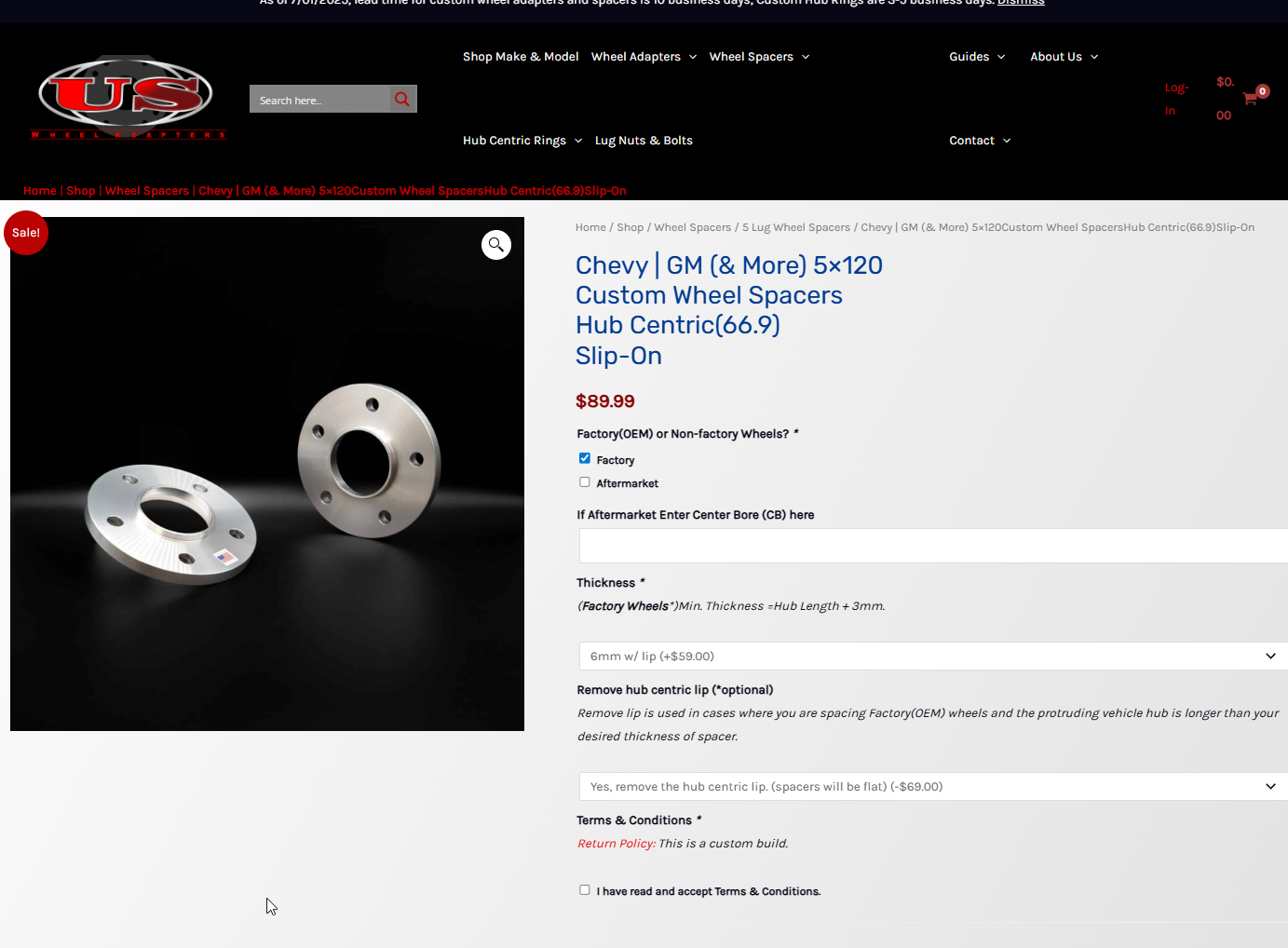

Another question: for OE wheels do the spacers need the raised bore rim, or can they be completely flat? I'm thinking 6mm spacers...
I used flat. But I also used concentric rings on the wheels. Technically, if you have a spacer with a lip that matches the wheel bore, you wouldn't need the rings.

Studs are the same as 6th Gen Camaro. Can't get better than ARP.
5-6mm is about max you want to run. There are hubcentric slip on spacers in Ebay cheap.
But I've also used Ebay 15mm bolt on hubcentric spacers with no issue on my old 4BW.
