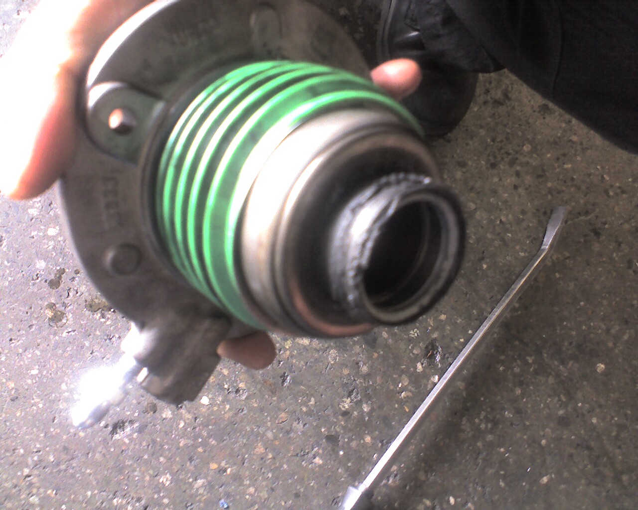

That Clutch Stuck to Floor thing is something I dealt with, in my V1 Days.
It affected all LS of that era.
I though GM resolved that issue, when they started using Twin Disk Clutches on the C6 ZR1.
An aftermarket [ACT] Twin Disk solved the issue on my V1.
BlackWings are Twin Disk, but the stronger Pressure Plate, on the CT5 BW, probably isn't helping the Slave any.
You might need to add a Remote Bleeder Line, along with that Better Fluid.
Keep us posted on this as it is a bit concerning.

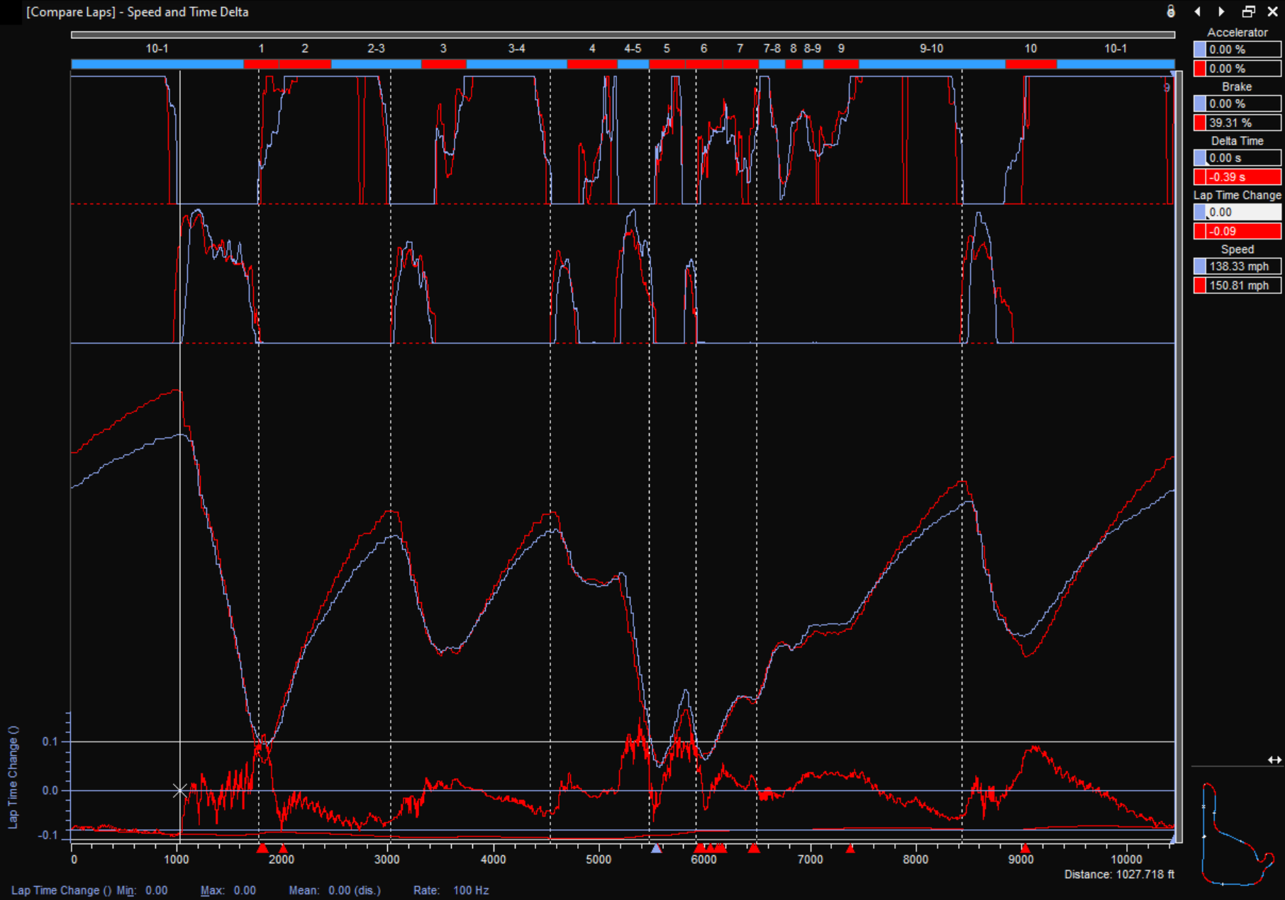

so they were both comparable... I think I saw you get a 1:21:51
I bet once I get the track alignment done a little more time the 5 BW will be faster. The 4S tires on the BW are definitely better than the 4S on the C8. I'll try to do a data dive this weekend.
Actually it is going to be significantly faster than the C8. I just took a quick look at the data and the speeds on the straights are significantly higher for the 5BW (red) over the C8 (blue). Third set of traces in this chart is speed.

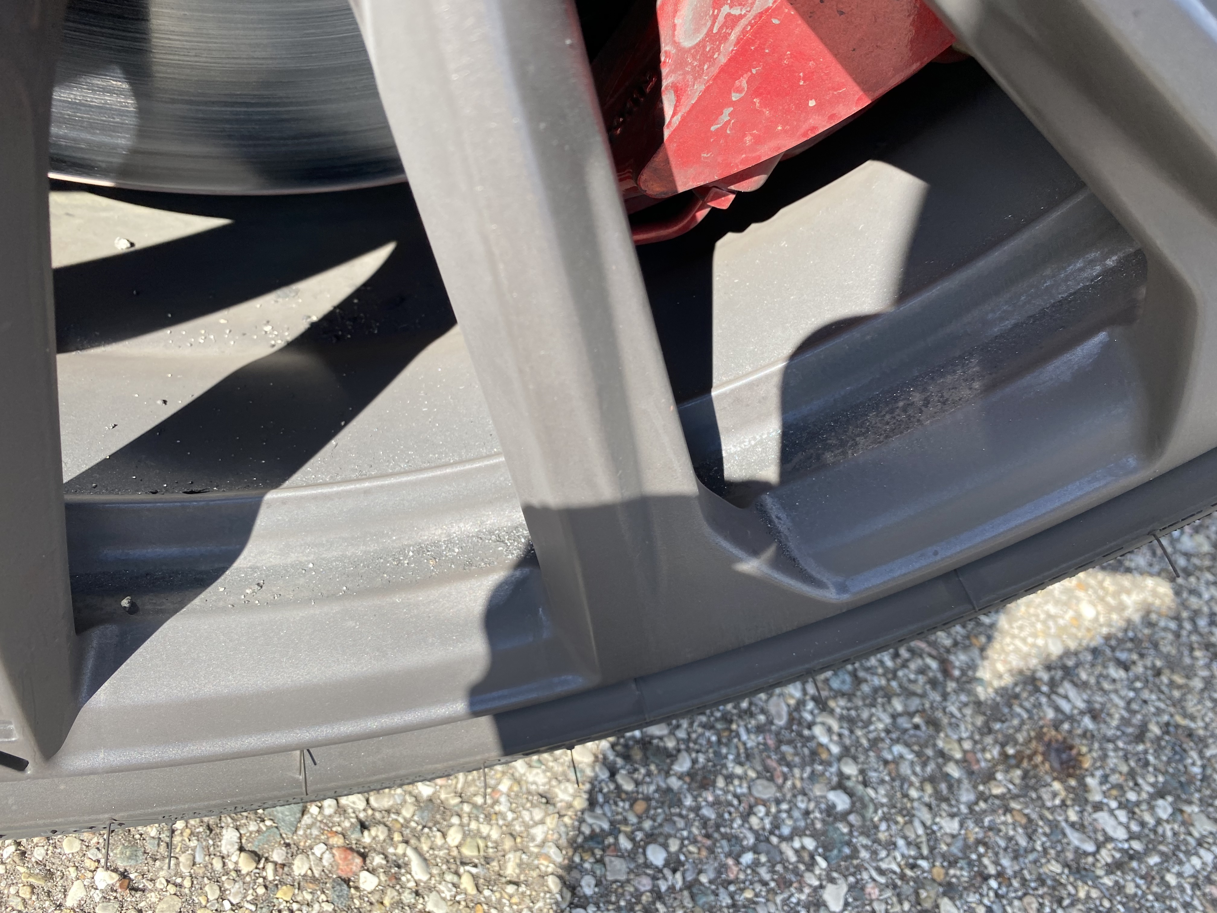

Your clutch fluid is same as brake fluid, share reservoir. You need to use high temp fluid as per owners manual, both your brakes and clutch. Congrats on track day!!! Here is my ct4 track dust.
