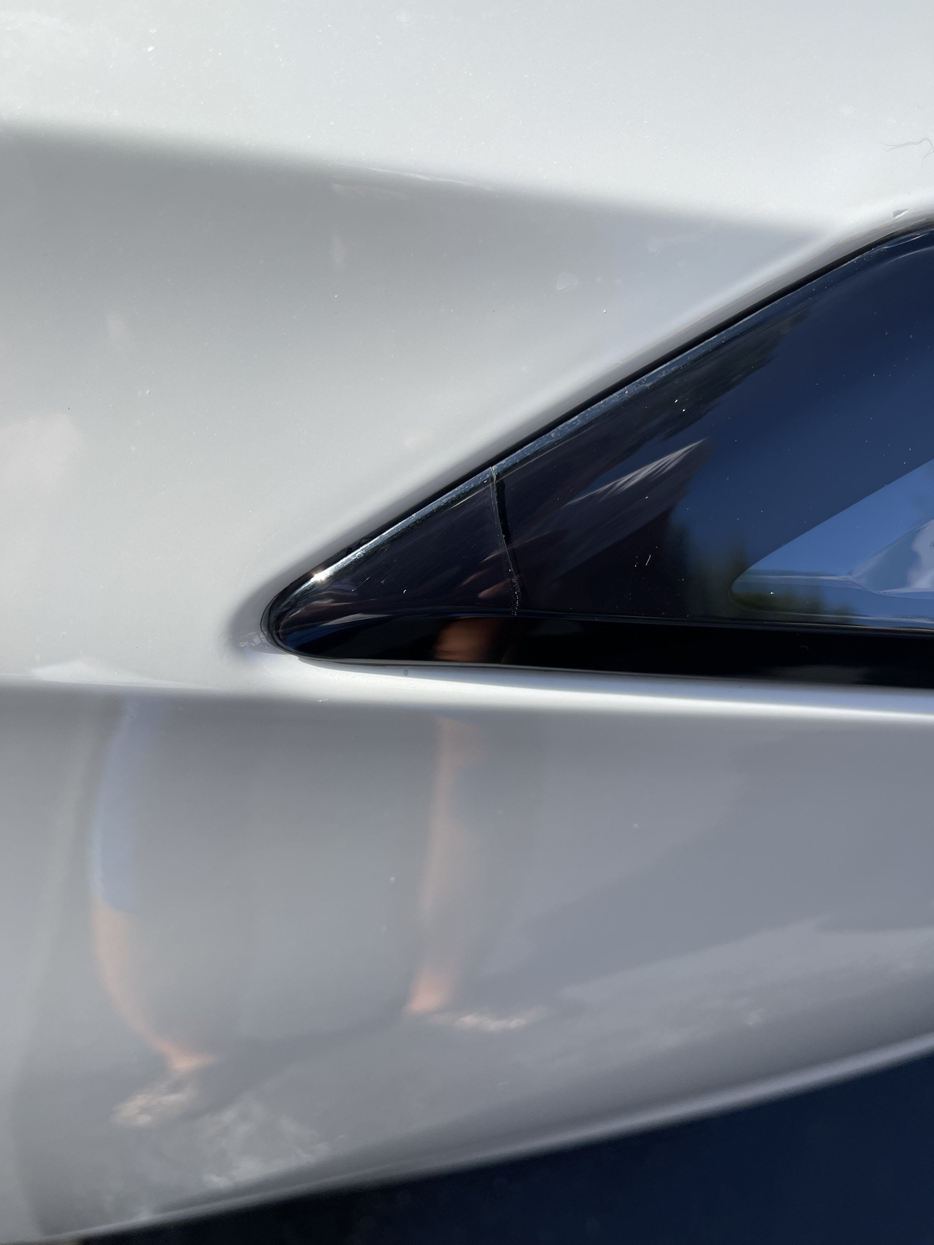

Has anyone done a DIY tail light replacement? If so, easy? Any helpful hints? Mine cracked and they wouldn’t warranty it. Thankfully, it was pretty inexpensive. TIA

I would argue that this might be a factory defect in the tail lights. There have been several other forum members who had that same crack. Might want to push the dealership a bit more on a warranty for the part.
I already ordered and received the replacement. I was disappointed in them not covering it under warranty.

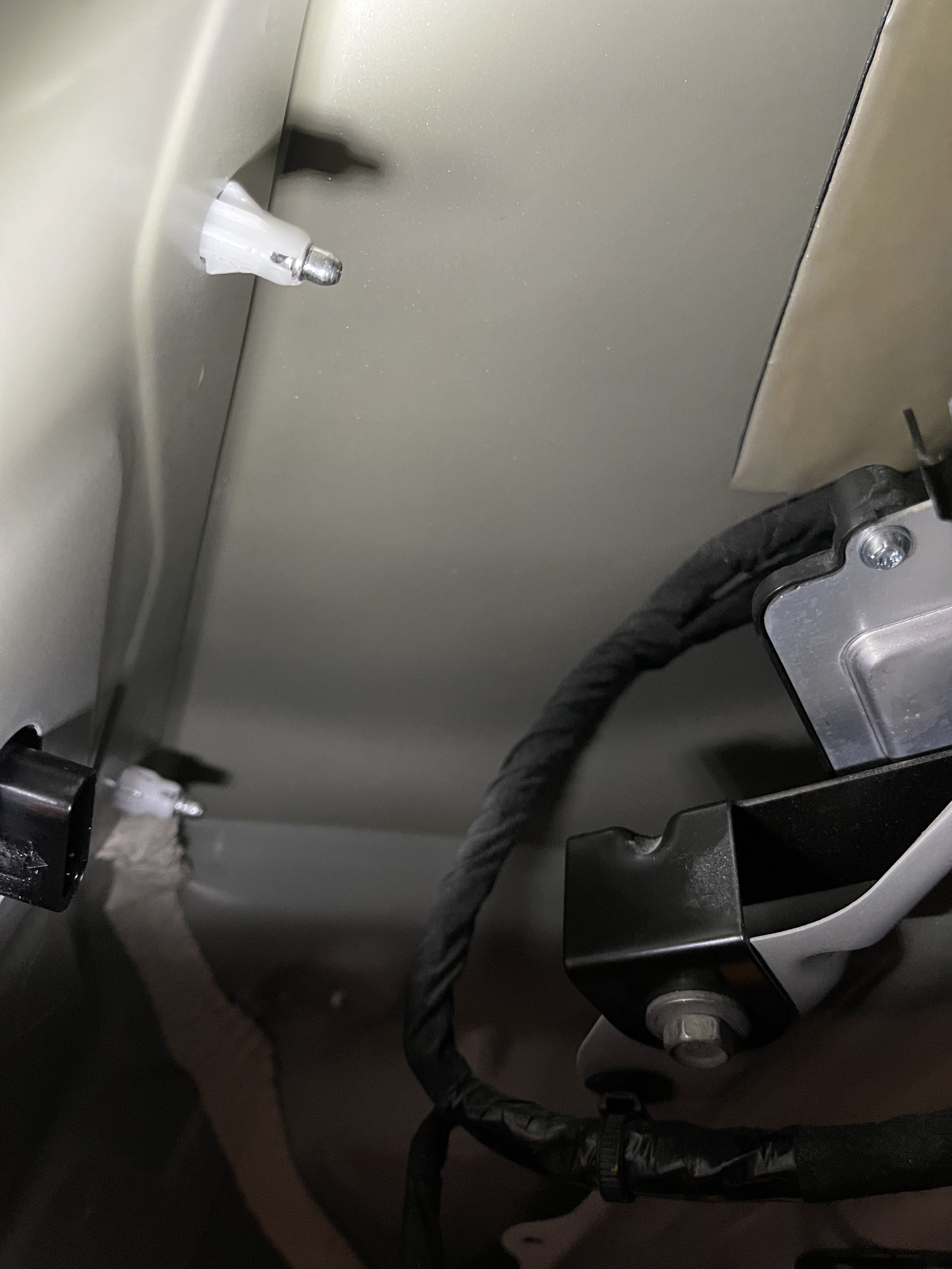

What kind of a tool do you use to remove those white plastic nuts?

I don't believe they are meant to be removed. The metal pin pops into them and the insert stays in place (in theory). I'm guessing the tail lamp assy has those pins on it?
Yes, it does. They appear threaded. It appears that the bumper needs to be either fully or at least partially removed as well.
I just looked up info on tail lamp replacement and they say to remove the bumper cover to get to the two bolts on the inside of the lamp. They also say to replace the plastic anchors, so it might be that they won't come out without destruction.

Did you try turning the plastic pieces?
I couldn’t get any conventional tool to work on them. I didn’t resort to pliers or, vice grips. Per @shbox’s post, it seems that they are single use and sacrificial leading me to believe they’re press on and what looks like threads on the studs are for grip.
Do they squeeze together and then pull/push through?
Looks like the same concept as the outer stud for the rear spoiler. I got a small screwdriver in to open the small end enough to work out the stud, but one plastic insert broke. In the end I didn't re-use them anyway. I think it's the factory way of sticking a stud into a hard to access hole for a nut. If it's a round hole, you might unscrew it. The spoiler plastic nut is oval and won't turn.

For maintenance, perhaps, but not for assembly (which is their concern when building the car). Since you can get to the back of them, it might be possible to get them to release with some ingenuity.

As you know, you still have to remove the bumper to access 2 other bolts. There are 5 total holding it in place.
