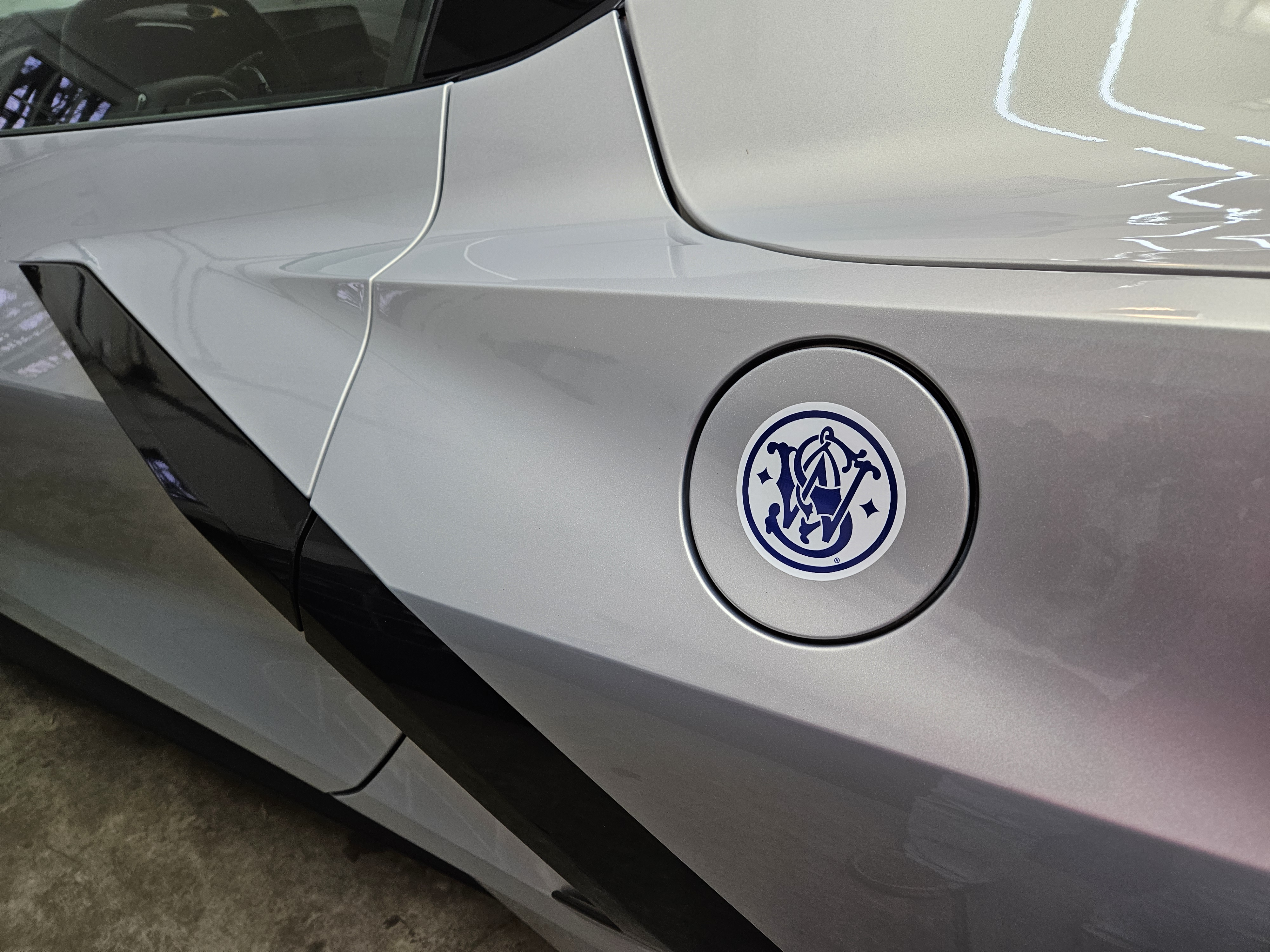

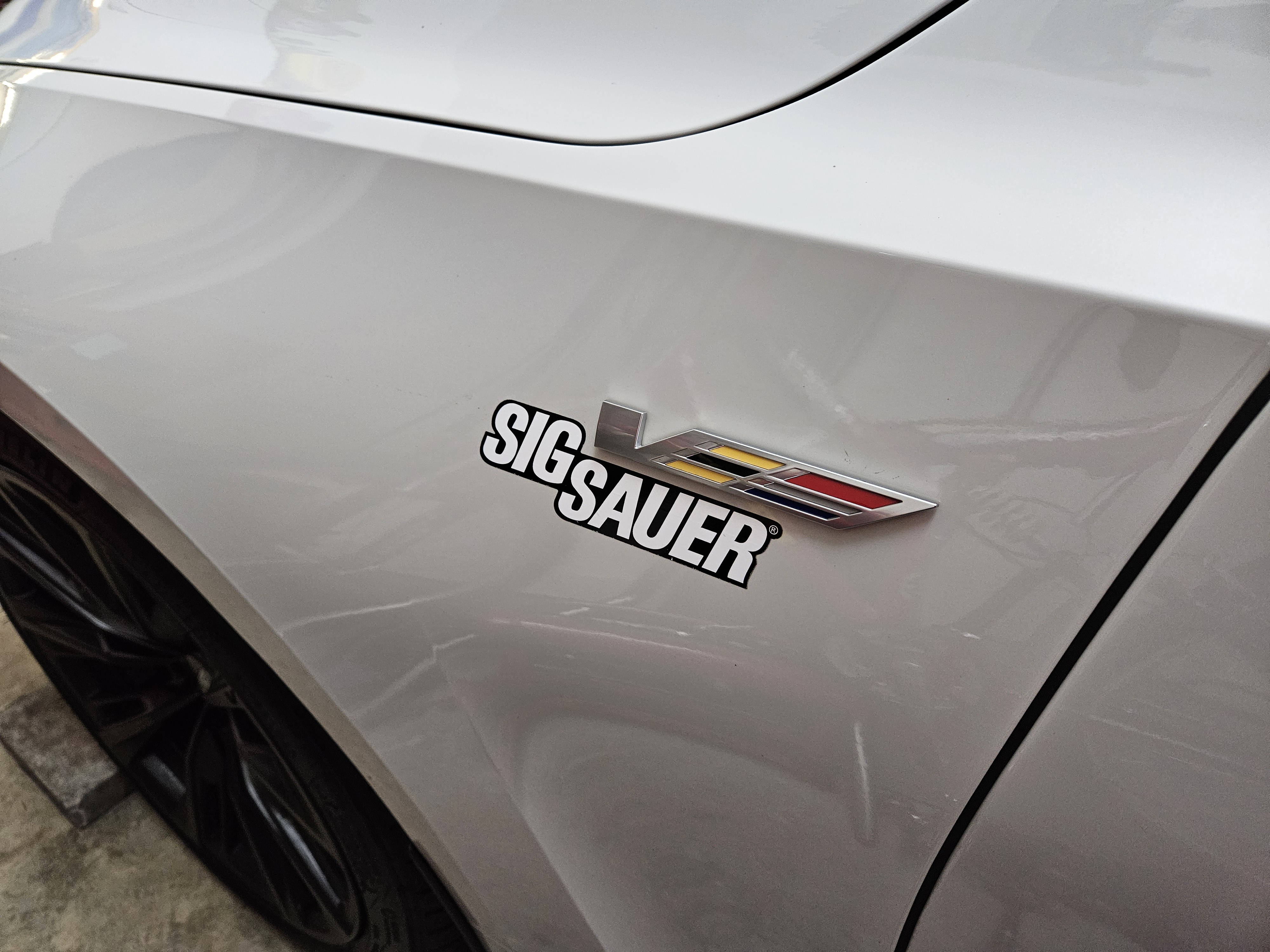

Google Smith & Wesson security systems.

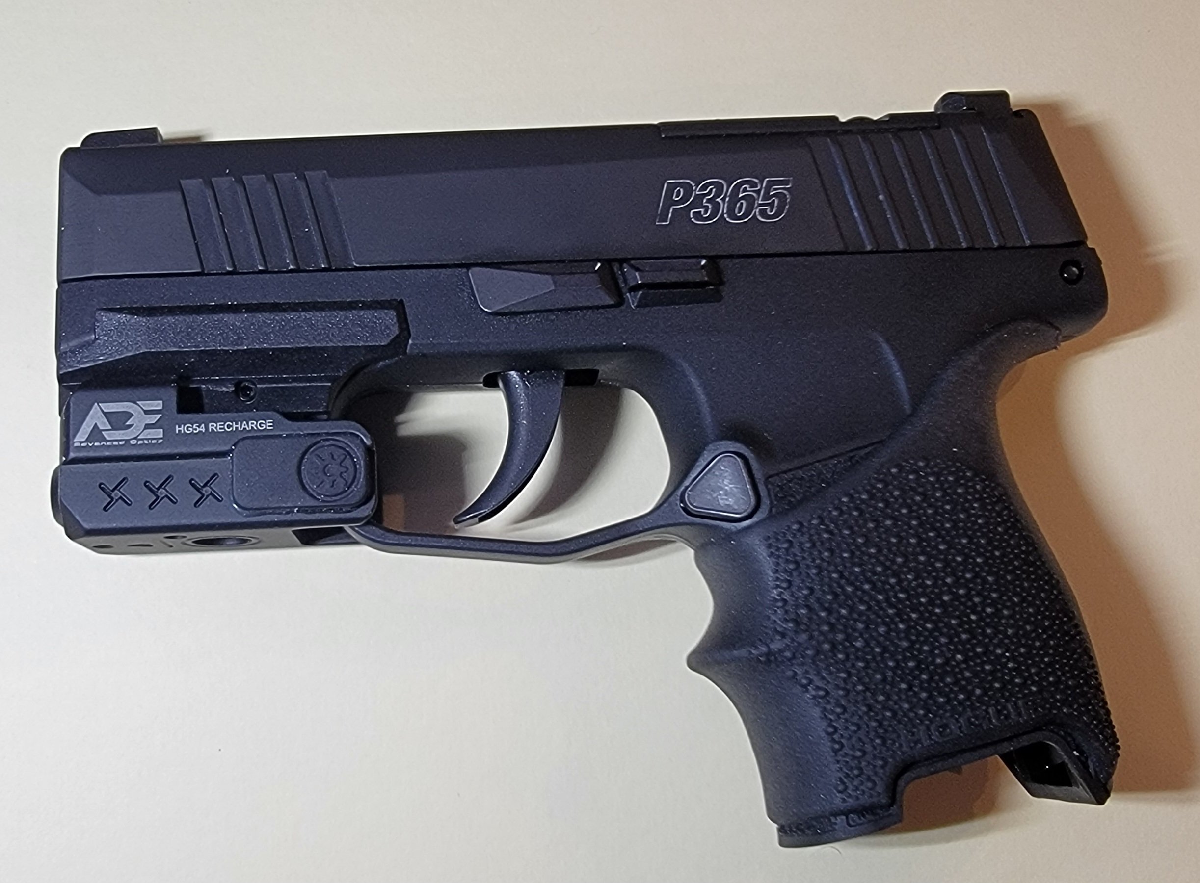

Clearly advertised are my extra layers of security on 5BW & C8:
