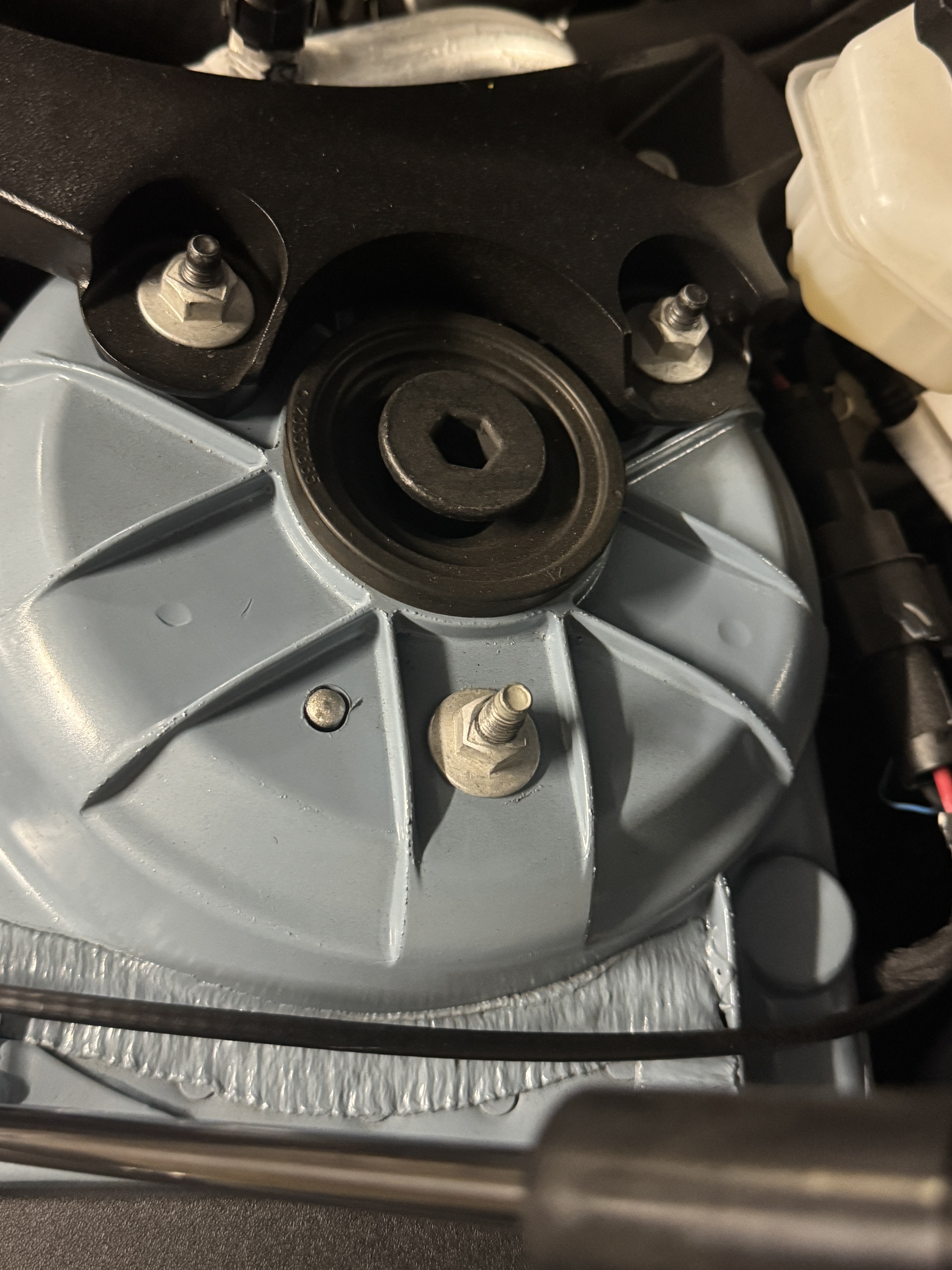

Well I looked and you can see on top of the shock tower, two divots in the cap that look like they can be drilled out for something, plus a metal plug of sorts poking up through a divot that’s drilled out.

To get the track alignment (CT4 only) with more camber, you need to punch out that pin visible in the strut tower. That allows the strut to slide. It's a simplified version of what you would get with an aftermarket camber plate.
This is all detailed in the manual if the tech bothers to read it. It's not particularly difficult. I'm sorry you had a problem with the dealership, so many of us also have terrible stories with dealers who have no experience with these cars and don't even bother to read the manual. The car is great but the dealership aspect is a huge challenge.
You definitely want the extra camber from punching out the pin. Otherwise the car will murder the outside of the front tires on track.
I think there are some old threads on this issue too.
So the pin gets punched out, what's next? Is the camber adjusted how? some sort of bolt or nut to adjust? Loosen the three nuts/bolts and move the strut inward till you get what you want then re-tighten them?
Moving things on top gets you enough negative camber that, with the normal adjustment down below, you can get to the track alignment.
