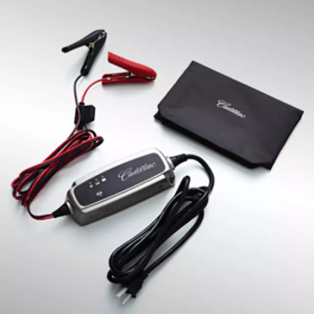

I use Battery tenders on my other car and tractor but my Cadillac came with a Cadillac charger. I have used it occasionally to charge the battery but have not left it connected continuously like I do the Battery Tenders. Does anyone use one of these? Any idea if it is safe to just leave connected or should I just get another Battery Tender for the winter? 5d9473c09df7dfe8e5faf2d4e8c4b5bd.webp

I use Battery tenders on my other car and tractor but my Cadillac came with a Cadillac charger. I have used it occasionally to charge the battery but have not left it connected continuously like I do the Battery Tenders. Does anyone use one of these? Any idea if it is safe to just leave connected or should I just get another Battery Tender for the winter?View attachment 28256
That is a battery tender, its just branded. It is safe to leave on the car. I have one along with two others branded for Corvette's.
