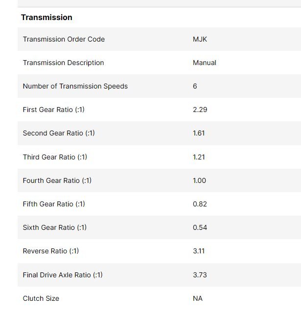

If you've got some time to kill, I'd read up on gear ratios. The shorter the gear ratio (both final: ((rear diff)) and specific gear), the more acceleration. Revs will always climb faster in lower gears given the same throttle input. Here's a screenshot of the ratios from Car and Driver. You'll see that 6th has a very tall 0.54 ratio. For us CT4 BW guys, we have slightly shorter 6th at 0.63. Here in Texas, we're all going 80-90 mph so I'm typically already at 2400+ rpm even in 6th. CT5 BW guys have the benefit of a shit ton more power and torque though lol.
And with your car being supercharged, your powerband is directly tied to rpm's vs turbos which once they reach sufficient spool from the exhaust, we have the torque we need, which typically comes much earlier in the rev range.

The wild drop in RPM between 5th and 6th gear is irritating. Redline in 5th gear is ~162mph; upshifting to 6th drops the RPM to around 4500 and completely kills acceleration. The drop in RPM from 5th to 6th is so huge, the transmission feels like a 7-speed, where 6th gear is missing. To be fair, I also don't like the stupid-tall 6th gear during normal street driving, either. There are numerous times where if I upshift to 6th gear, the engine almost feels like it's lugging, but if I downshift to 5th, the RPM feels too high.
From what I've seen, this results in the automatic CT5V's having a higher top speed than the manuals. The auto's have more gears up top and can go about 205 mph. The manuals, stuck in that overdrive 6th, can only hit about 191-192 mph...
That's an extreme situation though. For everyday driving on the highway, I'm happy with the Blackwing 6MT's gearing. I use 6th when cruising at 80+ mph.
The amount of time I spend at 185+mph is none. Maybe I'd change out the 6th gear if I was planning on running down the Mulsanne straight (pre-chicanes) on a regular basis.
As I recall, the Porsche GT4's had some super-long gears and people were actually changing them out pretty regularly... Maybe there's a GT4 guy on here than knows about that.
